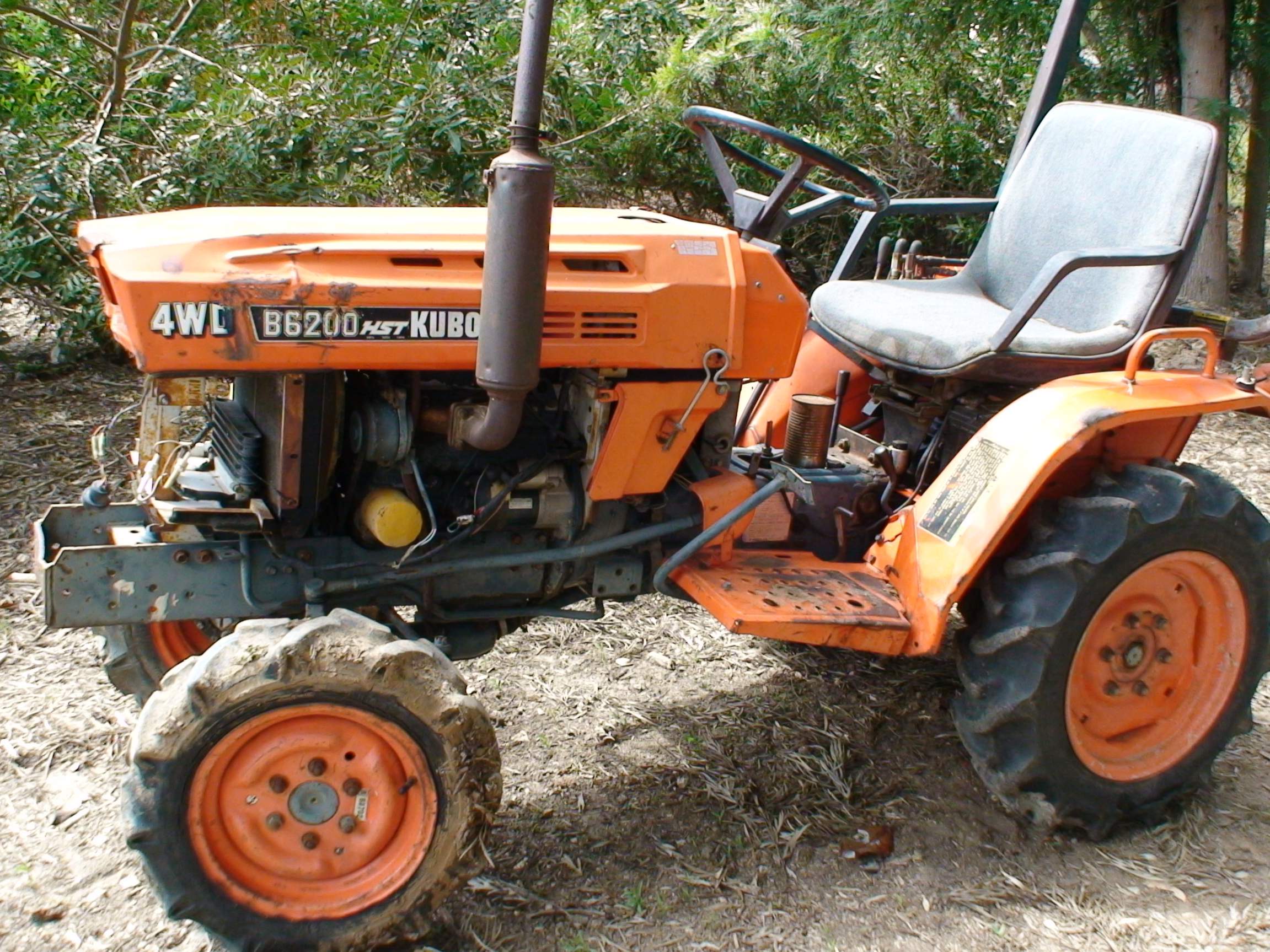

Here's a picture of my new prized 6200.

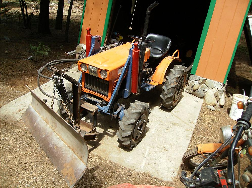

Also a picture of a someone else's 6100 tractor with hydraulic ram. My dream is to attempt something like this in order to attach a front bucket for the boys. Does anyone have any idea of costs involved with adding hydraulics for a future FEL? I have a wire feed welder and grinder etc.
Many thanks again Gentlemen.
