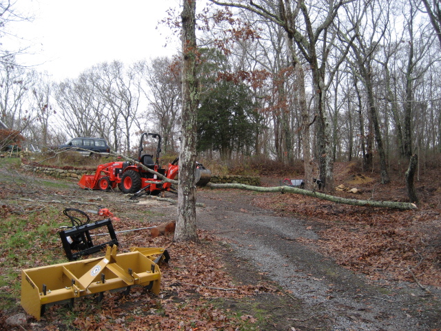

Here are some pictures I had on hand. You can't really see the slope, but it's there, probably 15 degrees. You can see rocks and general forest - I bush hog before starting cutting, makes a huge difference.
Second picture is of the BH 80x lifting a pretty big oak tree. I was impressed and pleased - made cutting it up a lot easier.
