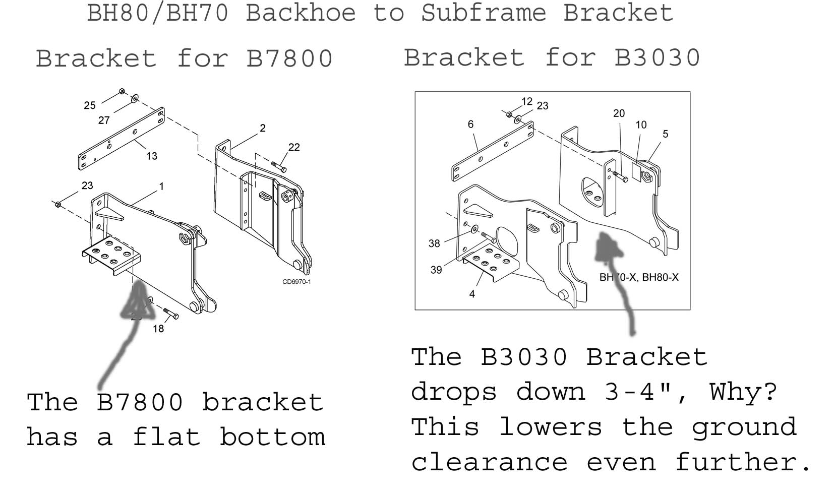

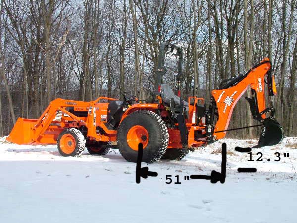

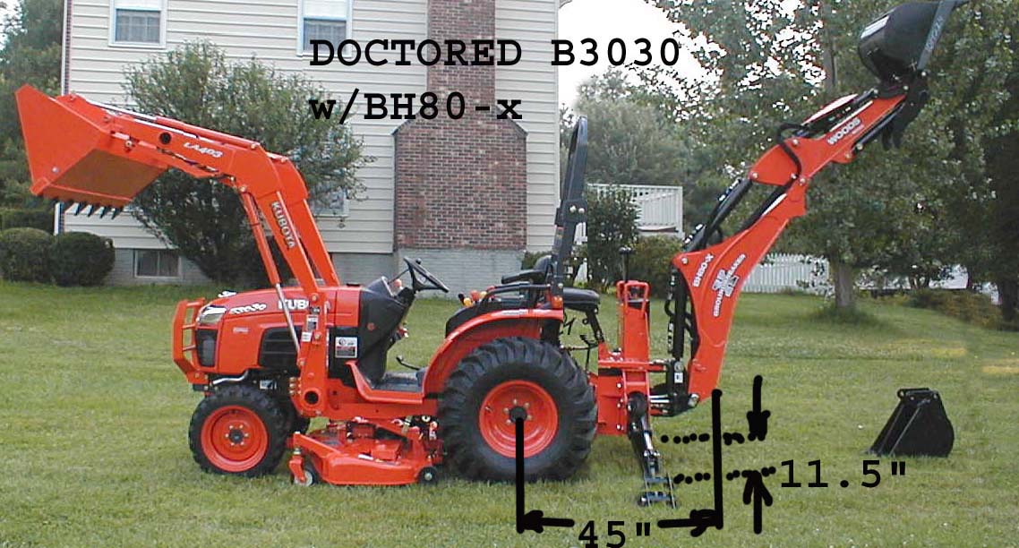

Here I go again...
If I'm going to spend a mini fortune for a Hoe, I better get the best Hoe for the money.
To recap, I've been debating very strongly between buying a BH75 (kubota) and a BH80-x (woods) backhoe for a B3030.
The BH75 sits very close to the B3030 plus has roughly 12" of clearance.
The BH80-x on a B3030 has about 7" of clearance plus it stick out a L O T...
What bothered me for a little while is the fact that the BH80/BH70-x sits very nicelly on a B7800 (the b7800 is very similar to the b3030) and it has a lot of ground clearance.
By comparing the 2 Backhoe brackets that connect the subframe to the actual backhoe, I found that the backhoe bracket for the B3030 drops down about 3" and it sticks out further back by an additional 3".
I then contacted one of the engineers at woods equipment and we discussed this issue for about 1hour.
After revieweing multiple Engineering photos, and discussing with the engineer why woods had dropped the hoe by so much, he came to the conclusion that the reason why Woods dropped and extended the hoe was to clear a piece of sheet metal which buttons up between the rear fenders of the B3030 (not there on the B7800)
The last comment I have is the possibility of cutting the backhoe mounting bracket and removing a 9" piece and rewelding the bracket. This would bring the hoe tighter into the tractor and it would raise it by4-5".
I used Photoshop to edit the picture and do the cutting on paper. I then used Orthographic scaling to come up with the new approximate dimensions.
Do you guys think it would be way too much work to cut, remove 9" of bracket and weld the 2 remaining pieces?
I think the steel is roughly 3/8" thick
As usual any comment is welcommed.
Thanks,
Rick
