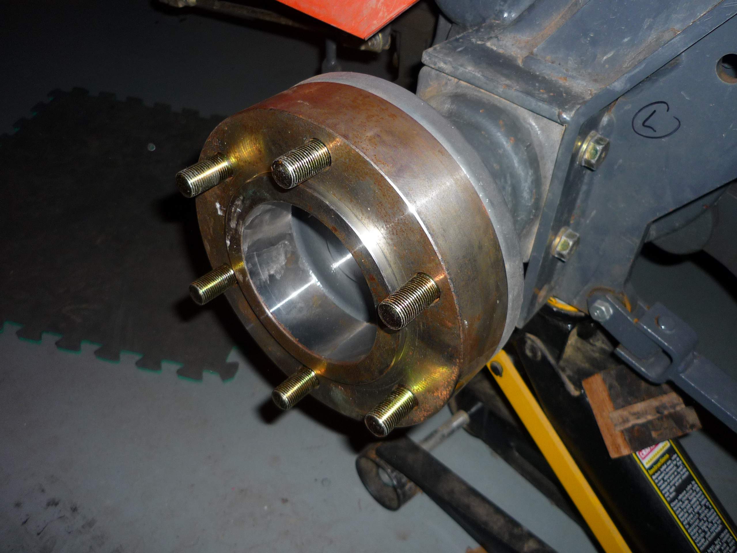

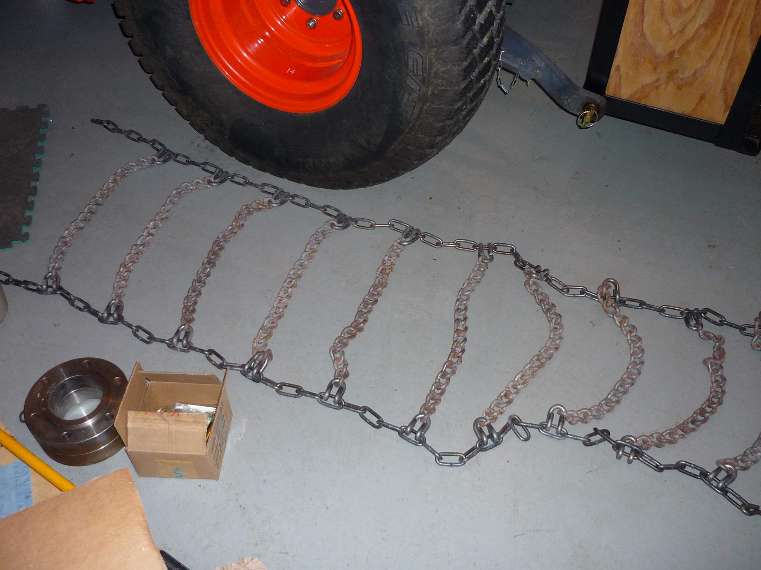

I have a B3030 and I知 considering putting tire chains on it, has anyone successfully put rear chains on R4 tires, does it need wheel spacers, if so what size, what type of chain are you using? I値l be on black top all the time.

I have both F & R chains for my B3350, which is similar.
I have R4 tires and my chains are two-link ladder style. Rear wheel spacers are mandatory due to inadequate fender clearance. I have Kubota 1 3/8" rear spacers.
Twist-link ladder chains are not damaging to asphalt given common sense.

They also offer,or did offer,rear fender extensions.
Might be nice if running wheel spacers.

I found an ex-Kubota dealer selling stuff out of his barn, and got some 11/2' Kubota spacers and some ladder chains, which required modificatons but then worked fine with my L3400 with turf tires. The spacers help with stability, as well. Unless they are too small, chains can be shortened and otherwise modified to fit. Connecting links are not hardened, typically.
