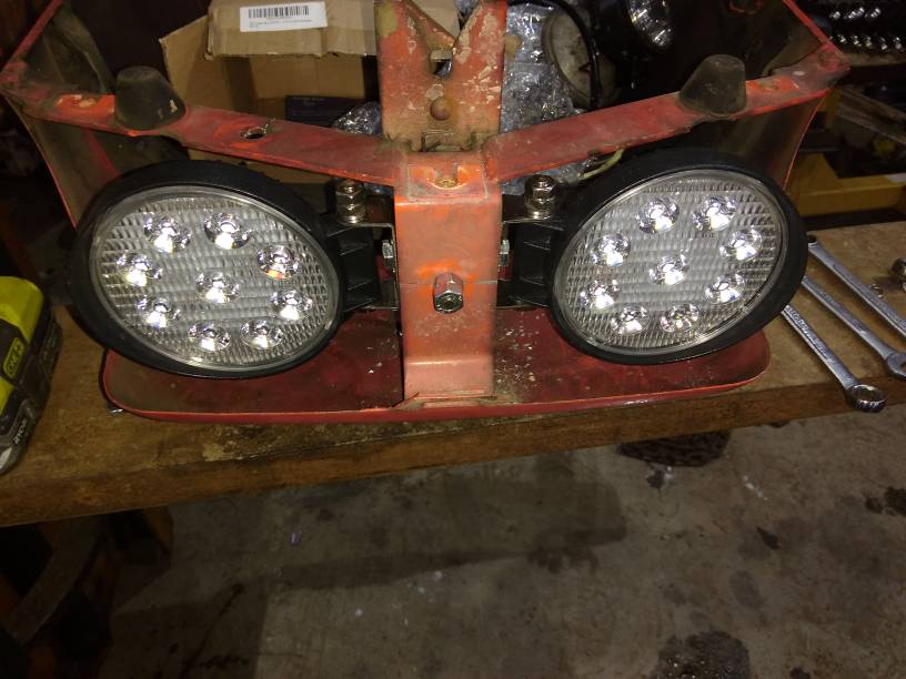

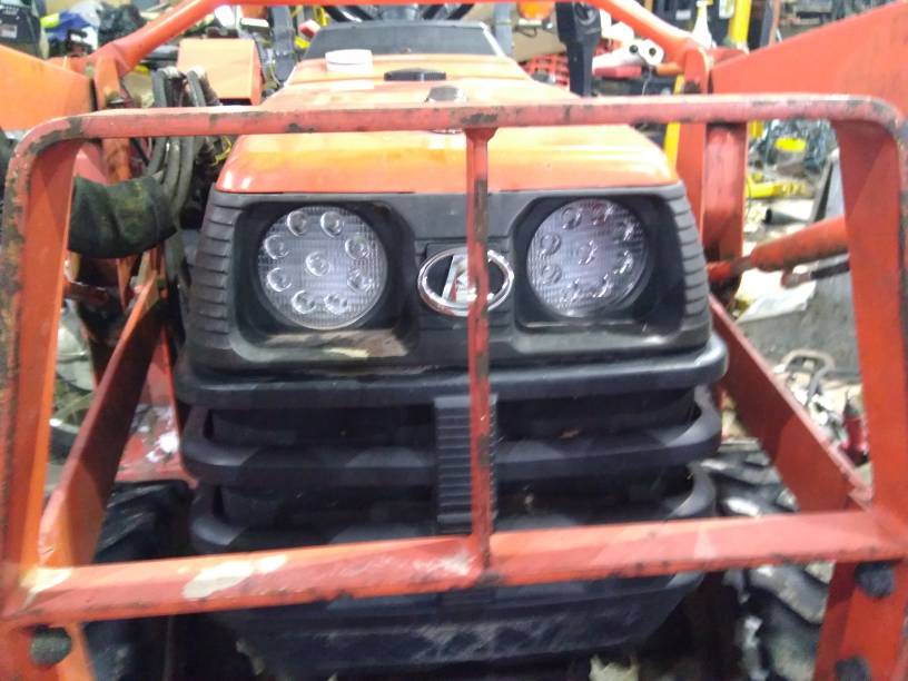

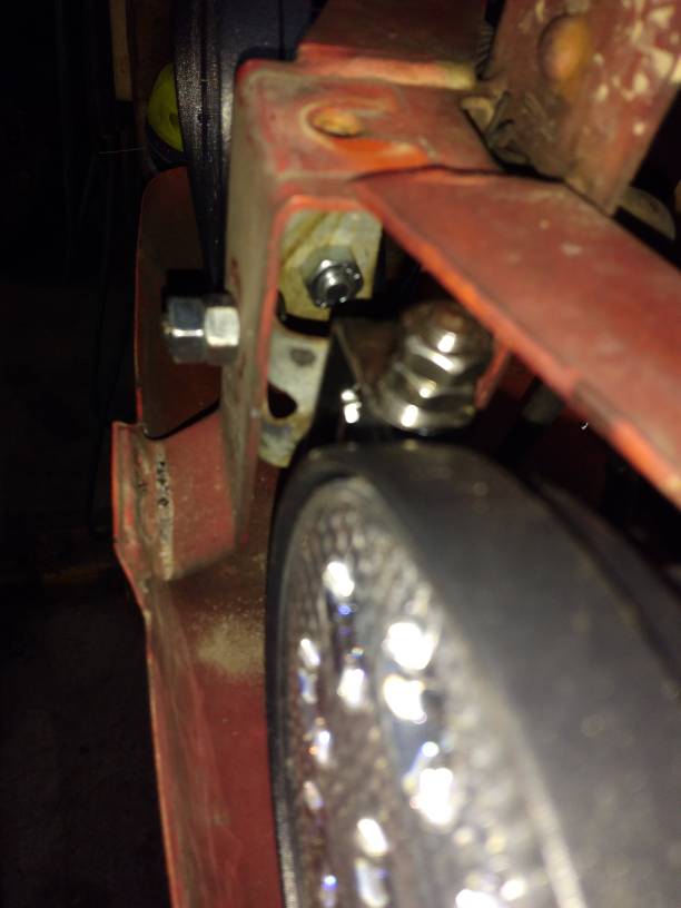

I have a pair of LED bulbs in the headlights of our L3830. They throw a lot more light (but not as much as the floodlights that I mounted just in front of the operator station).
On our B7500, it had bulbs sort of like that (I think), but the round fixtures were all sooty and messy, so I replaced the whole fixture with LED floodlights.
Aaron Z
/ B3000/B3030 LED Headlight BUlb ? #10
The finished B7500 headlight replacement:
The bracket:
The hood upside down before the cowl went back on:
Aaron Z

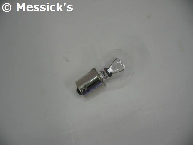

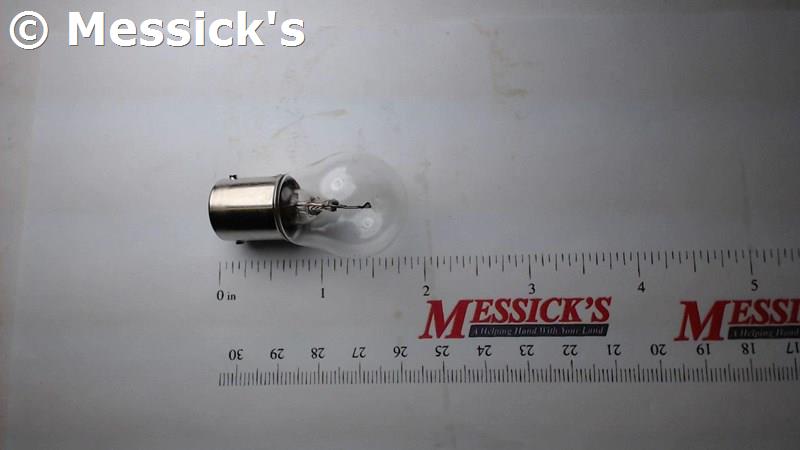

I am stuck not being able to get to my camp and my tractor for a while so I can't pull my bulb to compare. But from the brief searching I've done, the 1073 bulb appears to be the same configuration as an automotive 1156 bulb.
From Messick's parts site this is the bulb from the 2650
From the same site this is the bulb from the B3000
Don't know if this will help you in your search. Hope it does.

Thanks GRTkub.
That is a picture of pretty much, what I have.
I have done a search for bulb #1073 LED Replacement and gotten some results back.
I believe the LED equivalent of the 1073, is an 1156, but not positive.... yet...….
Now I need to research to see what others have used successfully and if they liked the results.
