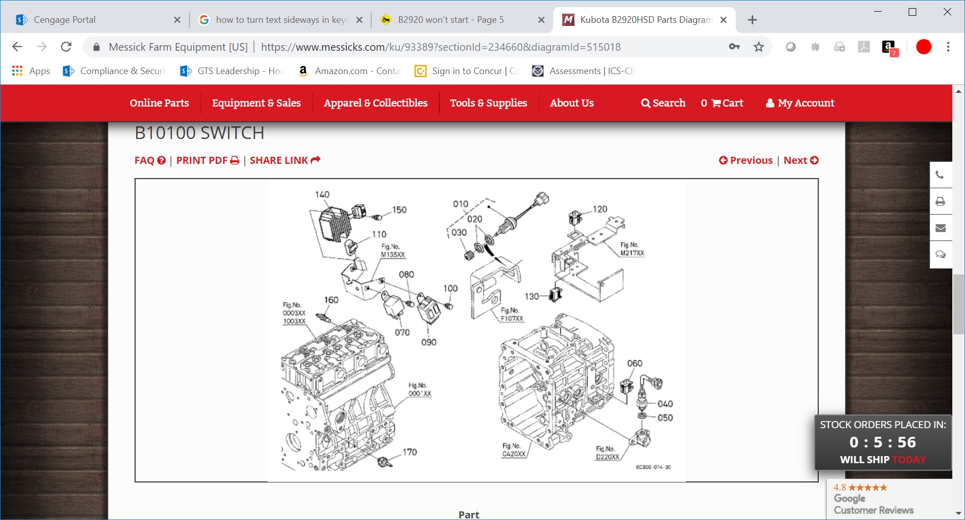

Can you guide me on where the starter relay is on this tractor?
   / B2920 won’t start #48
I never worked on a B2920 so I don't know its location. If you follow the BW and BR wires they should lead you to it. Maybe radios1 knows the location. sorry I kept calling the relay a solenoid. Your friend that is helping you should be able to find it and follow the test procedures.
   / B2920 won’t start #49
sorry. I can't find a picture or description of where it is, it's probably in the repair manual for your tractor, it's not even in the owners manual..
   / B2920 won’t start #50
My 3cents... Messicks or Kubota online, under parts, and then into parts breakdown diagrams for your tractor under 'Electrical System'. (Example, there are several on my "L" series) . I started at the top Electrical diagram and went thru each on the Electrical parts breakdowns, then in the lower half, scan the detail (or use Ctl-F in browser to search for text) and look for key words . I quickly grabbed a screen and pasted it below. In there are many elements and the locations. Sounds long but took 10mins. There were 4 or 5 links.
And... Messicks (or other.. pick you fav place... Not pushing one over the other.. it's just who I use). Their online service staff for parts will pull these up too and get you an answer. Even pulling in someone to help you get to the part you need. YMMV
