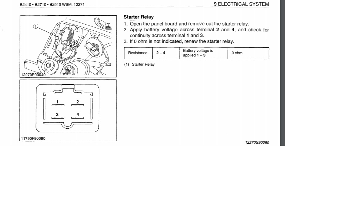

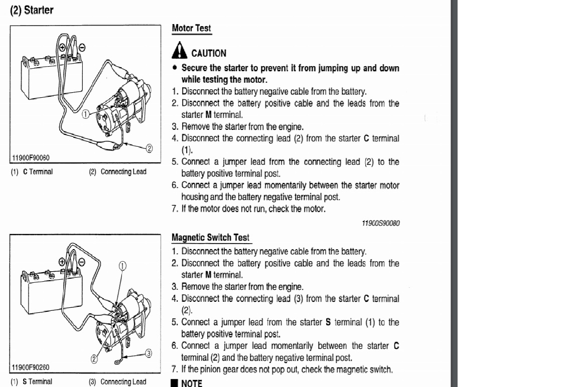

the manual for the B2910 WSM (service manual) from the link earlier have the details as follows : Maybe they are close enough to use on the 2920? Dunno.
Page 9.S8 and 9.s9 show the proper starter test and starter relay location and test.
   / B2920 won’t start #52
I guess the "panel board" is the dashboard? I see the wording is English with a poor translation from Japanese, sometimes that is way too confusing..

   / B2920 won’t start #55
relays and solenoids are 2 different things.. on his tractor, the starter relay activates the solenoid on the starter..
I didn't know if it had a solenoid or relay. Was talking solenoid before the diagram was posted and just kept thinking solenoid not noticing it had a relay until a little later.
   / B2920 won’t start #56
his tractor is a bit odd, usually a starter relay takes the load off the ignition switch, the ignition switch only needs to energize the coil on the relay, in this case, the starter relay acts only as the safety switch, the full current of the starter solenoid is supplied by the ignition switch, which goes through the relay, I'm surprised they did it this way!..
   / B2920 won’t start #57
My "L" does not have one. I wonder if it has something to do possibly w/ no firewall tween IGN and Tank? and providing a gas sealed relay? My ignition is separated from the innards by a hard wall. I could not tell on here and it's a SWAG anyway. Dunno. Hope this is finally down to failed component isolation. seems close.
