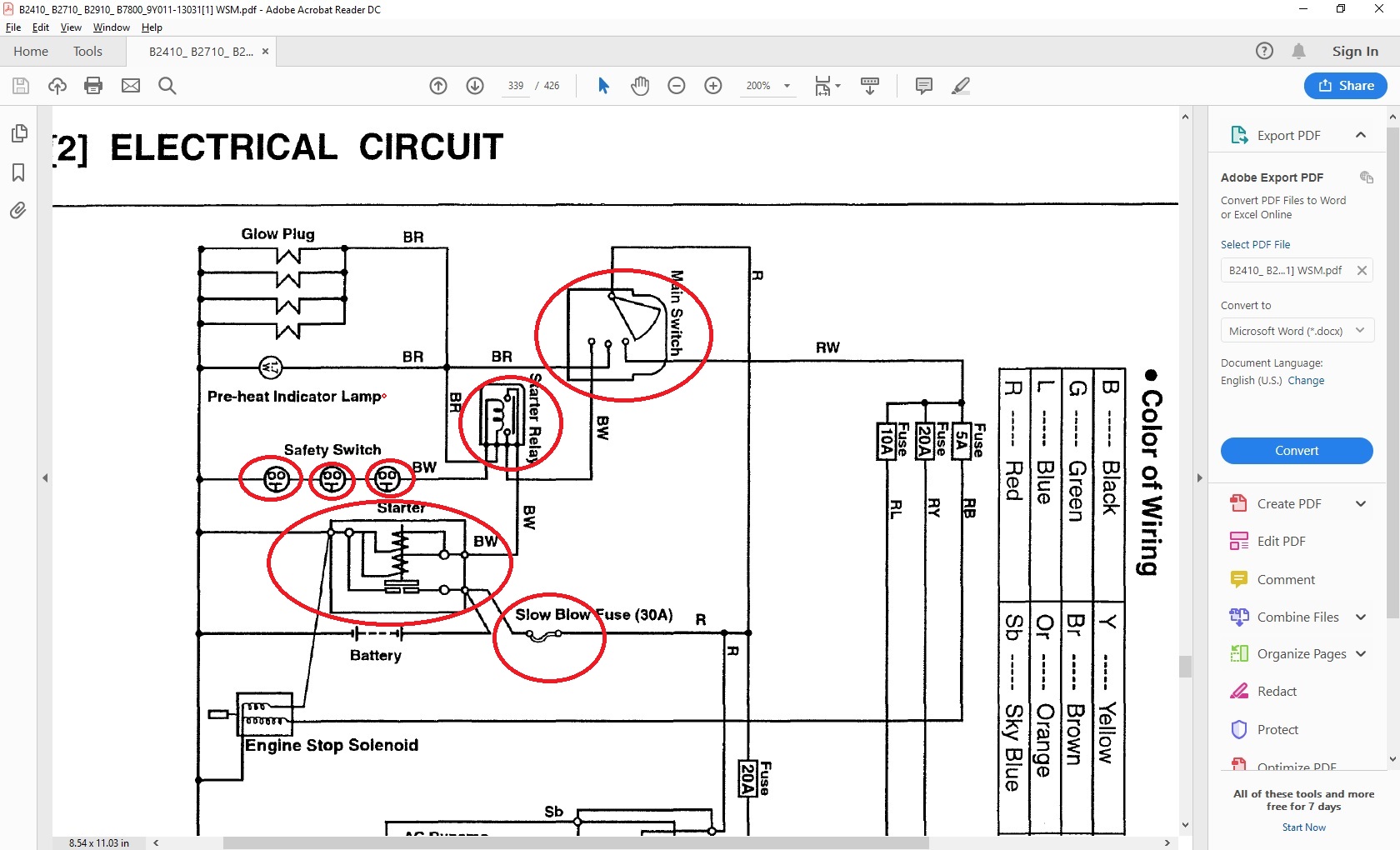

Would not be the first things on my list, but it's time to start digging in I guess. Do you have the Ops manual or Service manual with a wiring diagram (schematic more or less) for this unit? I'm guessing a bit to common elements as it's a B and my issue was an L that may have different technology. Take look on the site below and see if any of the Ops guides have a equiv. wiring diagram possibly? By that I mean maybe the B2900 ops or SM has one? I did not see it in the B2920 manual. So they'll expect you to buy the WSM....
If you can get into a diagram for her and post back, I'll check out what's involved. Do you think the solinoid could be bad? To check and even take apart to clean you can find the stater type. Mine was a DENZO. then do you search like" denso starter solenoid replacement" which is how I learned to swap mine out. Bunches of them: e.g. Denso Starter Repair (Honda, Toyota, Chrysler etc.) - YouTube
I did check a key start matrix on a diagram for a guy blowing fuses here.. .and it is the same 3 key contact shorts required to start. So I expect yours will also be the same. If we get to that point, my post explains it all in detail but I really don't see that being needed yet. on the plus side, it's 30-40mins of work and pretty easy on an L. to do the test.
For now, I do not know your Dash layout and indicators. in the past, did you get 'all lights' or when you say the two lights that do show, is that the normal condition when the key is turned to run? If you are missing some, then we'll need to see where those derive their power source from to 'indicate' that it's ready to start.
What's that phrase... Ocums razor.. Most obvious is usally the right answer... something like that. I think that we just need to get that starter tested out IMO (in my opinion....Thoughts gang?) How many of those I've done since HighSchool -vs- some crazy ignition switch crap I went thru for 4 days
On the manual, the post on the B is nearly the same unit! It's a B2910... see is this manual look appropriate. Heck, a free WSM manual w/ all the fixing if this works out for ya.
http://www.kubotabooks.com/AutoInde...df&AutoIndex=0fbd4a3166f7a95e1f0c2e08e4836435
   / B2920 won’t start #18

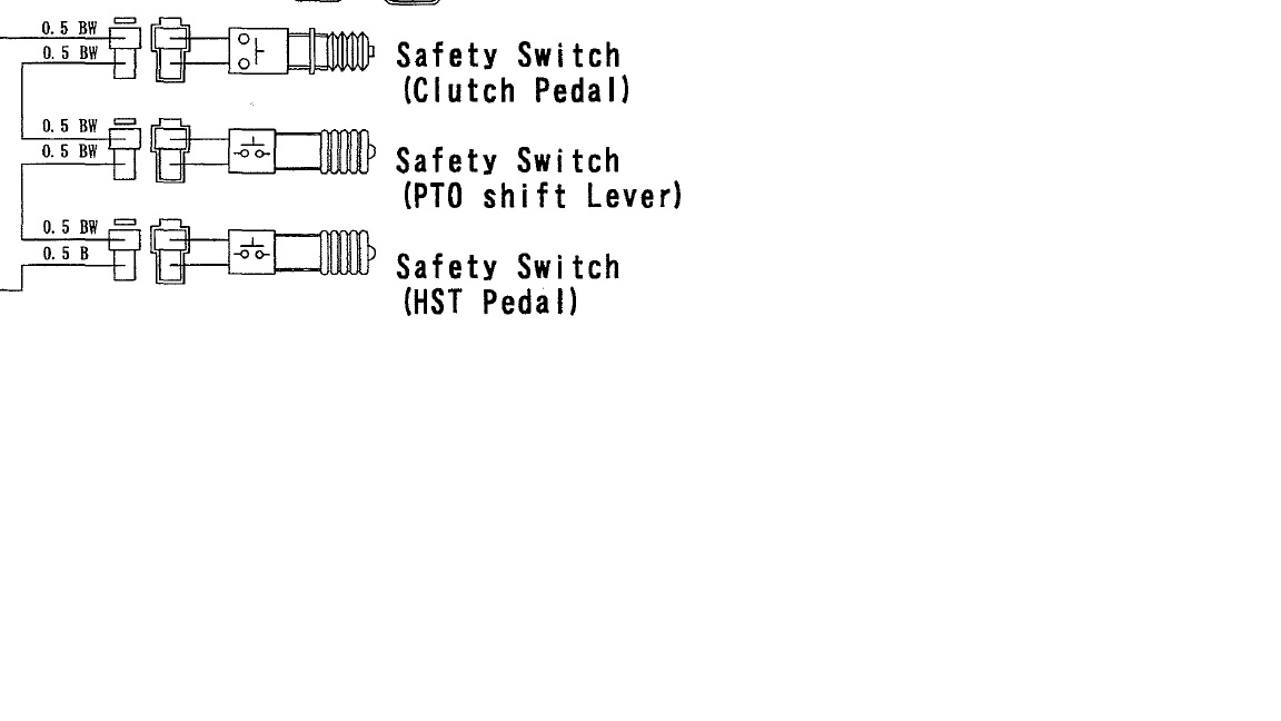

OK.. from the "blowing fuses" post I nabbed a screen shot for ya of the interlocks that are required before she'll start. I just went through this. There are a lot of safety devices in the series loop that must ALL BE WORKING to start the unit. The effort here IMO is to start w/ the most common items and progress thru the manual and pics and see what you can test or cannot test. from your notes, I am thinking Starter inline Fuse, Solenoid, starter itself, Clutch Safety, other interlocks noted as PTO shift lever, HSt Pedal, then ignitions swith in that order. Thats how I progressed on mine recently. And these are typically easy to test if you find them... 0 ohms or open on a switch. and you can see form the print they show you the wire color and that it's on a plug/connector (or not).
Good luck.
