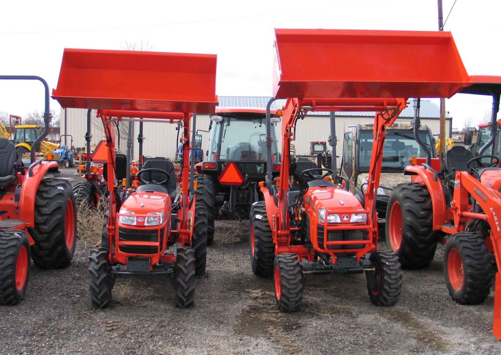

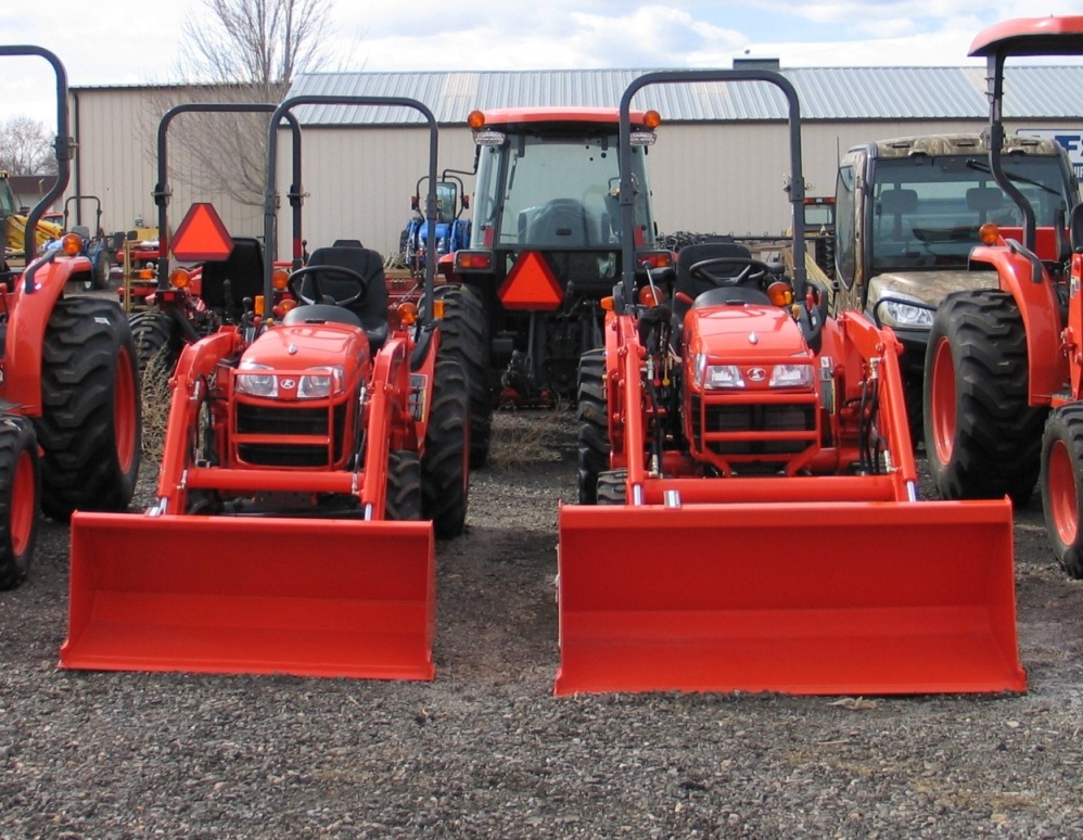

Bandit67 took some good pictures of the two side, by side, and that makes it easier to visualize the differences. I'll attach them here, and hope Bandit doesn't mind. Lift capacities are greater with the larger B on both ends. For some like me, perhaps the smaller tractor is even to be preferred, for others, the extra size, weight, and capacities make the difference. The B2920 uses a smaller 3 cylinder engine which I like for my uses, and it should be better on fuel.

I CAN'T BELIEVE YOU REPOSTED MY PICTURES, CHUCK!!!! :D
Torrak,
I'm not sure if the pictures I took really get the point across, but the feeling you get when sitting on both machines is that the B3030 feels significantly larger, and especially, much wider. The B2920 feels just a tad bigger than my previous subcompact. In fact, the loader bucket is only 1" wider than my subcompact's 48" bucket.
The motors feel very different, too. The 29hp comes from a 77 cu.in. engine at 2800 rpm, while the 30hp comes from a 91.5 cu.in. engine at 2600 rpm. That makes for a fairly significant overall power difference, including a large torque difference. FEL capacities are within 150 lbs, but there is a big difference in 3pt capacities, and the overall PTO & 3pt system on the B3030 is far superior, IMO. And frankly, after trying both machines out, if the specs for the B2920 loader are correct, I'd be concerned with being able to lift that much with such a small machine (based on the full height capacities).
