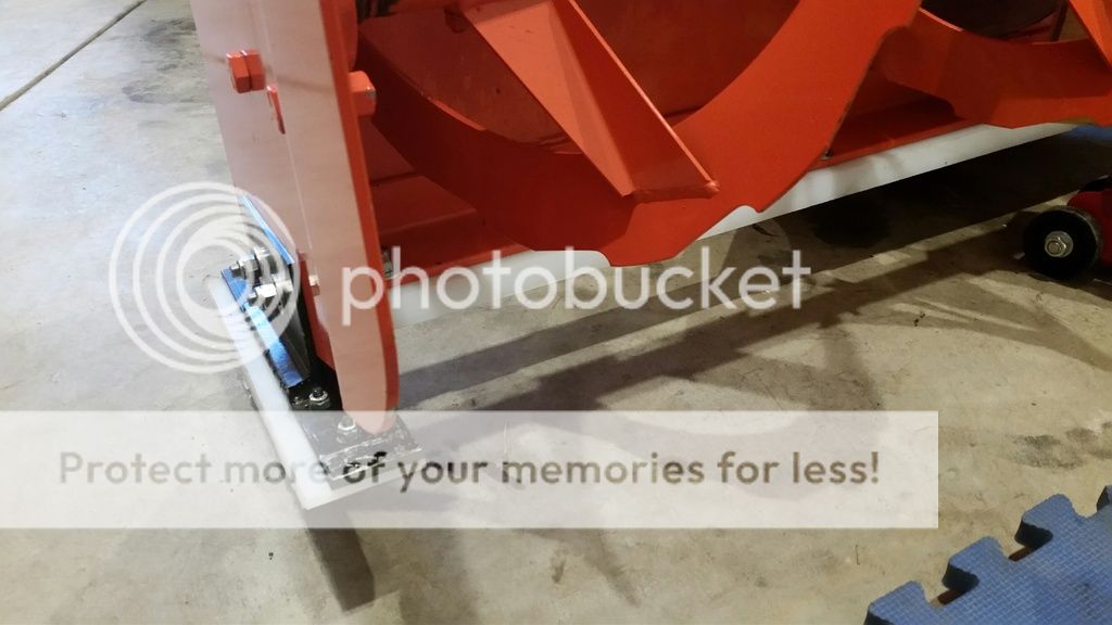

2 yrs. no problem, lately wet snow has been clogging the chute. does the plastic wear out and need to be replaced ? does it need to be sprayed ???
/ B2782 Snow Blower modifying
#62
The UHMW-PE shows no sign of wear in the chute. I've never had to unclog the chute until this year, we had a wet slushy snow that was more covered with a layer of heavy snow. The top layer would tend to push along in front of the blower. It packed in like ice. Spray, though not necessary on the parts lined with plastic, sure works well on the unlined augers. I've been using Gempler's Silicone Snow Plow Coating in a small pump sprayer - works very well, especially if you follow directions and coat things in advance to give it a chance to dry. Gempler's on-line sells it for less than on Amazon.

thanks... I have some on order... I have some scuff marks on the UHMW... is there a right side to use or are both sides the same......
you have this on a BX-24 what model blower are you using... ?
UHMW-PE sheet, normally has no "right side", both sides are the same. However, there is a chemical process that allows the application of adhesive to the material and this is obviously done for UMMW tape (handy stuff). I haven't seen adhesive lined sheet, such as the 1/8" thick material I used for lining the chute and impeller blades etc. but it is probably available.
Pretty sure I mentioned previously, UHMW is the mechanically strongest, most abrasion resistant long chain polymer available. For some applications, such as aggregate abrasion, it is longer wearing than steel. UHMW is almost as slippery as Teflon - but FAR stronger and much more abrasion resistant. However, as strong as it is, it will abrade and wear over time.
In attaching UHMW to a substrate, steel in this case, you must consider that UHMW will have a higher coefficient of thermal expansion than many other materials. This will be more noticeable on larger pieces, of course, where holes may need to be larger or slotted, to allow the material to expand or contract without buckling or shearing fasteners etc.
I mentioned UHMW tape, it's available in many widths and thicknesses (I have from .004" to .015" with acrylic adhesive). While this tape is great for many applications, it doesn't work on a snowblower in areas subject to direct gravel impacts as it's too thin to absorb the impact energy.
I've found Peechtree Woodworking (on Amazon) has good prices on thicker stuff (1/4 to 1" etc).

McMaster has "everything!" . . . but their prices are a bit on the high side IF you can find stuff elsewhere. There is a price to pay for their convenience, great customer service, and selection.
On the UHMW-PE sheet with adhesive, keep in mind that this stuff is **** for stout, very strong, so that would probably be only suitable for flat surfaces. To make tight bends, it will need to be heated to 300F and held in position until it cools. When heated to "plastic" the white UHMW will go clear and then back to opaque white as it cools. Really amazing stuff. Oh, and difficult to plastic weld, I hear - - though I've never tried that.

Tried some Gemplers.... so far so good... Thanks
