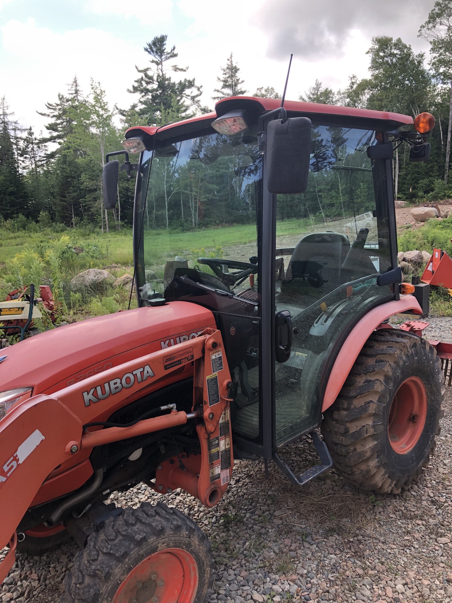

Hey, I purchased a B2650 and while I was towing it home the cab roof blew off on the highway. Luckily the roof never hit another car or caused an accident. While loading the tractor and attachments onto the trailer and truck I never thought that I should have strapped my roof down to keep it from blowing off. The wind must have caught the roof and ripped all ten of the nutserts out of the plastic roof. I priced a new roof, and it is around $1,500 Canadian, I think I can fix it though. Has anyone else heard of this happening, the dealers I spoke to have not and I have never noticed tractors being towed on the highway with their cabs strapped down.

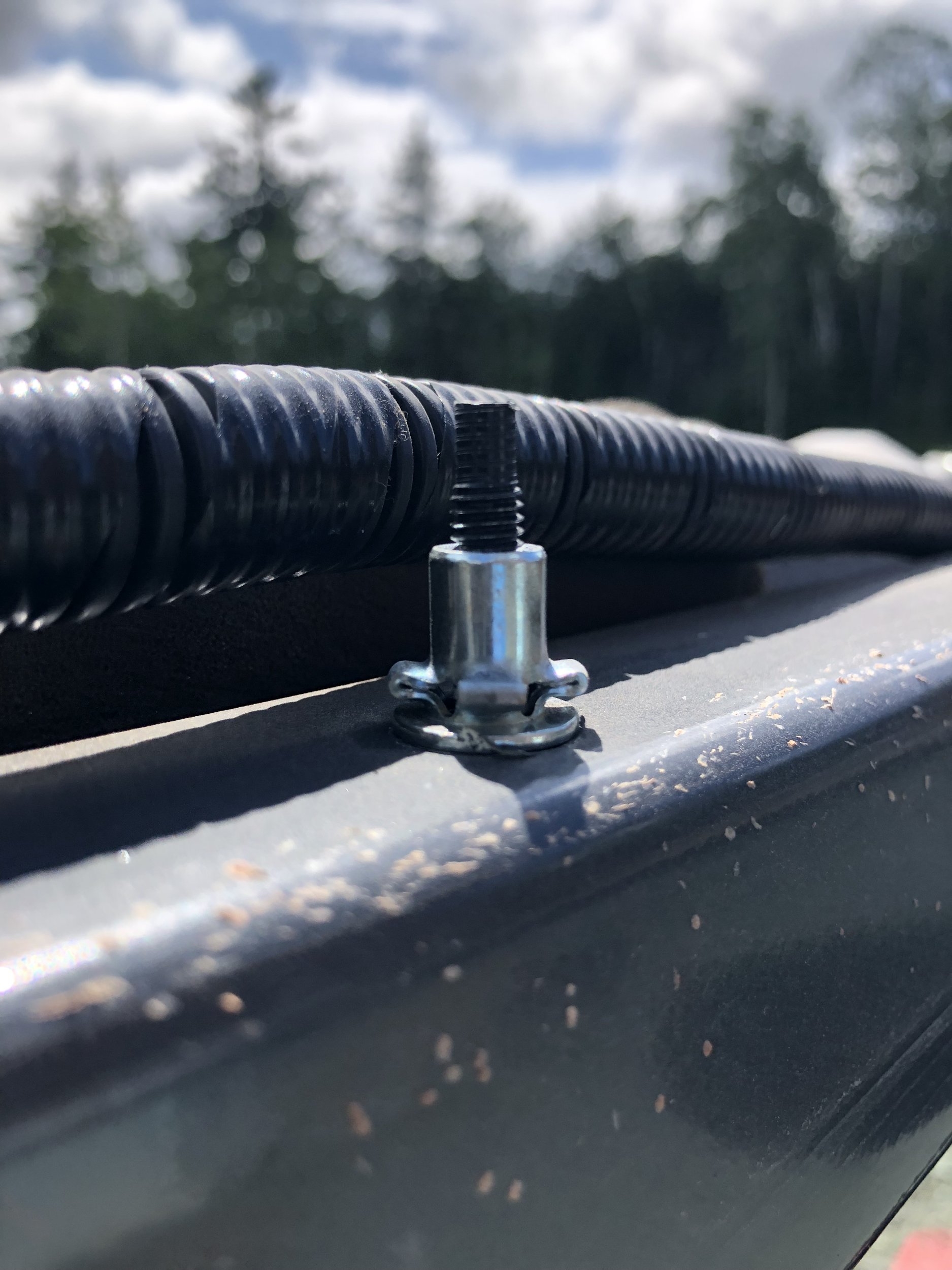

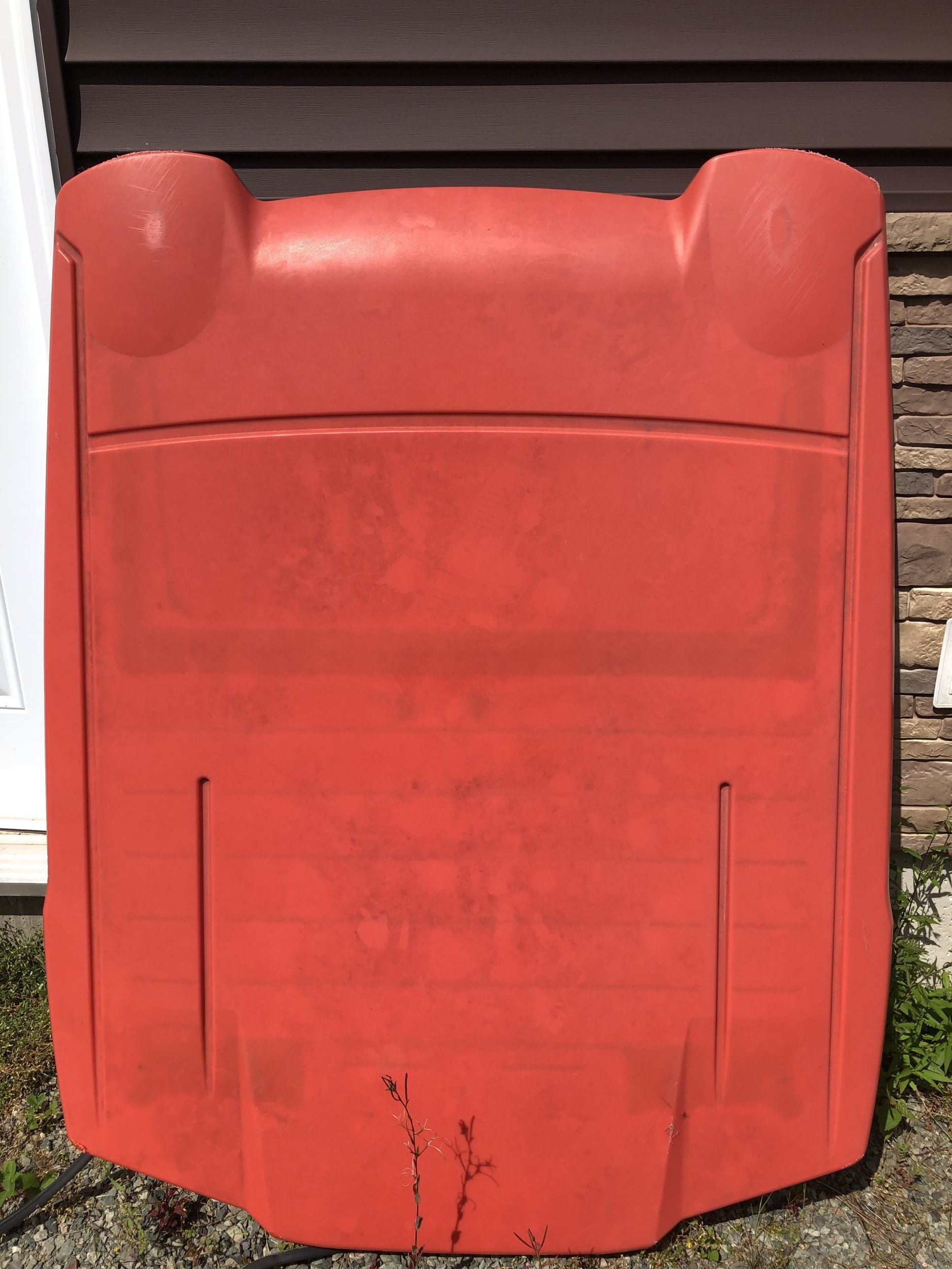

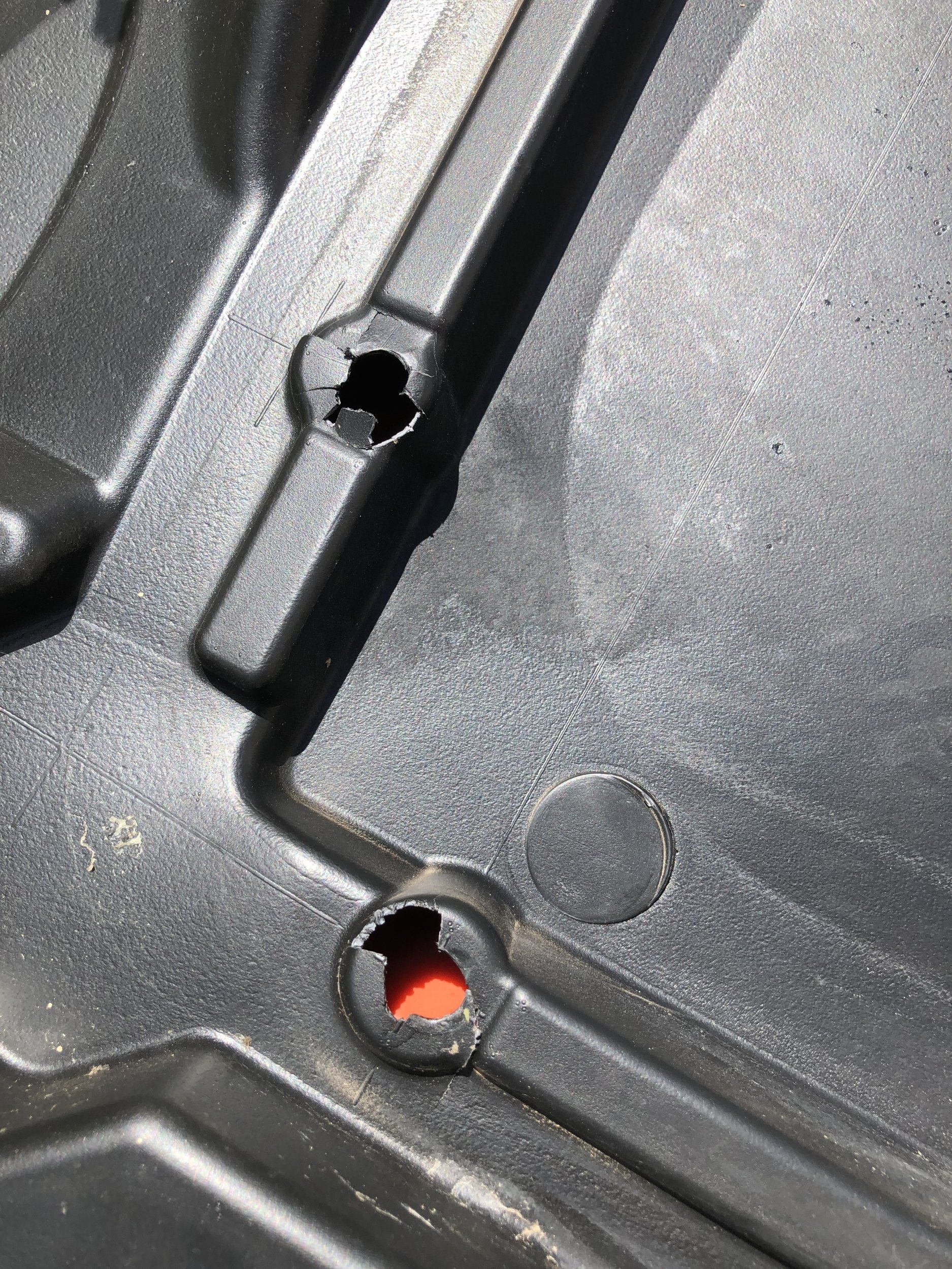

Here are some pictures.

That roof and mine are 2 distinctly different in the way they secure to the top of the ROPS structure. My roof has Rivnuts in it and the roof is secured with Phillips head machine screws that thread into those Rivnuts, whereas yours are set in plastic (I don't care for that actually) and it don't appear to have a sealing gasket either (like mine does). It appears to me that the only solution is to relace the failed plastic part with a new one, but then I'm not even sure about that as like I said, yours and mine are distinctly different.
I think it is similar to yours, all my rivnuts pulled out of the plastic roof. The rivnuts are all still attached to the machine screws and I do have a gasket, just not in the pictures. If I can get the rivnuts secured back in the holes they pulled out of with fibreglass or epoxy I think that might work. It’s $2000 for a new roof so I’ll try my best to fix it.
   / B2650 Roof Blew OFF #40
Look at my posted pictures and proceed accordingly. Those Rivnuts in your picture don't look at all like mine. Fiberglass resin and mat is your friend. Epoxy isn't.
