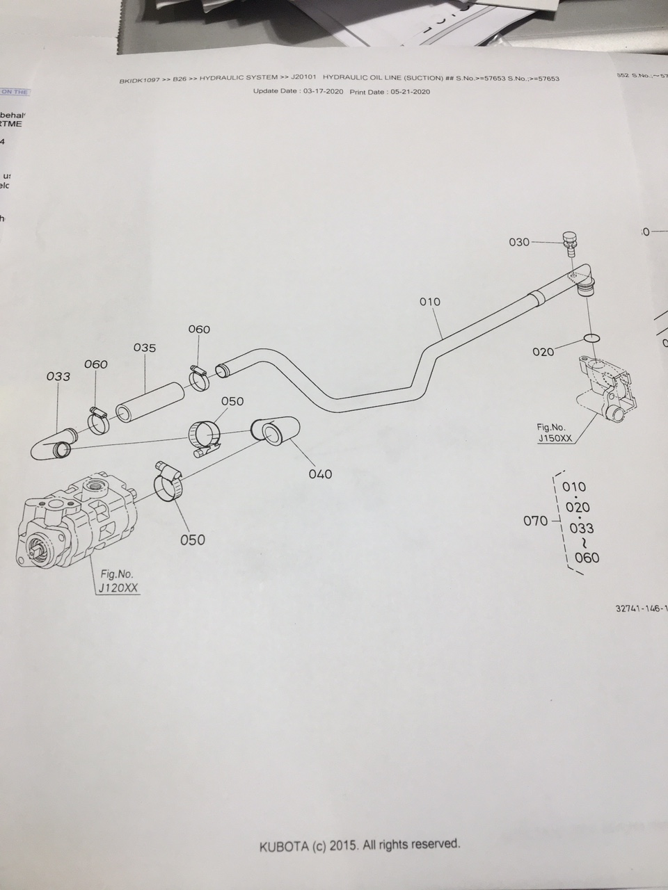

Coming up on 400 hour service. B26, 2016 model. Noted some external leakage at fill plug and dipstick after mowing for several hours at a time. Not much but enough to attract dirt. A friend with an earlier B26 had a worse problem caused by rubber elbow on the suction side of pump. Air was being sucked in causing cavitation and oil aeration. He has replaced that elbow several times with the last one being different material. So as part of my maintenance replacing oil and filters, ordered new rubber elbow 32741-39160 $23. Surprised at the kit when picked up. Not only the elbow but new metal and rubber tubing, clamps and Oring. New design is more alignment and vibration friendly. I could just replace the rubber elbow with current hard tube or replace all the tubing with new design. Parts guy give me copies of both parts diagrams and rechecked. Lot of parts for $23. Usually the surprise is the other way.

/ B26 Hydraulic inleakage
Got the part number from Messicks web site. 32741-39160 for just the rubber elbow. Did not see the new 4pc design.
May 18, 2020, Ordered from local dealer by phone, invoice part number received; 32741-39150 Replaced.
Part number on bag 32741-97902 Hose,Assy<suction
Kubota sticker, made in Japan
With all the different part numbers even more surprised what I ended up with.
I’m thinking the new 4pc suction line assembly that replaced the old 2pc suction line was done to address air inleakage problems on suction side of the pump with both different materials and design.

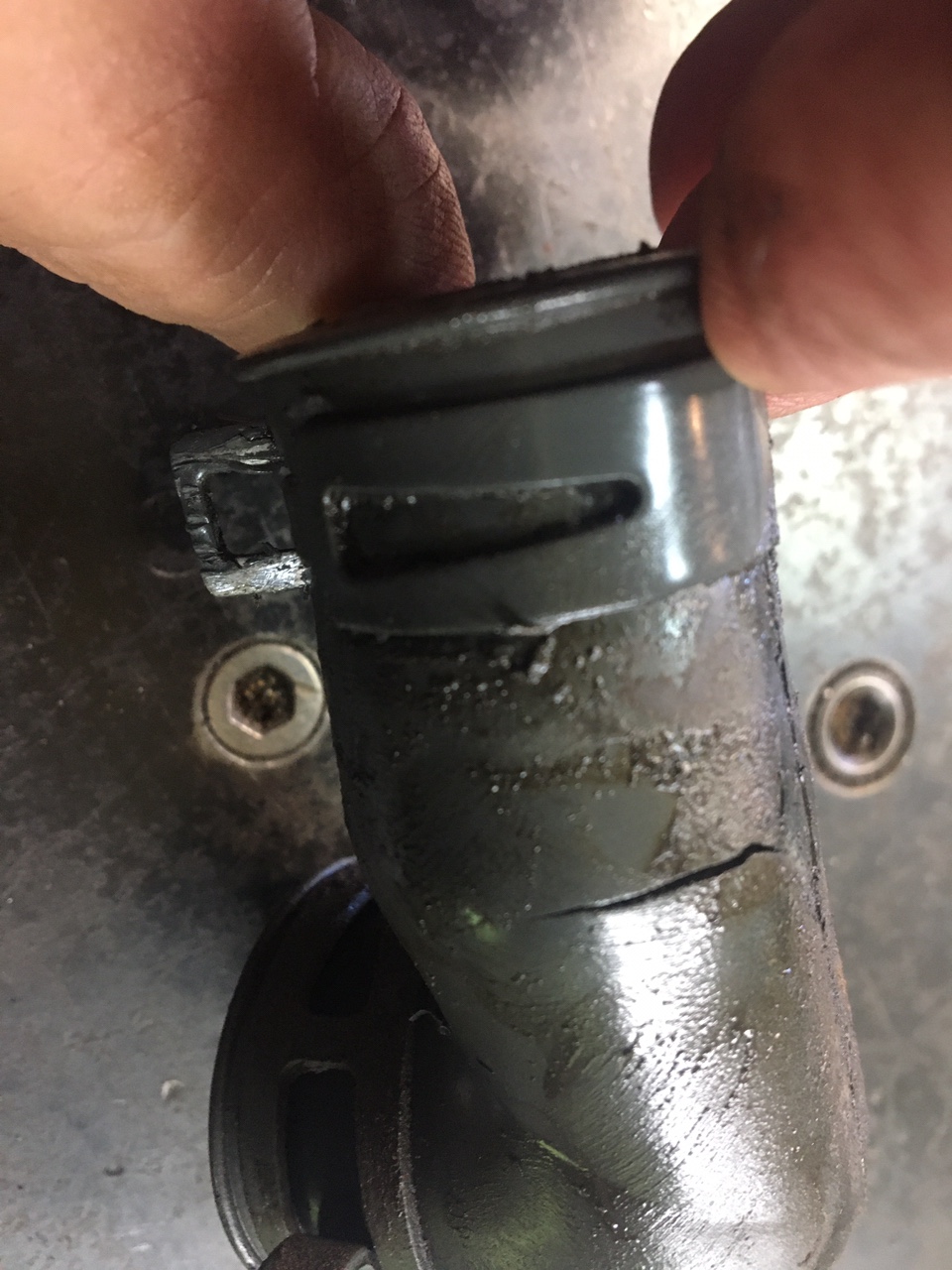

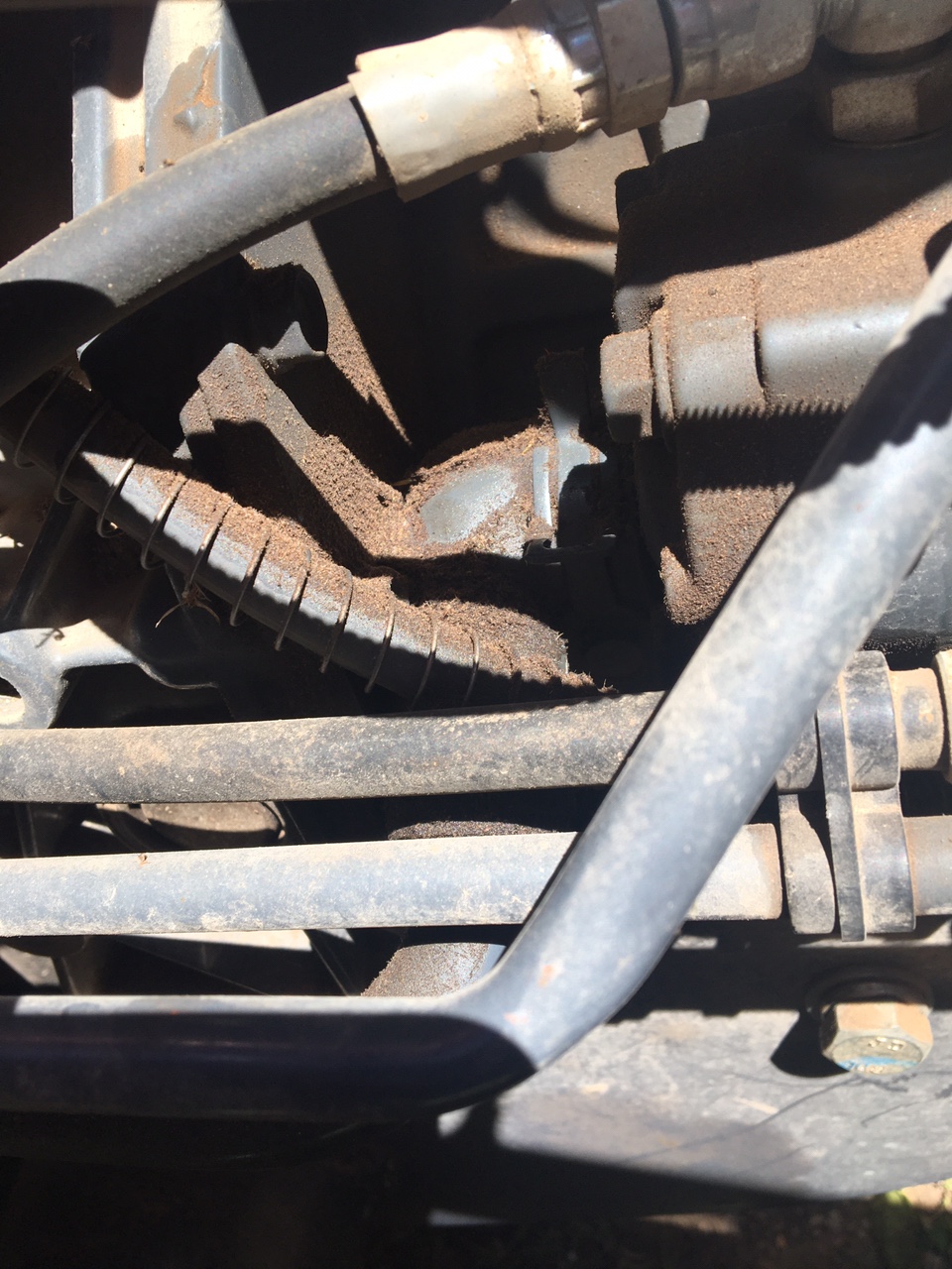

Replaced the pump suction line with new a improved Kubota version. IMG_1476.JPG Suction line external from the hydraulic filter outlet to the suction side of pump.
Rubber elbow kind of buried is the problem. Note only the slightest oil/dirt film. Never enough to spot the floor.

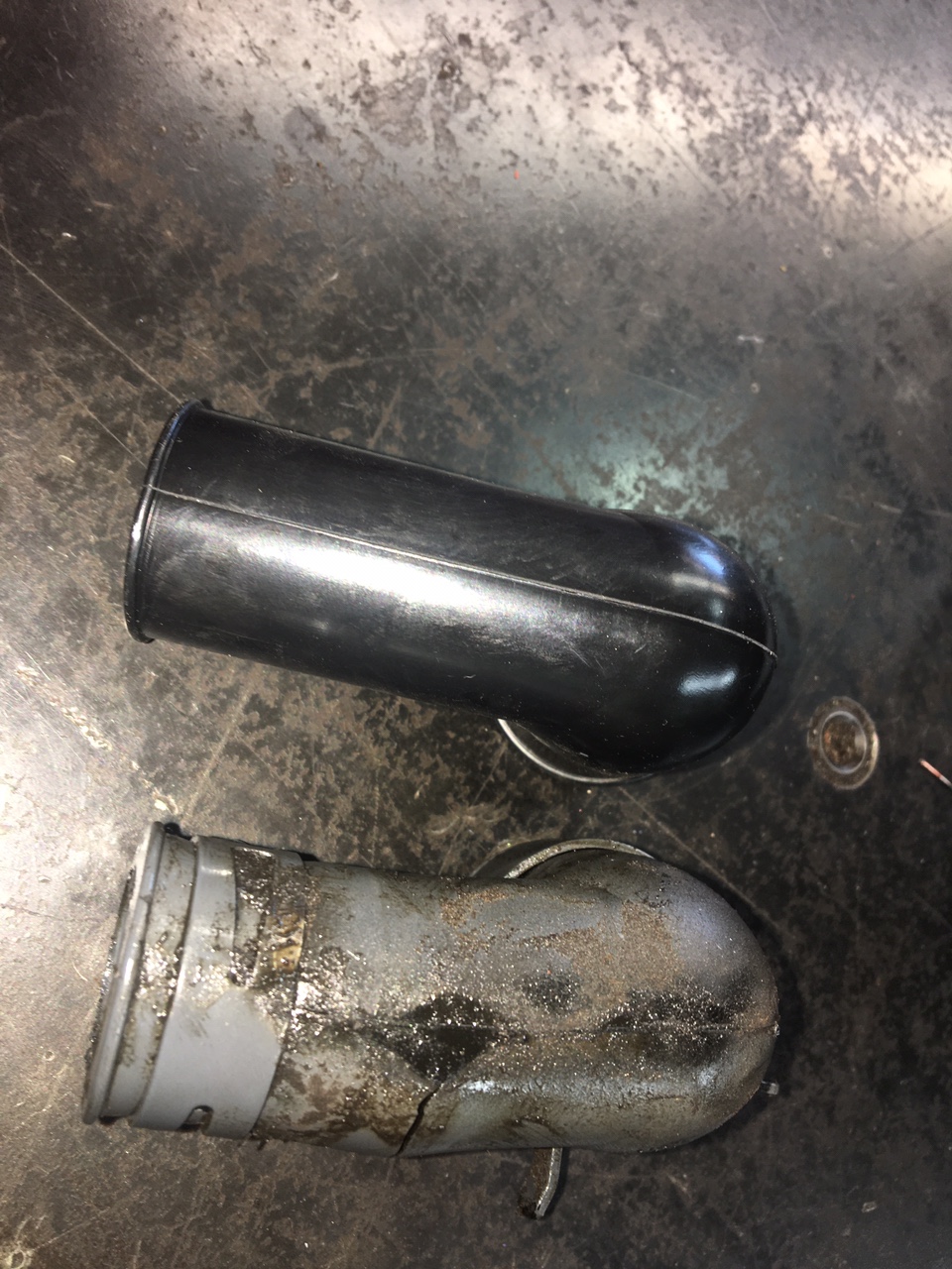

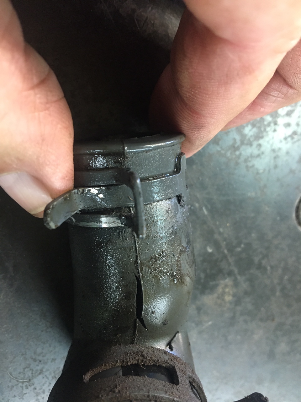

Note the cracks in elbow. These allow unfiltered air to be sucked into the hydraulic pump. Of course the cracks happen exactly where you can’t see without removal.

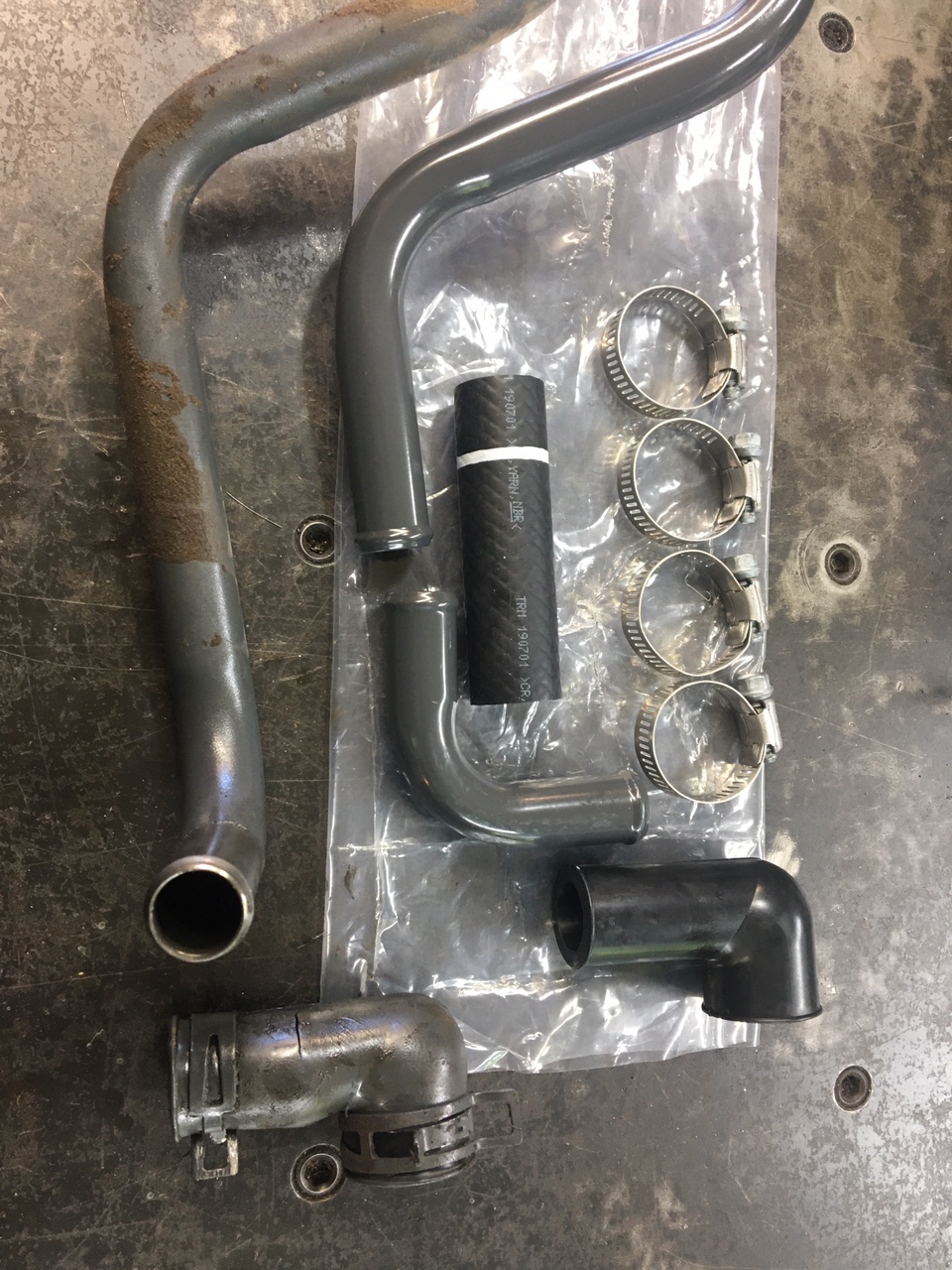

Note how the old elbow was in strain with the hard lines.
Old line with new line. New designs helps with alignment and hopefully with vibration and thermocycling resistance. Greased all connections with silicone high vacuum grease to be sure all joints were bind free before tightening hose clamps. Lost several gallons of sudt replacing the line. This was part of the 400 hour maintenance anyway so going to completely drain overnight and then go back with new filters and oil.

Using the screw hose clamps provided by the updated suction line. Fluids and filters all changed. Can’t tell any difference from whine or operation yet. Cleaned the rear of the tractor around fill port. Hopefully will not have oil coming out the fill port now.
Don’t have faith in the rubber elbow. Looked like the same design and material. No reinforcing mesh in the rubber. New hard line design is kinder for alignment so hope it last 400 hours. Probably replace the rubber elbow at the next 400hr service interval.
