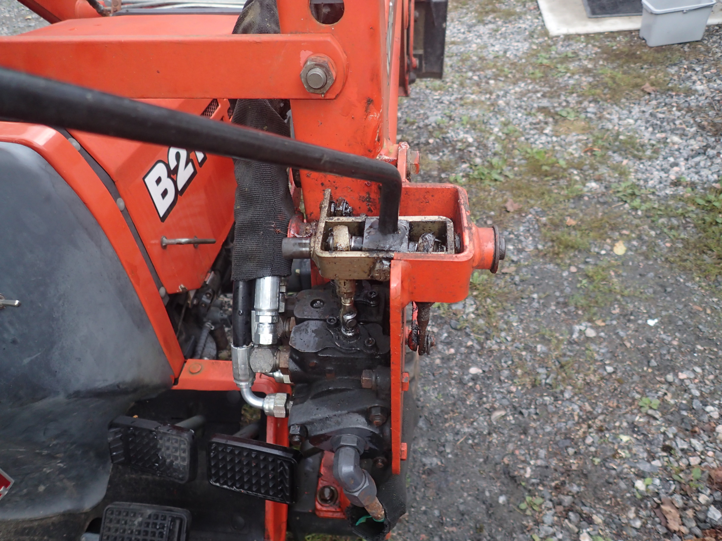

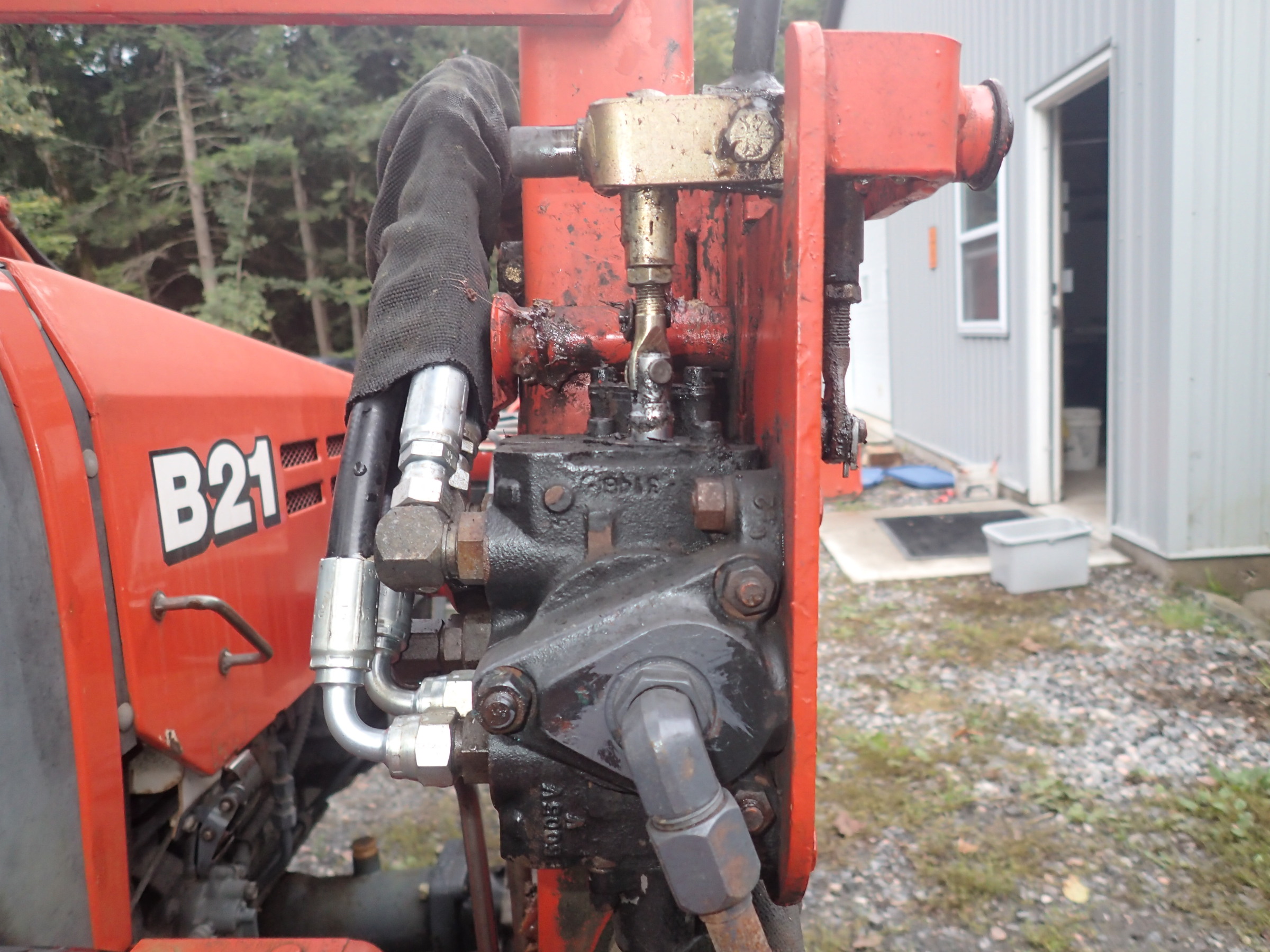

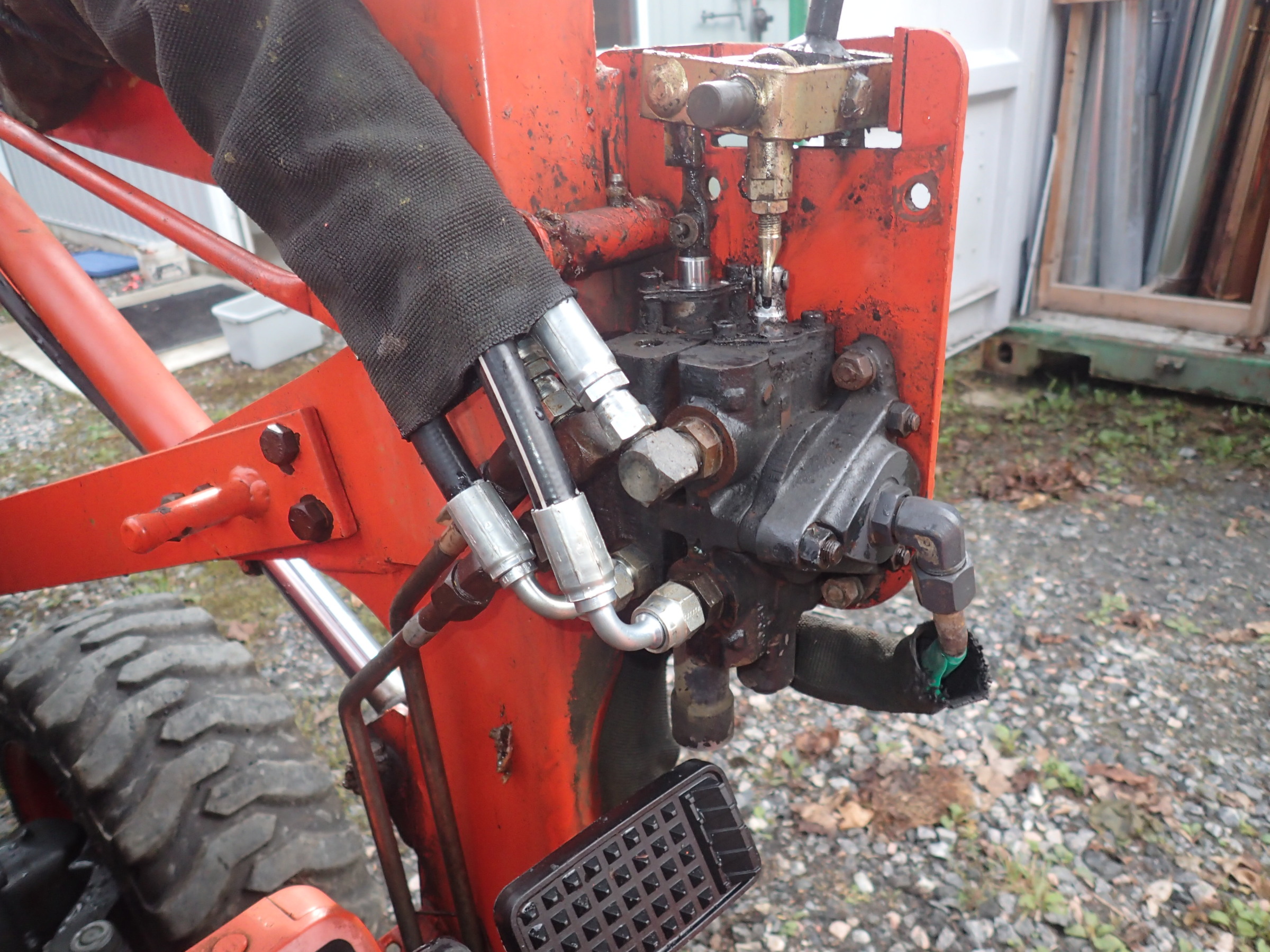

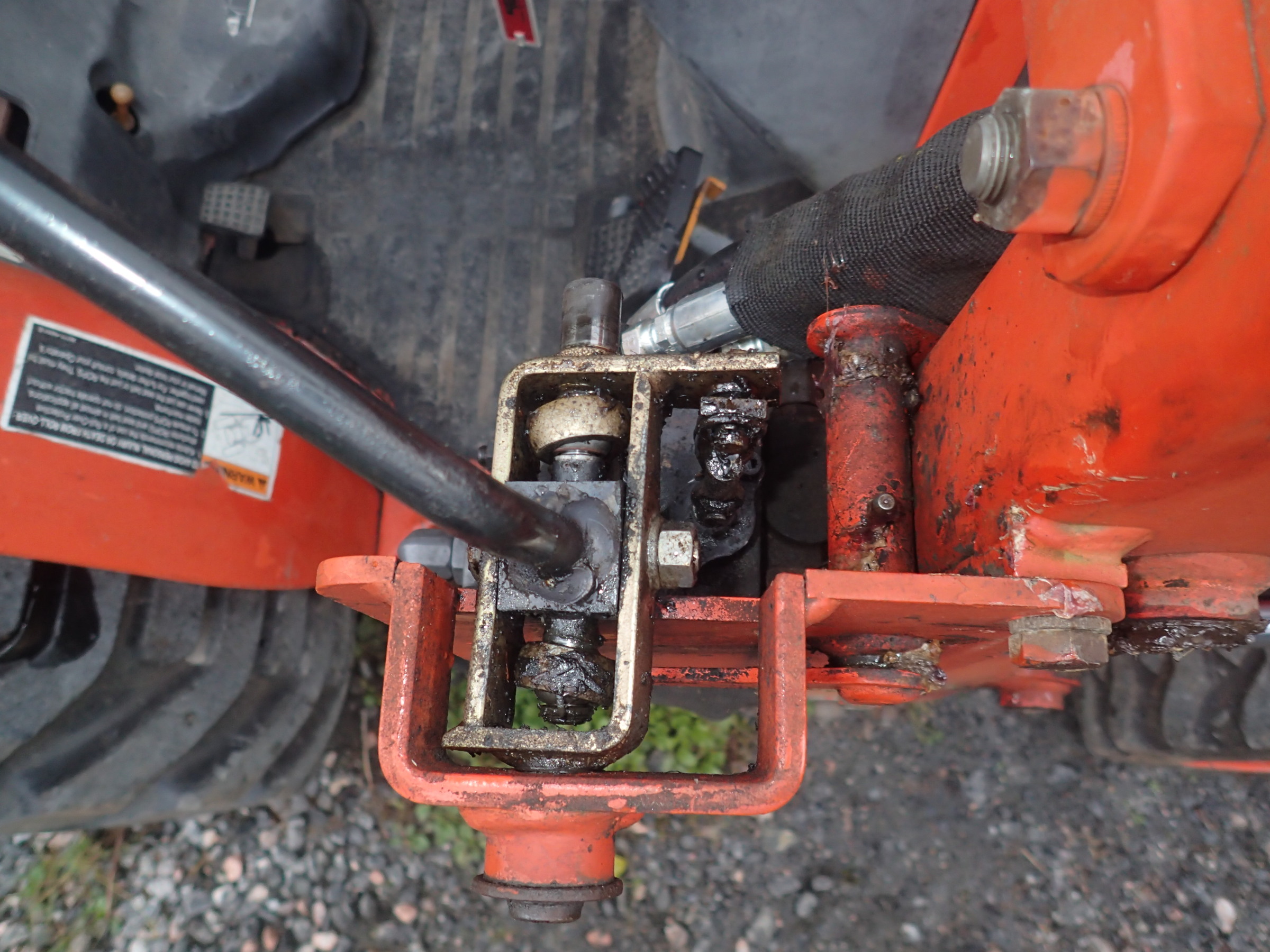

Post a picture of the loader valve and I may be able to comment.

Here are some photos of the valve.

My neighbour found a small Allen screw to adjust the remote on my B7510. It was hidden in a plain cylinder. In your case I would lie down under the valve and look up to see if there's a little Allen screw in view.
