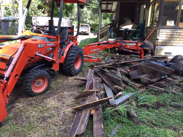

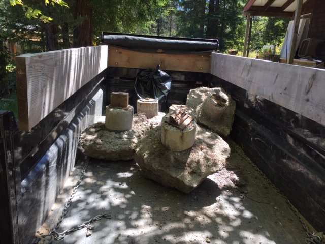

I find that 90% of the use is in demolition - breaking up old structures, pulling up footings, etc.

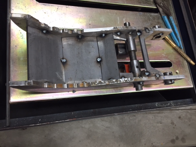

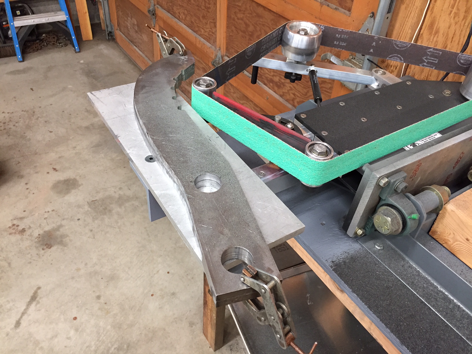

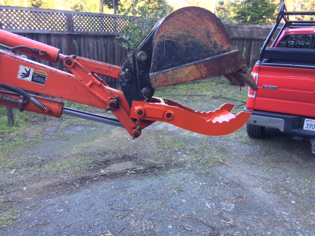

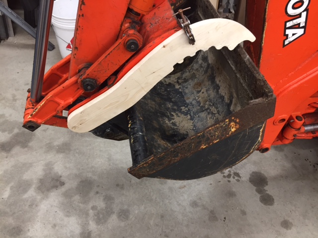

After a while I added a quick coupler to the backhoe so I could change easily between digging bucket, landscape bucket, ditching bucket, and root ripper. That changed the relative positions of bucket and thumb and messed up the thumb closure.
I tried to live with it but too much functionality lost. Last winter I decided to make a new thumb. Photos show the wood template, cleaning up the main rails, tacking everything together, and final installation. Fit is again perfect. I added a bit of extra curvature because the factory thumb was too flat, had a tendency to squeeze stuff out.
The main rails are 1/2" steel, all the gussets are 3/8". I followed the design of the factory thumb on bracing.
Photo 1 - template.
Photo 2 - cleaning up the main rails after plasma cut.
Photo 3 - tacked up.
Photo 4 - test fit.
Photo 1 - template.
Photo 4 - test fit.

I would be happy to answer any questions. I made some drawings at the time but don't have them now.
The basics:
Cylinder - this is the exact same as on the B21 stabilizers. Perfect for retracted length and stroke.
Thumb - this is the part used on the Kubota BH77 mechanical thumb. It is easily converted to hydraulic.
Links - these are made from 3/4"x2" flat bar. The holes are 6.75" OC.
