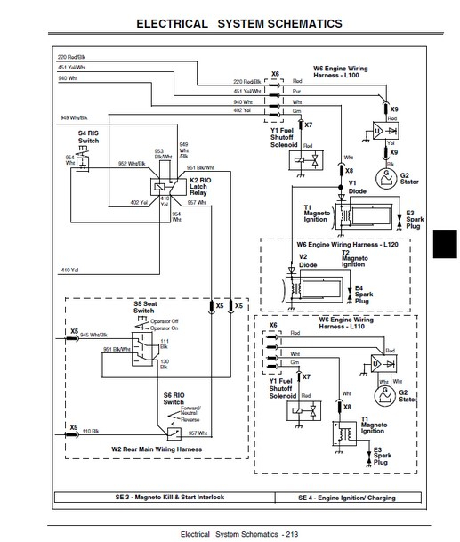

OK here's my story..... The L120 which has given me so many headaches and that spawned this thread started and ran just fine Saturday morning after all Fridays headaches.... IT is assumed (bad word) it is because fuel bowl is full of fuel from all the cranking in previous episodes of all the miss attempts to get it to start..... Yes it has new fuel pump and pulse tube, yes the fuel cutoff solenoid is working... Everything electrical including spark is as it should be so it is probably back to a fuel draw issue..... Really nothing more to do but replace line between tank and fuel pump....
Next thing Saturday morning was to go out and stat the John Deere E180 mower... This mower was given to me by neighbor after a tree fell on it about a year ago and it destroyed the operators station and bent steering column.... A little heat and anvil & hammer work straightened steering column and about $300 worth of parts for operators console and such put it back to appearances as origionally designed,... And after sitting a year and not being run it started right up when I got things together well enough to attempt to start, yes it sat for a yearr and battery was good, and fuel was good (just carb dry) and while working with it it started and ran fine several time while repairs being done...
So it has sat for maybe 2 months not being started, decide maybe I better start it to exercise it .... Jumped on turn key..... NOTHING...
Check all the gear lever and brakes and everything in correct position to start... Nothing amiss..
So check brake interlock switch, remove it test it with ohm meter, tests good... Hmmmm...
Try to start.... Nothing...
Next remove seat and check seat safety switch... Test with OHM meter, working good.... Hmm...
Next is main relay (there is only one controlled by ign. switch) volt meter say its working!... But remove it any and replace with spare from inventory...
Try to start ... Nothing...
Start trying to tracing wiring (with out a wiring diagram but loom is loose enough I can pull wires to identify) looking for loose or rodent eaten problem .... Nothing seems loose or amiss..
Try to start it...YES IT STARTS... Monkey with it for a while trying to get it to fail, does not fail...
Time to move on..
Pulled chain saw off shelf and went to cut some wood, starts and runs good!.... But will not idle, let off throttle and it just dies... Funny because it was able to idle just fine when it was put away last... Several more start and several attempted cuts and idle problem has not cleared itself...
OK back to work bench pull carb off and take it apart and clean all passages and such, re assemble, set high speed and low speed mixtures jets (screws) per manual and try to start, it starts and runs but wont idle, just dies... A hah, did not set idle speed screw correctly... One or two turns in on idle speed screw and start it and let off throttle, it idles down and just sits there idling for about 10 minutes just happy as can be... Shut it off and put it away in tool shed....
NO don't think idle speed screw setting had anything to do with it not idling before carb cleaning .......And it is spring loaded and stiff enough it did not adjust its self....And I did play with it to see how adjusting it effected throttle settings So it was probably off a bit because of my fiddling with it....

So on your E180, pull the terminal block off both the PTO and key switches and look for a burned / broken / corroded terminal. Come across this reasonably often. You can fiddle with the individual wires behind the block while attempting to crank w/ the park brake set. The seat is not in the crank circuit BTW.
/ @#$%&* B&S. Hard Starting....
#52
Yeah.... Thougt about cleaning and apply a bit of dielectric grease to all the connectors to prevent the corrosion problems.... As for seat switch good to know... Guess I really need to get teh technical manual for the E180...

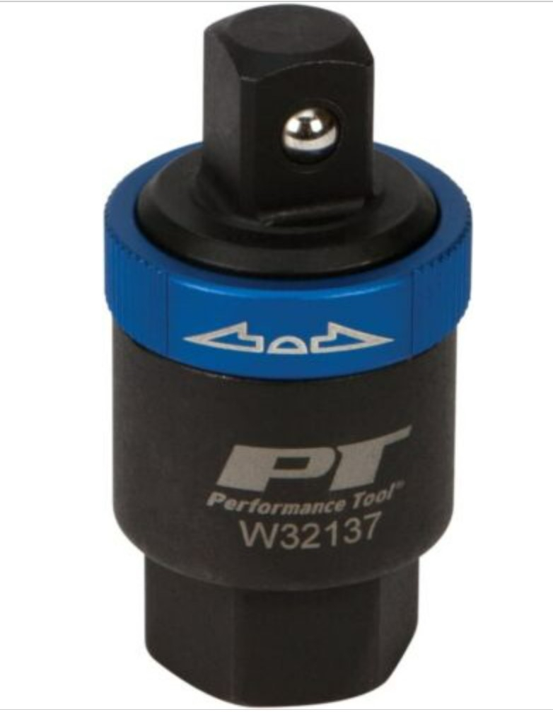

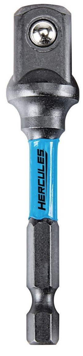

On pull start engines anyone use a ratchet adapter and socket to attach to a drill to start an engine after it sits for a while? I thought of this many times but hesitate to use one if the engine starting at a high speed would somehow reverse the ratchet with centrifugal motion and jam my wrist. I'd rather have 2 one-way bearing models, but I don't have them (if they exist)

I don't believe that would be good. My neighbor builds racing go cart motors and uses this battery,starter,solenoid all in one device. All you would need is the end piece that only turns in one direction.

On pull start engines anyone use a ratchet adapter and socket to attach to a drill to start an engine after it sits for a while? I thought of this many times but hesitate to use one if the engine starting at a high speed would somehow reverse the ratchet with centrifugal motion and jam my wrist. I'd rather have two one way bearing models, but I don't have them (if they exist)
View attachment 782699View attachment 782700
The one I expirmented with just unscrewed the nut that holds the flywheel on.... And yes I was spinning in correct direction to start/run....
