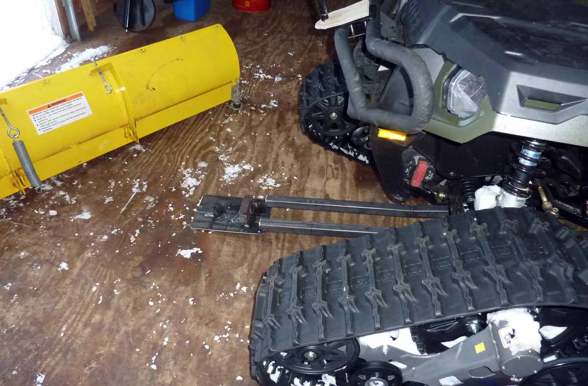

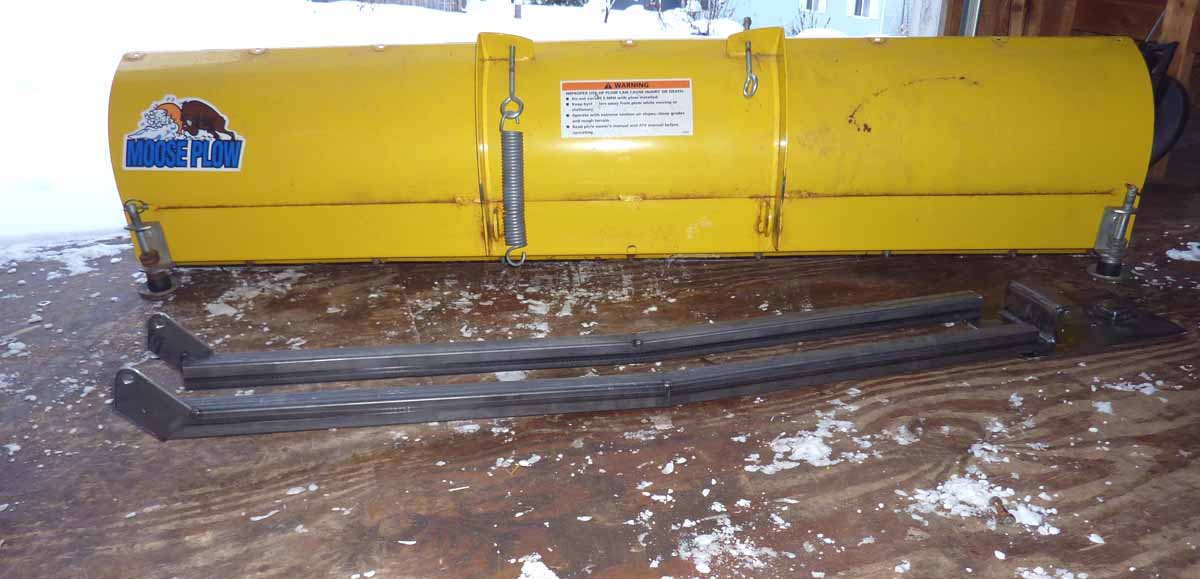

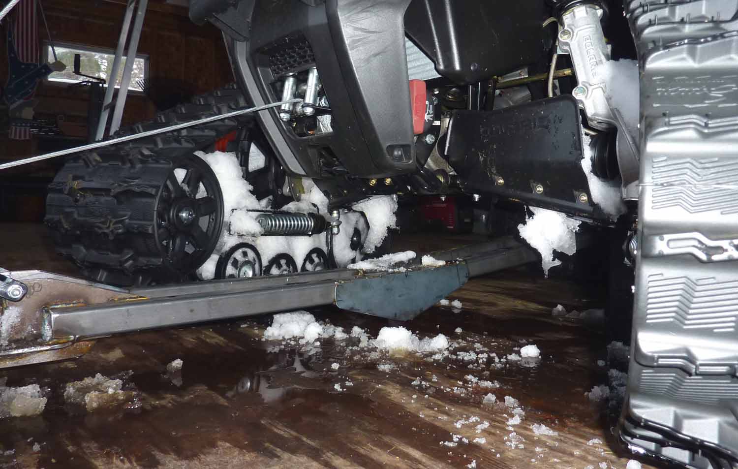

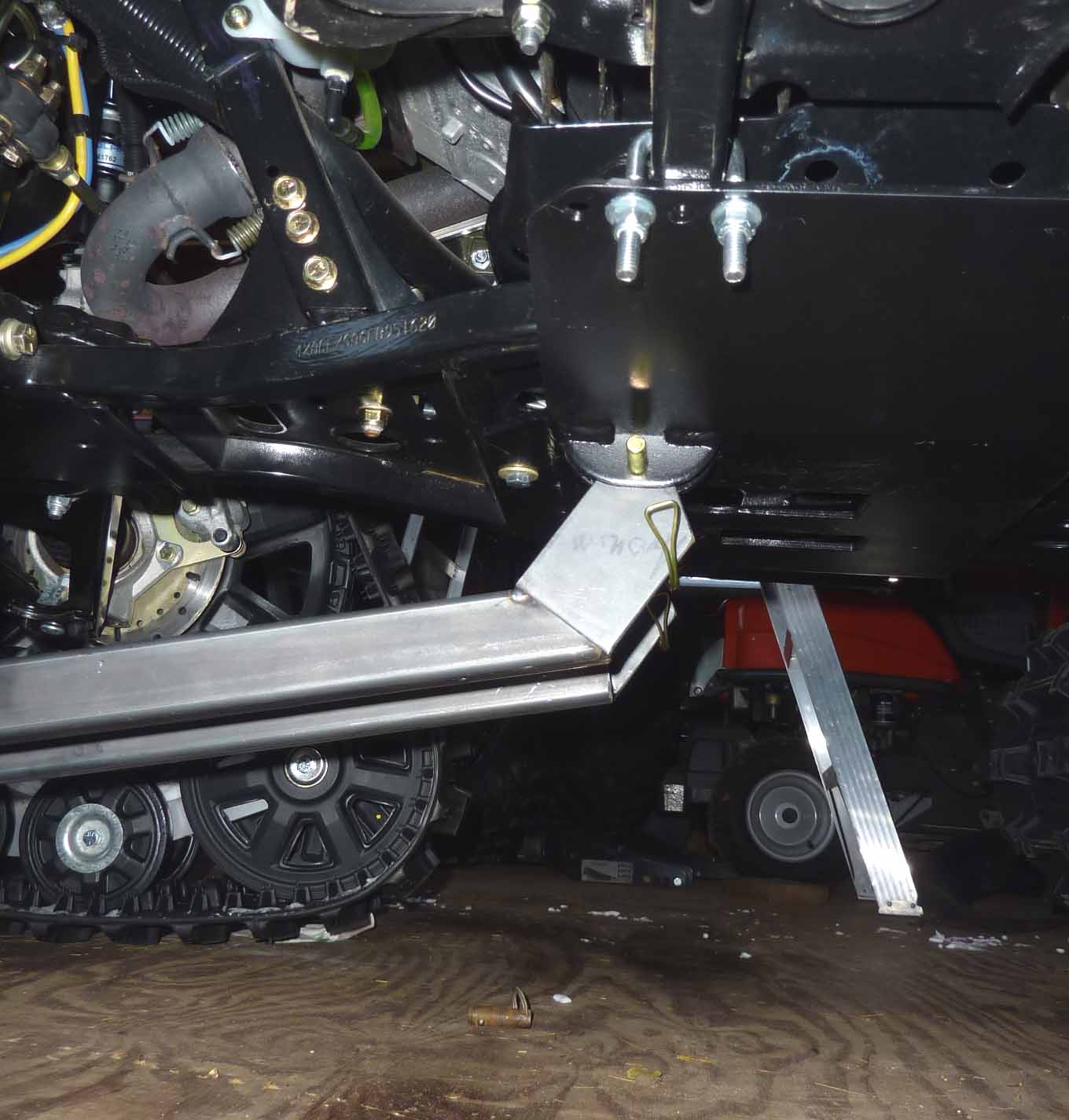

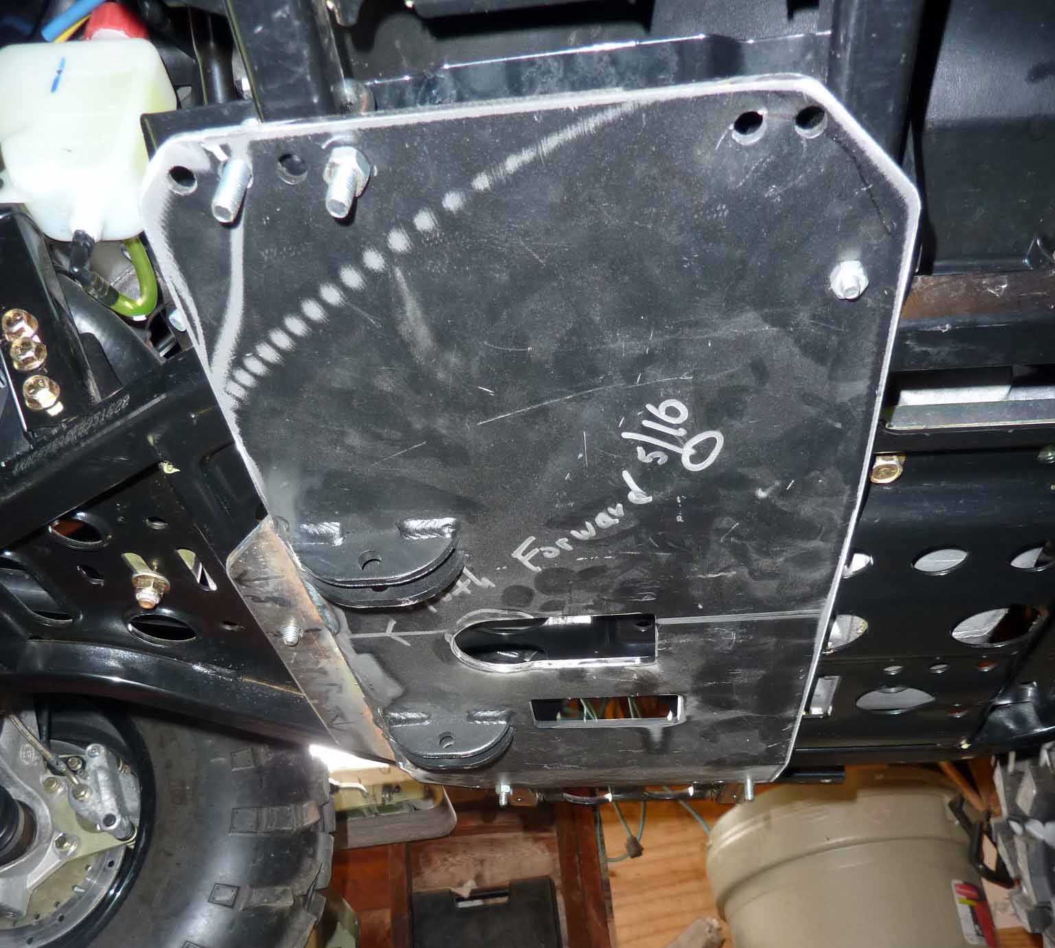

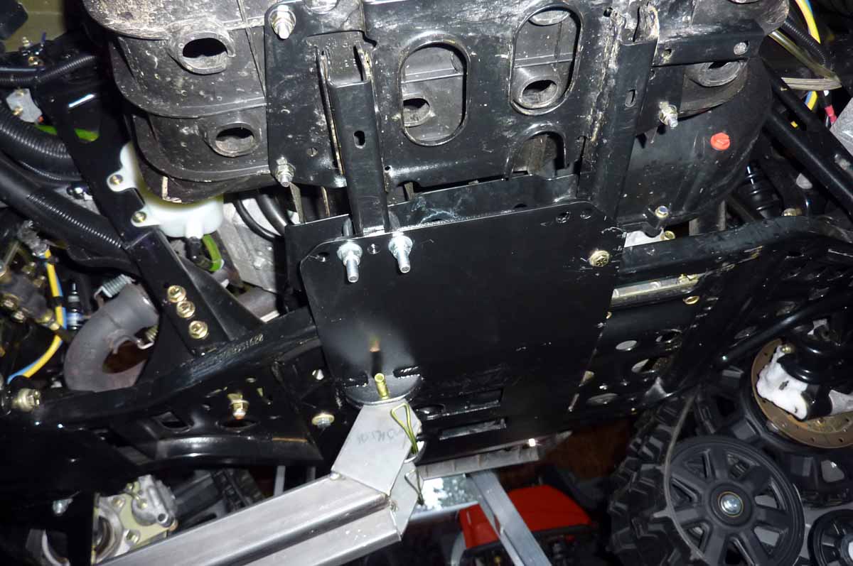

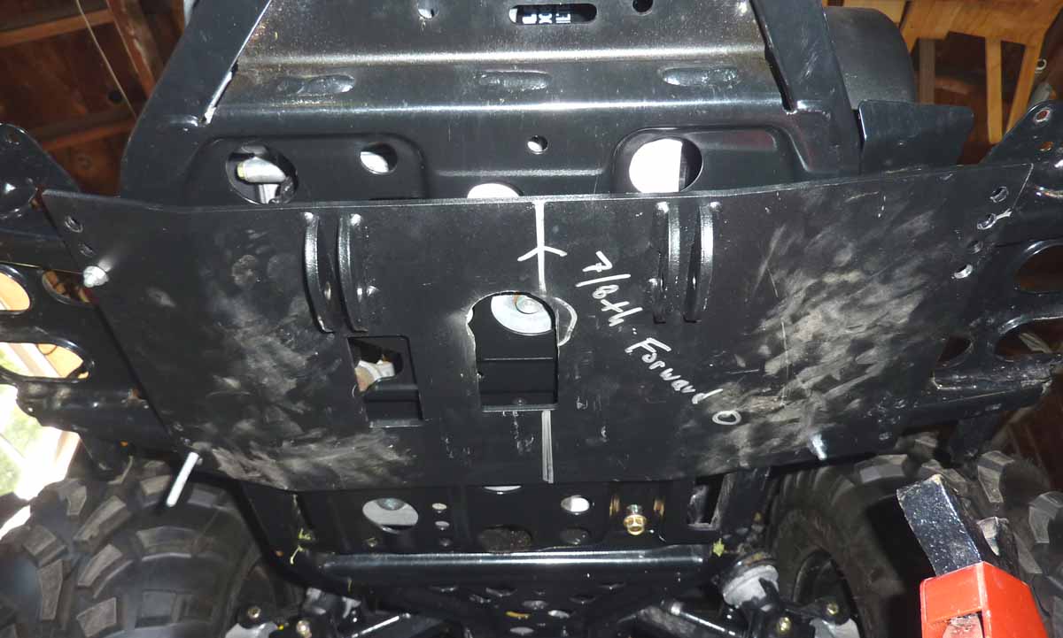

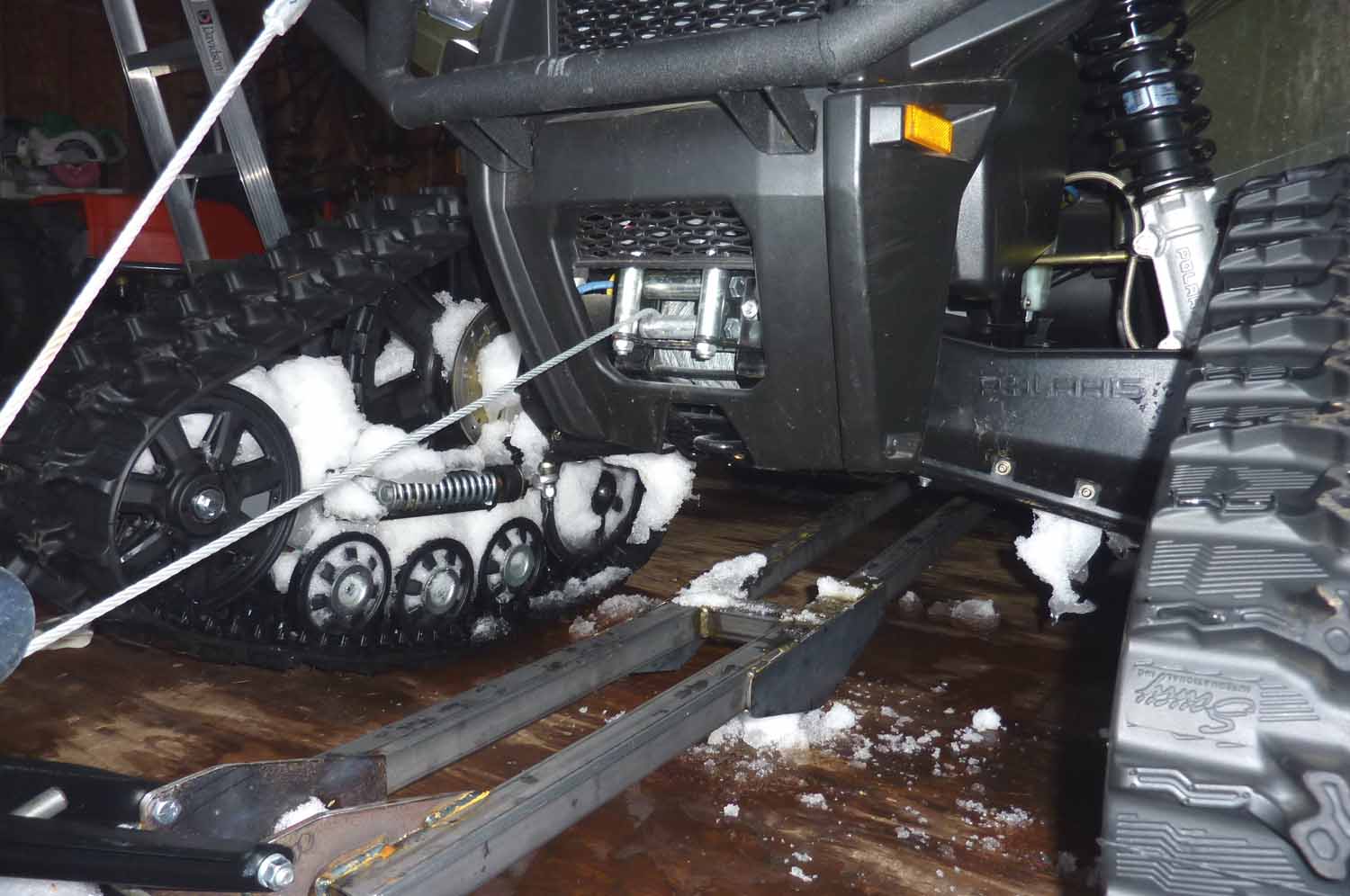

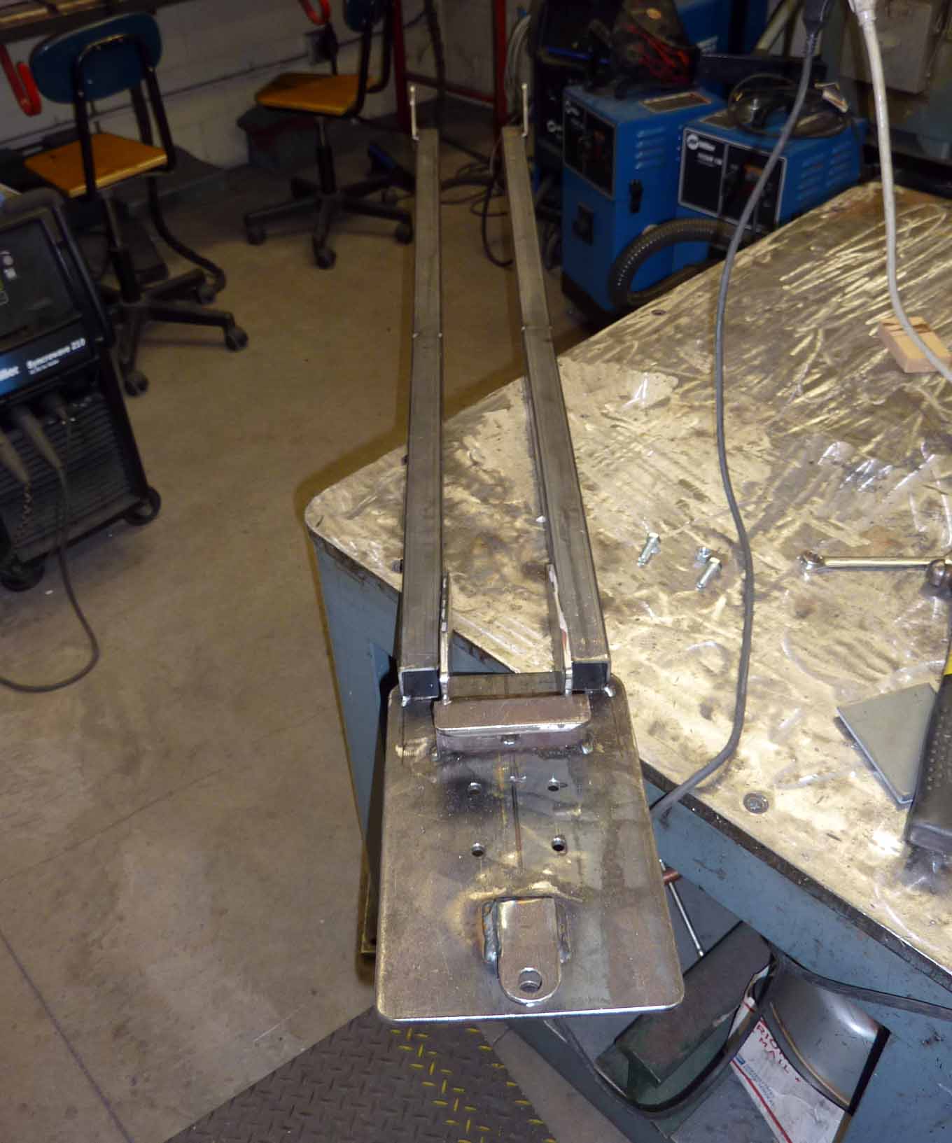

I've got the plow for the Polaris boss 6x6 patched together and in the test mode. Below is a few photos. I had to customize the belly plate to make it work. Plus build the entire push frame since none are available for a 6x6 with pods on it. The plow was a used moose I picked up that's 6ft wide.
The views of the push frame were taken before done so it got reinforced much after these shots were taken.

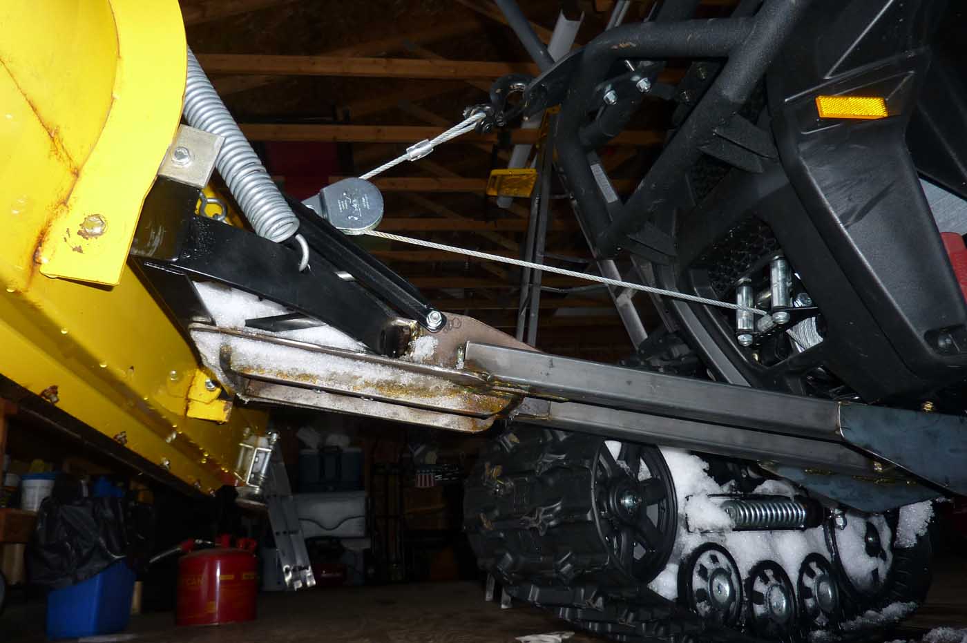

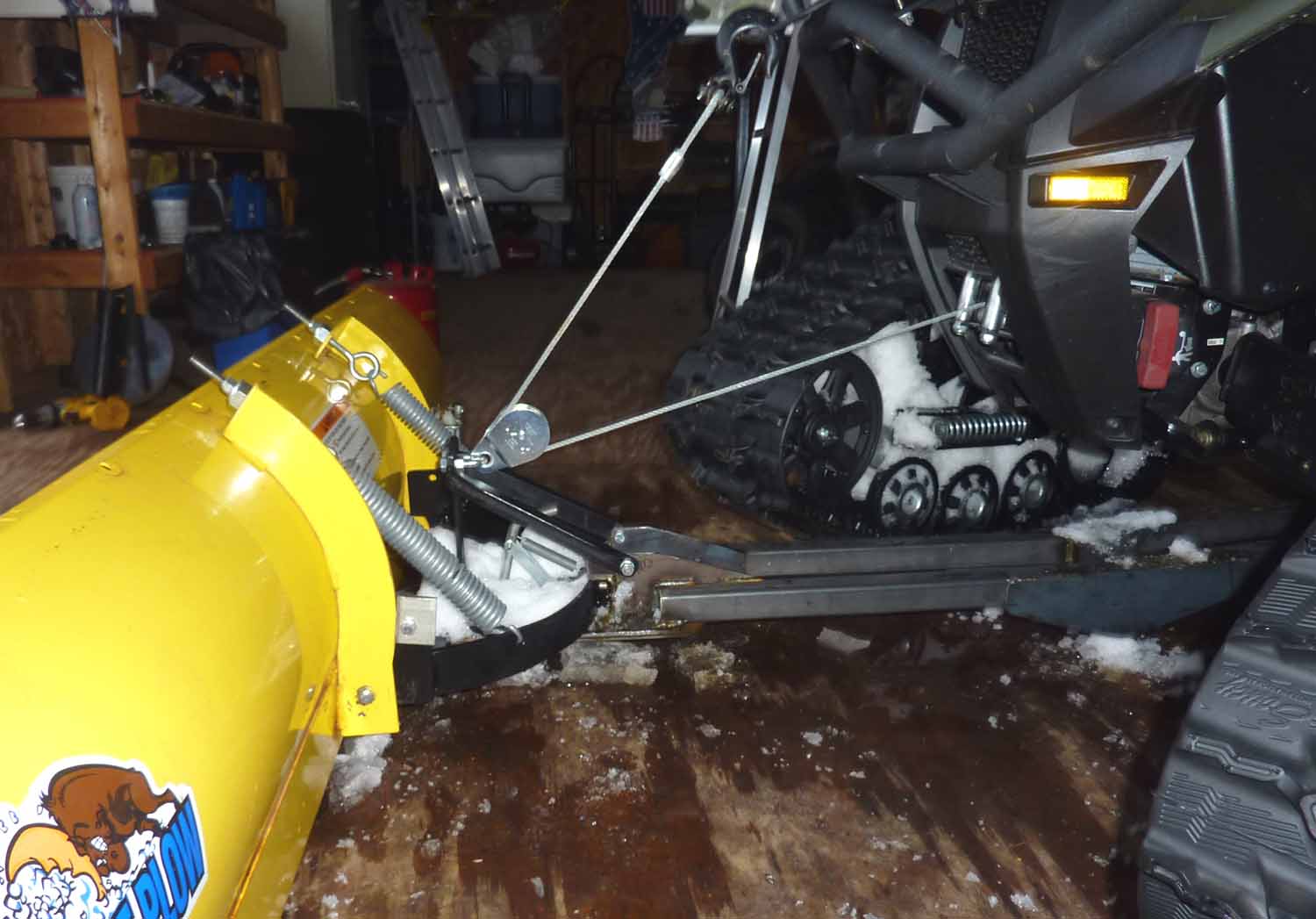

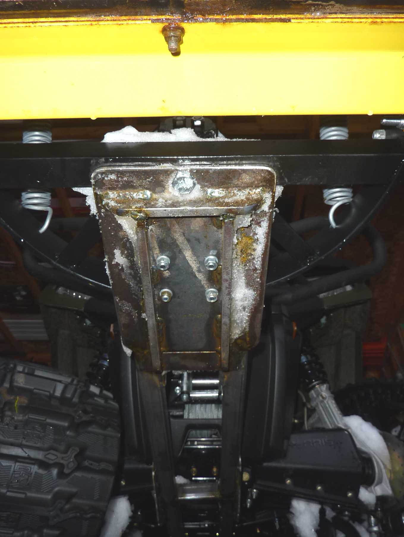

Here is photos of the cable lift system which I plan to change to flat belting in the future. In the 2nd one, you can see how 1x3/8 flats were welded to the bottom push/pivot plate and the rest of the push frame was reinforced. The Moose frame was bent, broke and trashed! So I'm trying to beef it up compared to how they did it.
Sorry about all the snow in the photos.

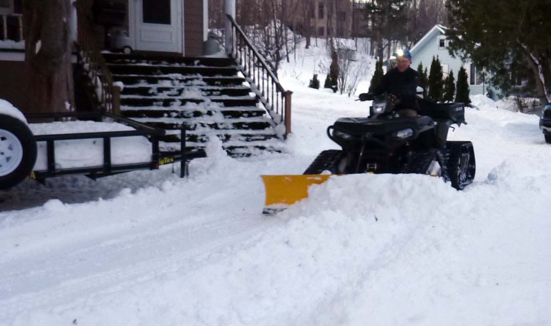

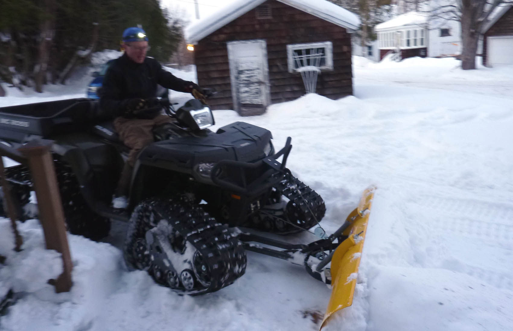

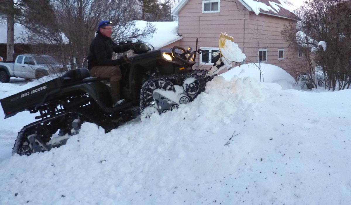

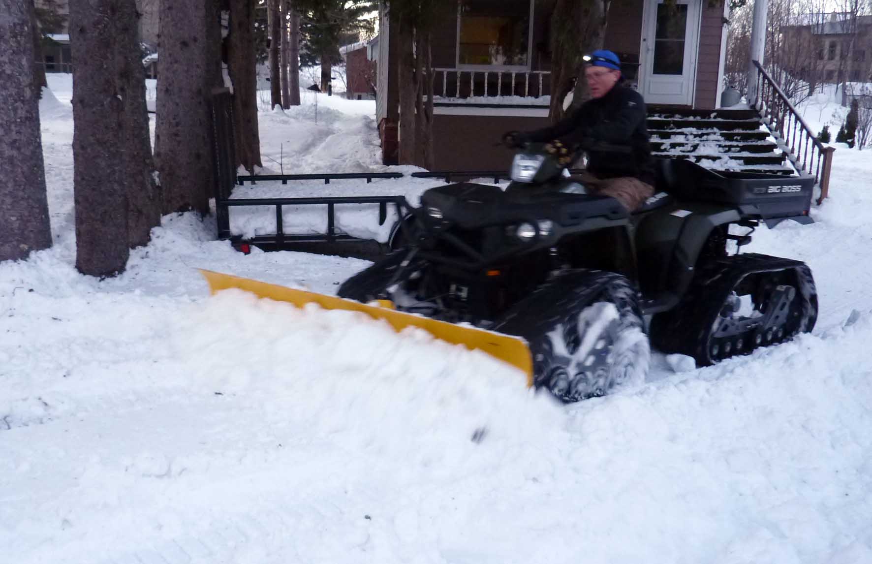

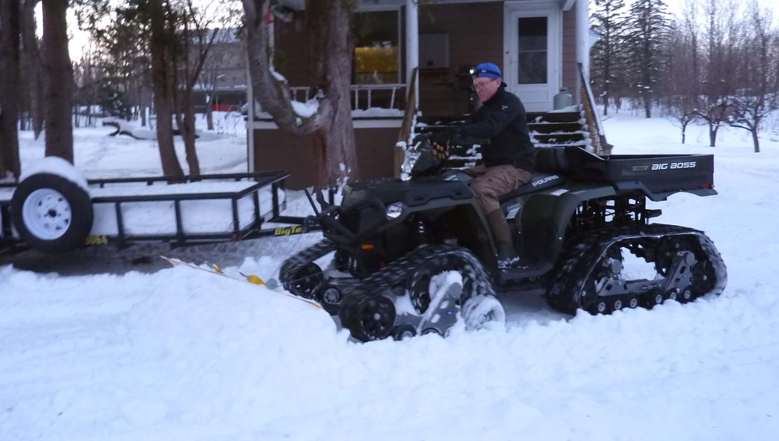

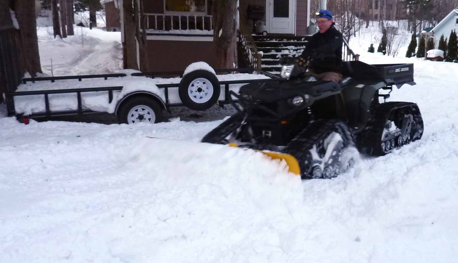

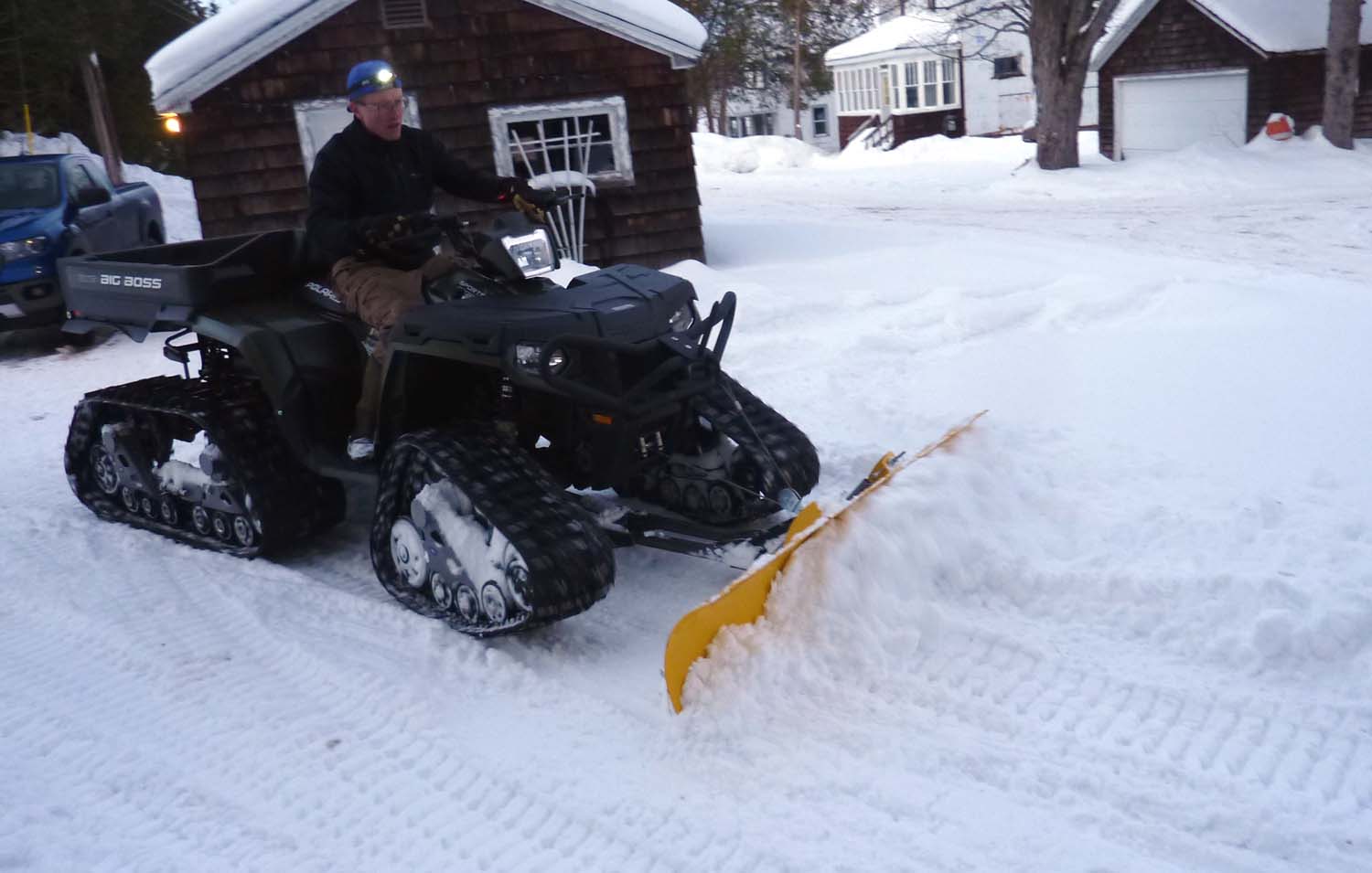

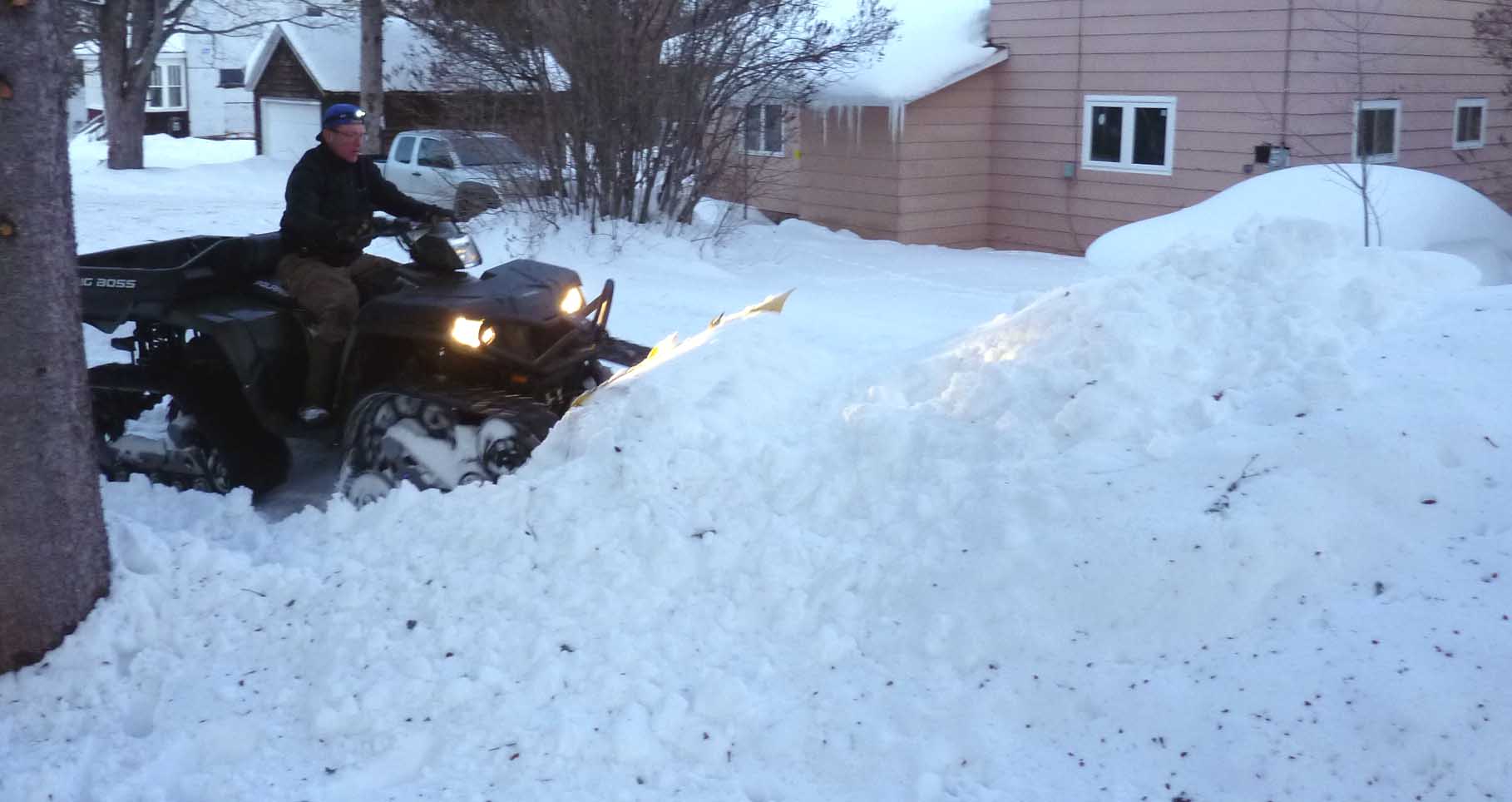

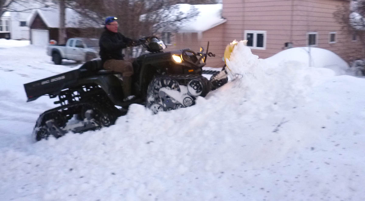

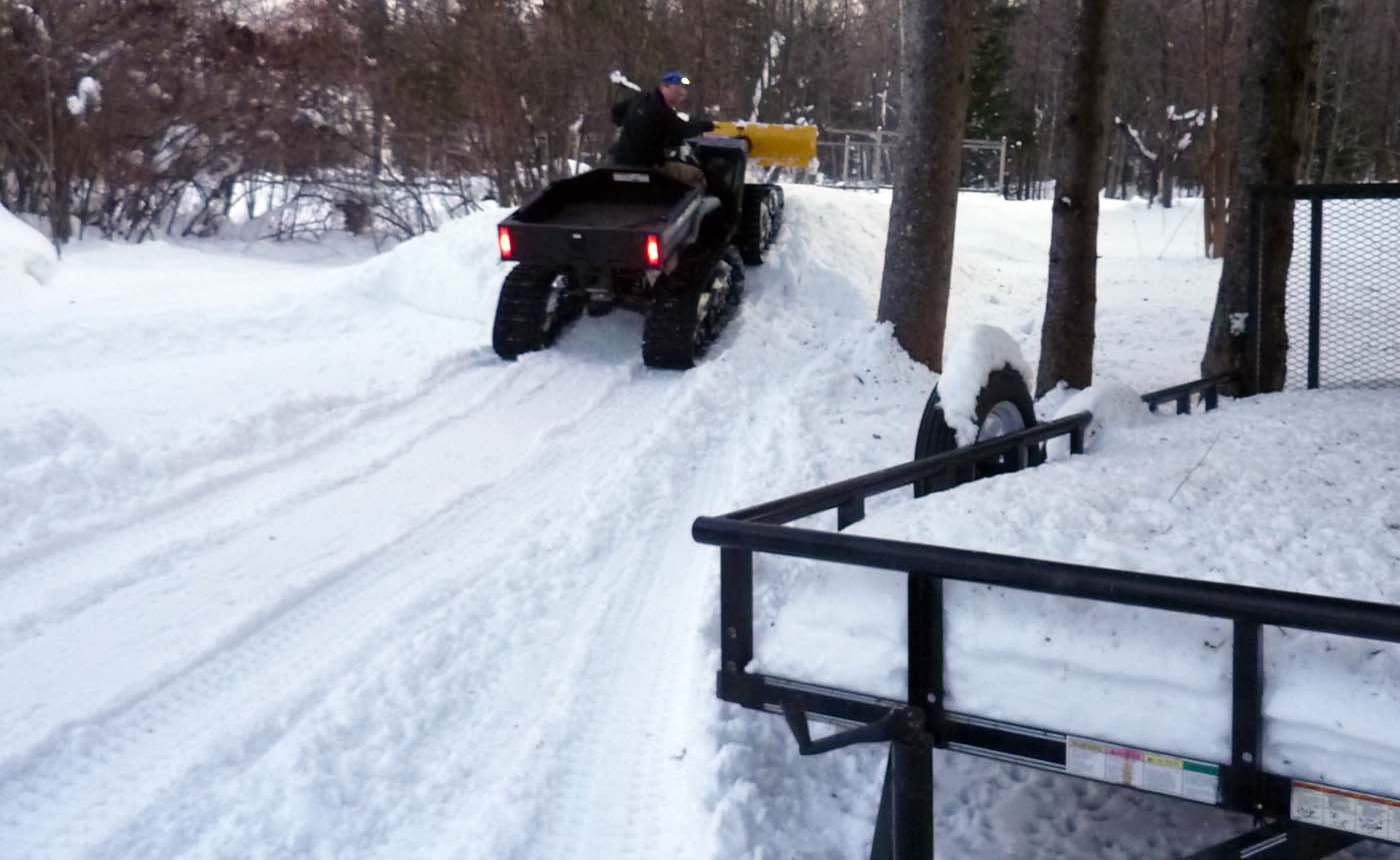

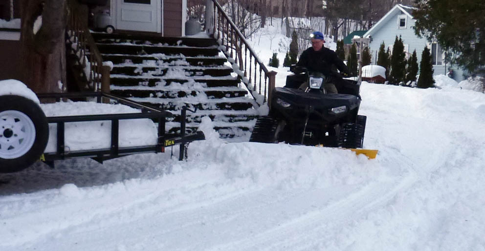

Over the weekend I was pushing snow in the yard because we thought we might need the trailer. I've got more work to do with this setup but the pods will take the machine and snow its pushing right up snow piles. These photo were taken at dust and most are live so much blurring occurred.

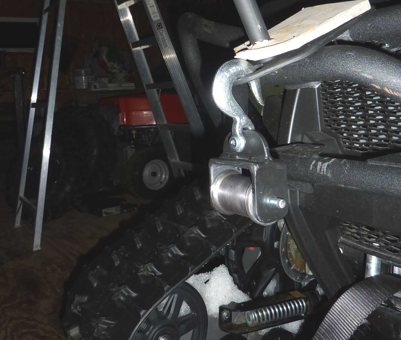

This is the strap sheave but it does not work, since the strap rolls out of it asap. Seems like the hook needs to be welded on making it a solid attachment. Maybe turn the sheave more making its flanges taller. What do you think?

A deeper cut sheave might be the answer, Arlyn. You might try using steel or aramid fibre cable and a cable sheave. If the belt doesn't work. Have you seen the belt jump/twist/roll off the sheave. Does it only happen when raising/lowering the blade. That's a simple raise/lower mechanism and should work well.

Rolf! I was going with the flat tow strap because they are easy to change, don't cost much and folks using normal steel winch cable for plowing, break them ASAP. Guys who had switched to a flat strap loved them and said they lasted much longer. :confused3:
/ B Boss 6x6 plow setup #17
Never though of that. Yes, a nylon strap will have a degree of "give". Steel cable, more of less, will not.
Easy for me to speculate here. The inch of snow we got three day ago is all gone. I would imagine your lake effect snow simply continues to pile up.
/ B Boss 6x6 plow setup #18
I suggest making the roller with a concave or V face so the strap would tend to be self-centering.
/ B Boss 6x6 plow setup #20
Great idea, why not use a roller from a boat trailer? These strap setups are commonly used on winch systems on a boat trailer.
