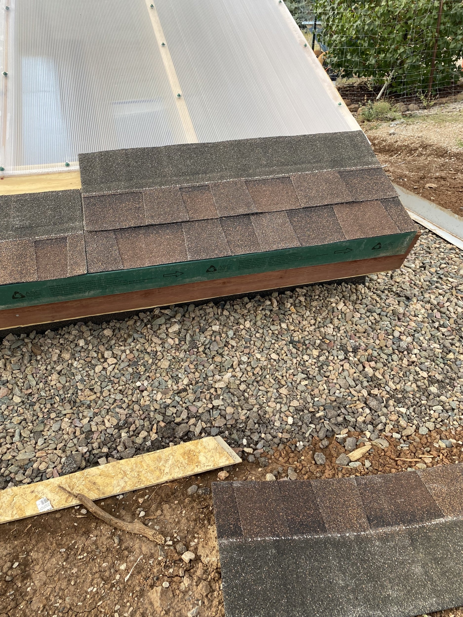

I went to town today to get shingles. After I got back I put the felt paper on the top part. Kind of windy and not very warm (53 degrees), so that was a lot of fun. NOT!
   / AZ ranch
#1,452
These are the shingles. I just have them laying there to see what it looks like. I haven’t done the felt on the lower part yet.
   / AZ ranch #1,453
Maybe I'm not seeing things correctly, but I'm thinking you need to "tuck" those bottom shingles under the polycarb. Or make a flashing and silicone under the flashing. You have to keep the runoff off of your wood.
   / AZ ranch
#1,455
Yes, the felt and the shingles will be over the poly on top and under the poly at the bottom. Like I said, I just laid them there to get a feel for how it was going to look.
