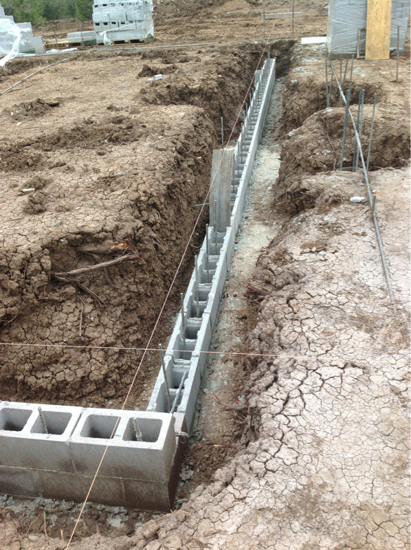

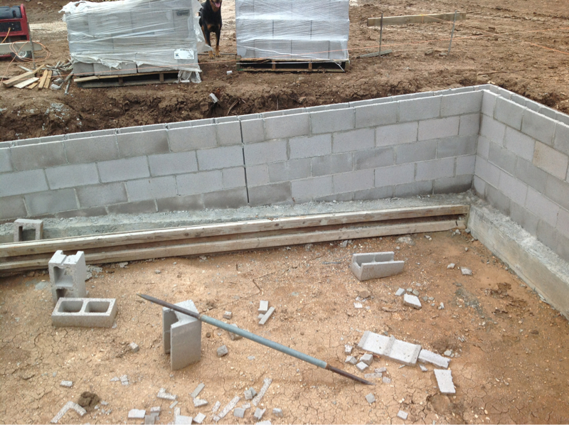

#399
A couple pictures of the progress.
/ AZ ranch #400
What is the reason for the sloped footing? It looks like a pain to trim the block to fit.
