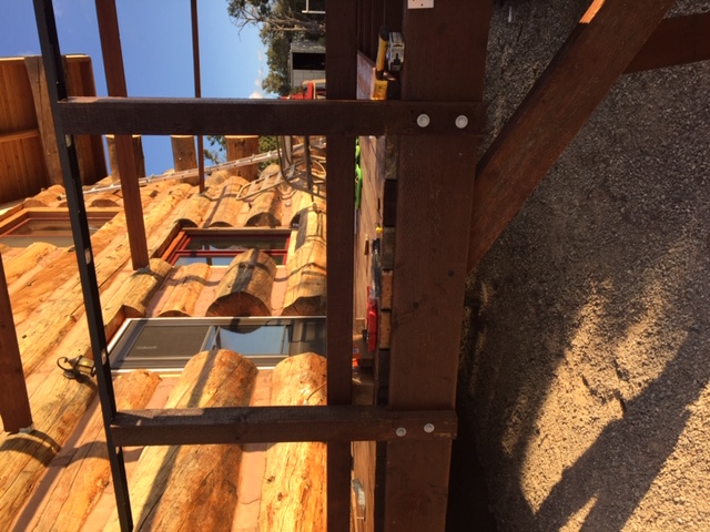

The ones I got are “Structural”, as called for by the engineer. He said to use them on the diagonal bracing for the deck and for securing the 2nd floor ledger board to the house log. It’s hard to believe that they are replacing lags. They look so skimpy. But they are easier to drive in.
The engineer did not do any of the drawings for the railing or he might have called for them there too. I may use them to attach the upper and lower railing to the vertical posts yet. I used big bolts to attach the posts to the Rim Joist though. That may be enough to satisfy the industrial look I like.
/ AZ ranch
#1,187
Here are the bolts in my railing posts that I prefer over the structural screws. If you look closely, you can see structural screws holding that diagonal brace.
