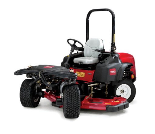

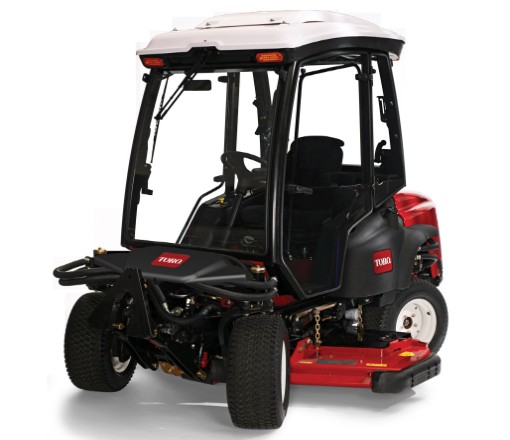

TORO has one, the Groundsmaster 360 Quad Steer 4WD.
With cab.
Quad-Steer™ True All-Wheel Steering
All Season Permanent Safety Cab with AC/Heating
Kubota® 36 hp (26.8 kW), 4-Cylinder, Liquid-Cooled Diesel Engine
183 cm Width of Cut in either Side Discharge, Rear Discharge, or Guardian® Recycler® Configuration
Toro | Groundsmaster® 360 Quad-Steer

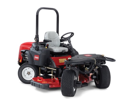

View attachment 397342 View attachment 397344
With cab.
Quad-Steer True All-Wheel Steering
Kubotaョ 36 hp (26.8 kW), 4-Cylinder, Liquid-Cooled Diesel Engine
183 cm Width of Cut in either Side Discharge, Rear Discharge, or Guardianョ Recyclerョ Configuration
Toro | Groundsmasterョ 360 Quad-Steer
I liked the looks of this so much that I just had to look up the price. OUCH!
