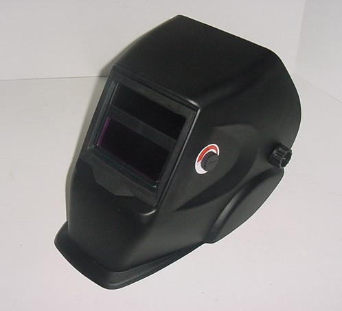

well, maybe I'm the odd one here, I got one off ebay for about $80 to my door, and it is a little on the cheep side. Lightweight and a ~3"x2" viewer. It is adjustable on the outside of the helmet so that you can adjust it during the arc. It has a plastic outter view window that does get pitted over an extended time.
But for my useage, non professional, it's purhaps the 2nd best tool I've got. I've been able to strike the arc exactly where I need it to start and restarts are right on the money also. Mine is a 1/20,000 sec with no batteries to change.
BTW I also saw this same helmet at Agri-supply locally.
