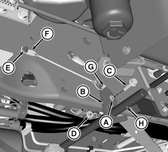

I bought an X734 John Deere last summer.....the deck is a 60", and the auto-connect unit was an "add-on"......I got no instructions on what to do with it in the fall when you disconnect to install front PTO driveshaft for the snowblower. I did decide to not only disconnect it, but remove it for winter.....would be nice to have the instructions w/photos on how to re-install it in the Spring ....can anyone help?

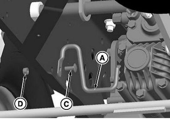

it's hard to find these instructions. removing the auto pto is a good option,
but it can be done without.
there is a hook on the right front side of the transmission that you can hang
the auto connect pto shaft on to get it out of the way of the snowblower front
pto shaft
then there is supposed to be a small "C" clip to hold the lift arm assembly up tight
to the tractor frame . (you can also use the highest mower setting)
this "C" clip is on the left side , outside, of the frame just in front of the left rear
tire. it should have a small pin with a circle ring on it to pin it to the frame once it's
holding the lift linkage up.
(sorry i don't have a picture of that)

ok so i found the picture of that latch mechanism:
thanks Dutch....these pics help a little....if I find more I'll post it here.....got on ****************.com, and ton's of talk on there, but all about scuts with auto connect and not much there either.....lot's of questions though....Edd appreciate your help
Dutch.....where did these photos come from.....my dealer helped a little, but not like this.....were there more photos/instructions related to this...pix of the whole unit, coupler itself, and under the tractor???? Again thanks, Edd

Edd they are just captures from the manuals for the autoconnect and the
front pto kit. (dealership employee) . it wouldn't be a bad idea to have the full
set of manuals for your equipment, some are online but not generally printable..

That's what I'm talking about....I have the manual for the front PTO kit, but got nothing on the autoconnect...did find your photo of the latch plate in the Front PTO kit manual. Just would be nice to have whatever comes with the autoconnect kit....you get something on the simple stuff like the clickngo wt. bracket, the front hitch for the snowblower which is simple....we're talking about autoconnect, where you could drive over the deck and screw something up if you haven't got everything set up right. I haven't been able to get what probably came with the autoconnect kit. My dealer sent me some stuff, but not really what probably came with this unit????
