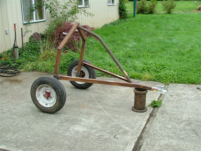

Ah-hah! (light bulb goes on). I now see the beauty of your creation. It was the one picture that I didn't see before...the hinged lever that raises the log.
I still think, though, that you might get better performance (ie. heavier logs and better maneuverability) if the weight of the log was centered between the wheels.

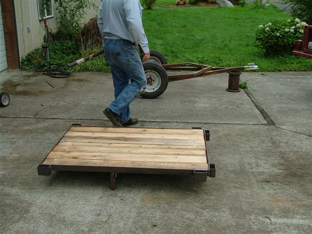

You folks motivated me to build one this weekend. I had enough stuff laying around so wasn't out anything but time. I made a bed that goes on the arch so it can be used as a trailer and dumped by the winch. My son came over a bit early so that part isn't on, but you can see how it works.
