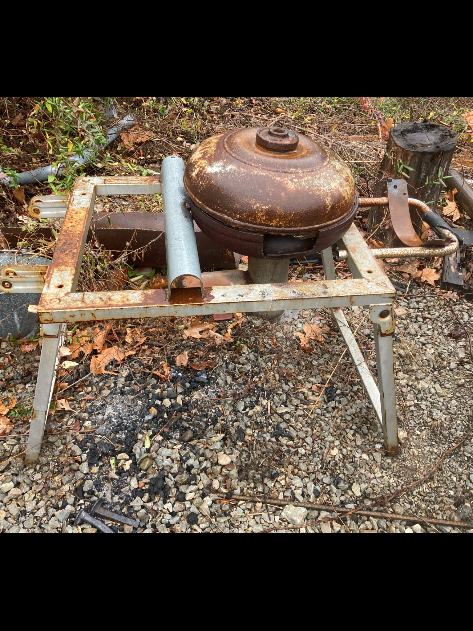

Mine’s very crude, frame is from an old table saw.

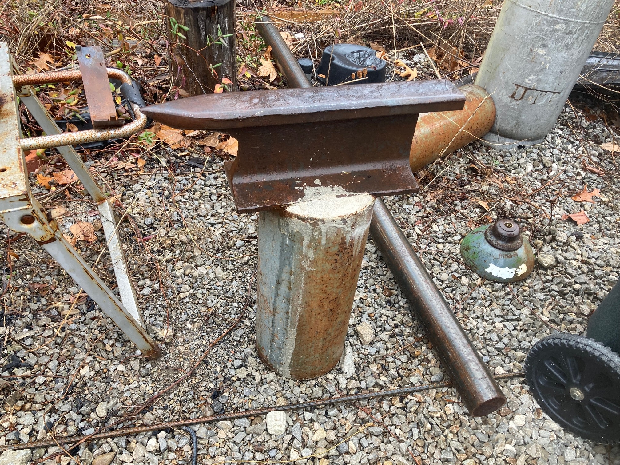

After the forge you may want to come up with an anvil, here’s what I came up with for mine.

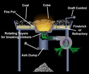

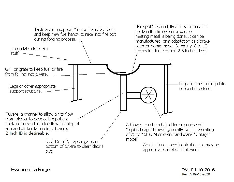

Lots of ways to build a forge.... It has evolved over the last 2000 years up to about 150 years ago when the design finally stopped evolving.... Suggest you do more research on forge design..... Someone mentioned a propane/gas forge but consider you can only heat what will fit inside froge opening, where as with a open coal/coke/charcoal forge there is not any real size limitation.... There is a really good site for blacksmithing and forge design on facebook for the beginner at doing work at a forge....
Here is basic concept on what a forge design should incorporate....
