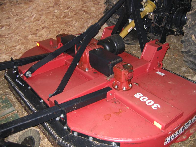

Was wondering what advantages and disadvantages of pull type versus 3 pt hitch on 8' bush hog. Have plenty of tractor, 4835 Ford New Holland 65hp engine with 56hp at pto.
I have 44 acres with slopes and drain swells
/ Attachments #2
Mike, Welcome to TBN!
I have a 3008 bush hog and it is the 3pt type. I use it with a NH TN65 and have plenty of HP to mow with (except in very tall grass, but there are gears for that) This is all the mower I want on the back of the TN (about 1500#). Makes the tractor bit lite in the front end. Better with the bucket on, but I don't like to mow with the bucket on as it can get in the way (can take out a fence row in a hart beat LOL) . Your 4835 may be heaver in the front end than the TN, or maybe able to add weights. Most of my fields are fairly level to slightly rolling so no problem there. I think there is a lot of advantage to the pull type not putting the weight on the tractor when raised. Then again, pull type make for longer and wider turns as the unit is slightly longer. Have never pulled a "pull type" so I don't have much to compare to. I am sure some on here will have better comparison for you shortly. I will say that I am not all that happy with the cut of the BH3008. I find that, IMHO it doesn't cut near as smooth as a 7' single blade does. I for one would not do it again. Can't say it is a bad machine, it's not. I just expected it to have a better cut.
