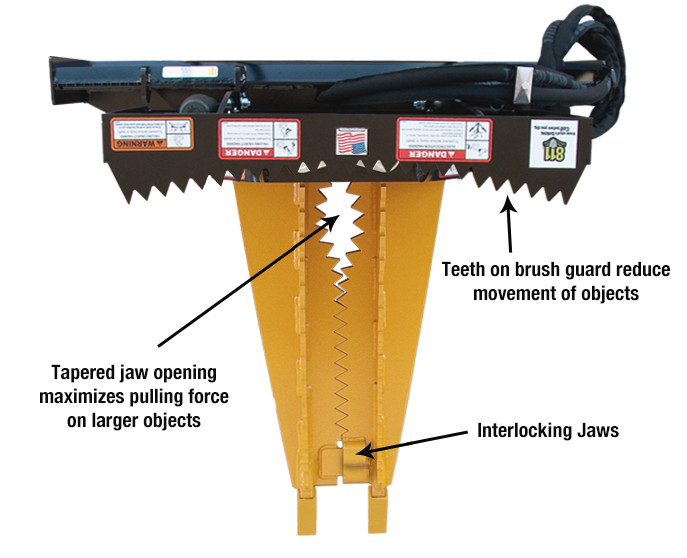

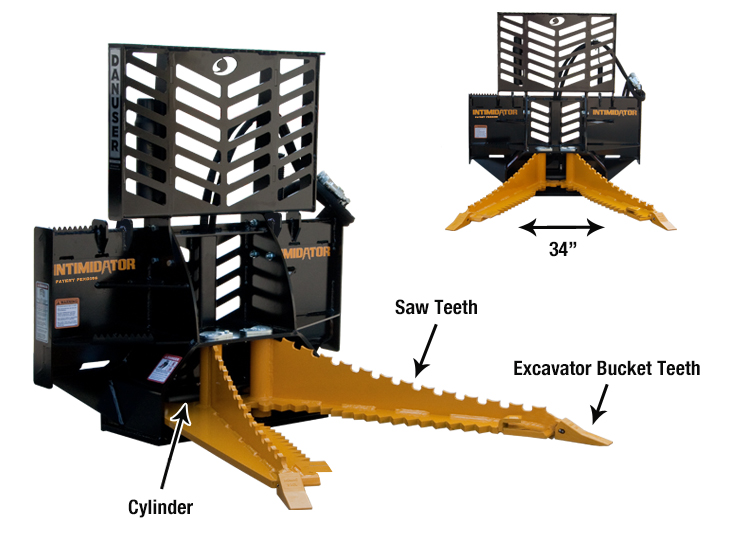

In addition to augurs and grapples: Tree puller and/or shear.
Example: Tree Fence Post Puller Skid Steer Attachment Quick Tach Bobcat Kubota Case

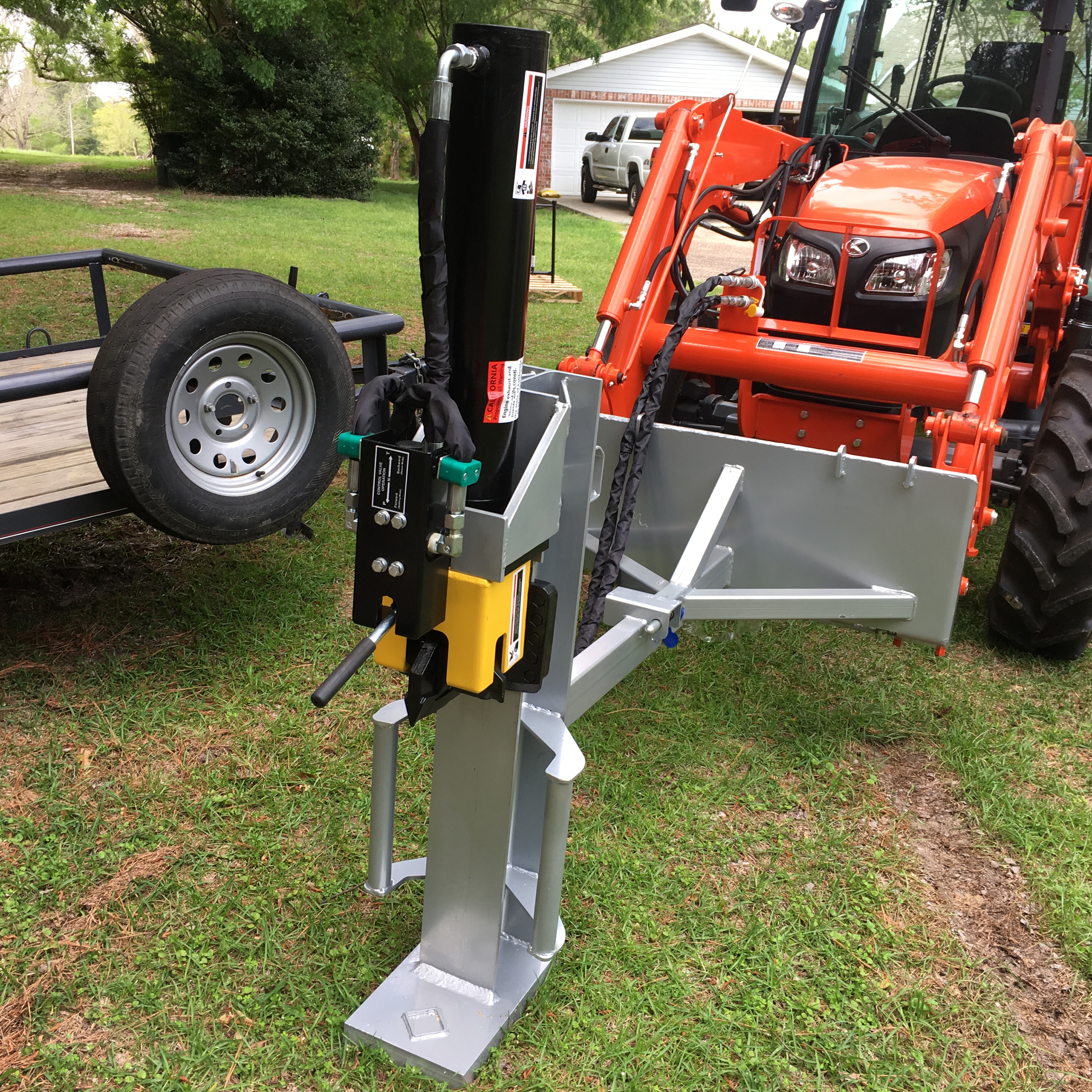

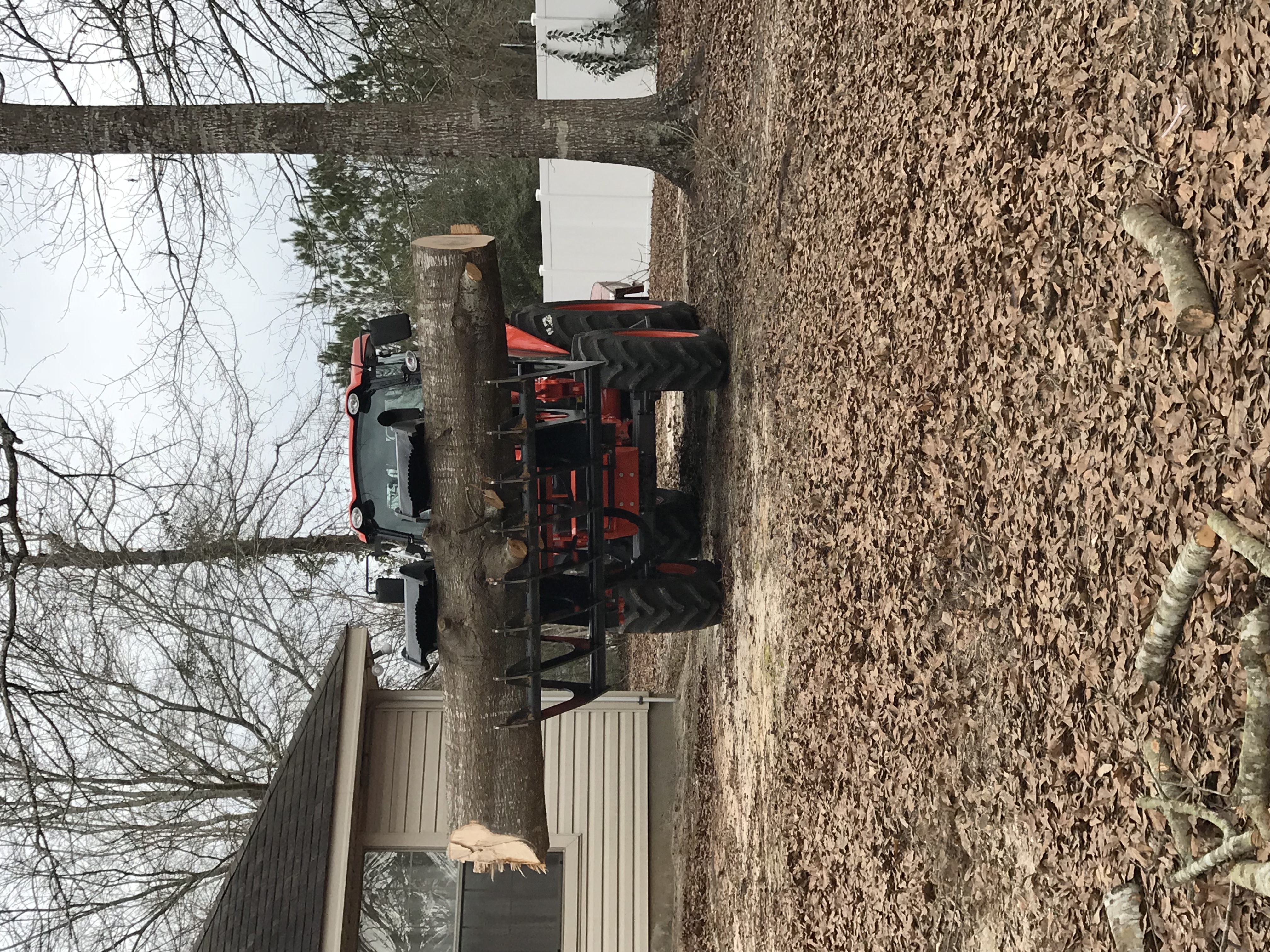

I have the grapple, Lane Shark trail cutter and a log splitter. Very pleased with operation of each one. I have 16.2 GPM flow on my tractor and 2 separate sets of hoses/connections mounted on the FEL. One set is from the 3rd function and is used for the grapple. The other has one hose from a rear SCV and the return line to the sump. That one runs the cutter and splitter.
