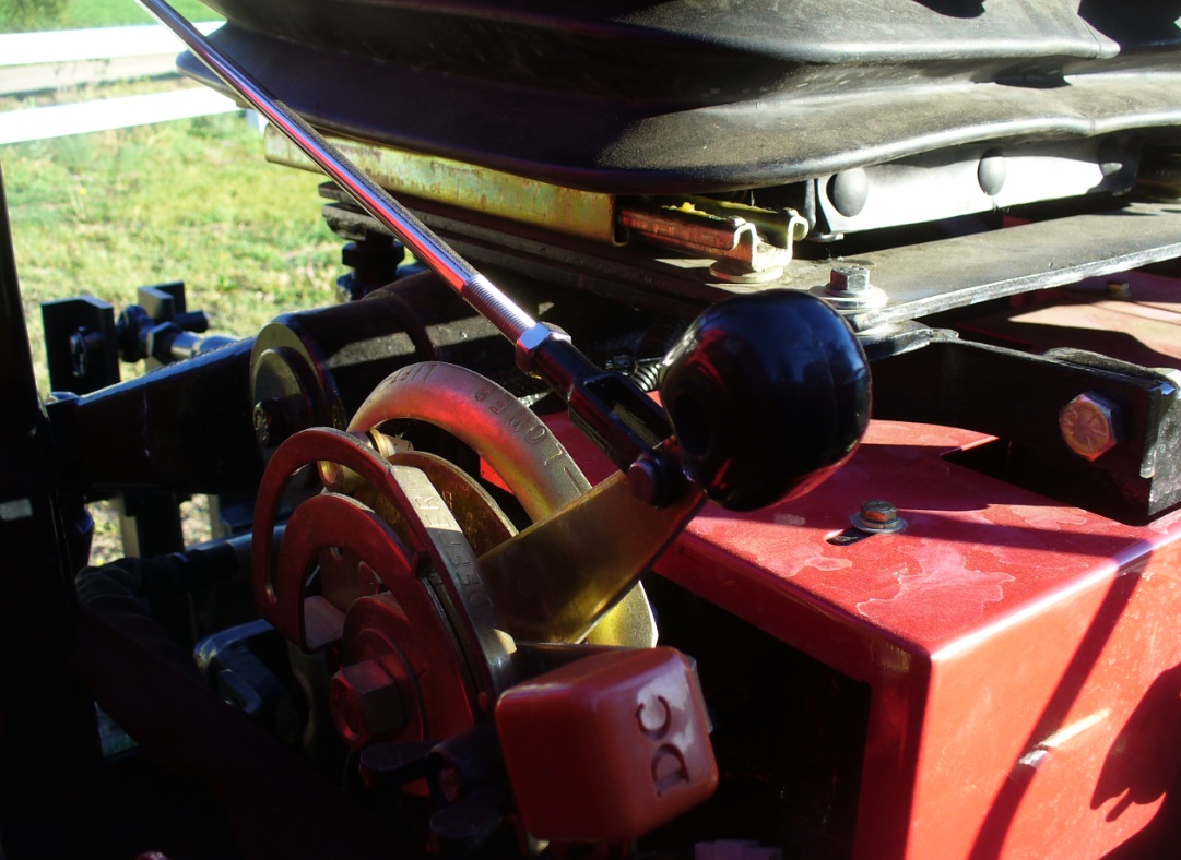

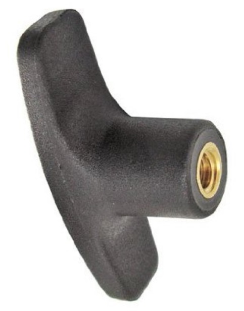

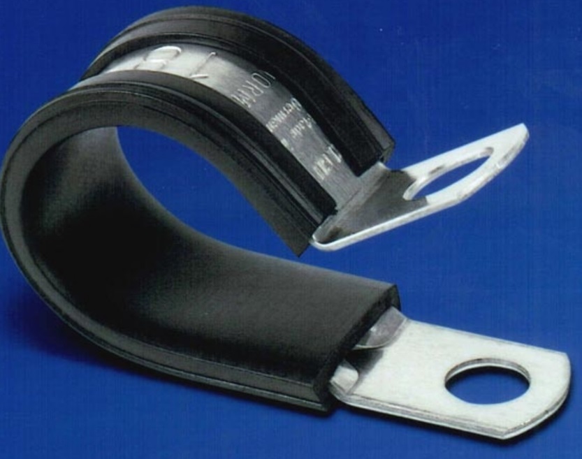

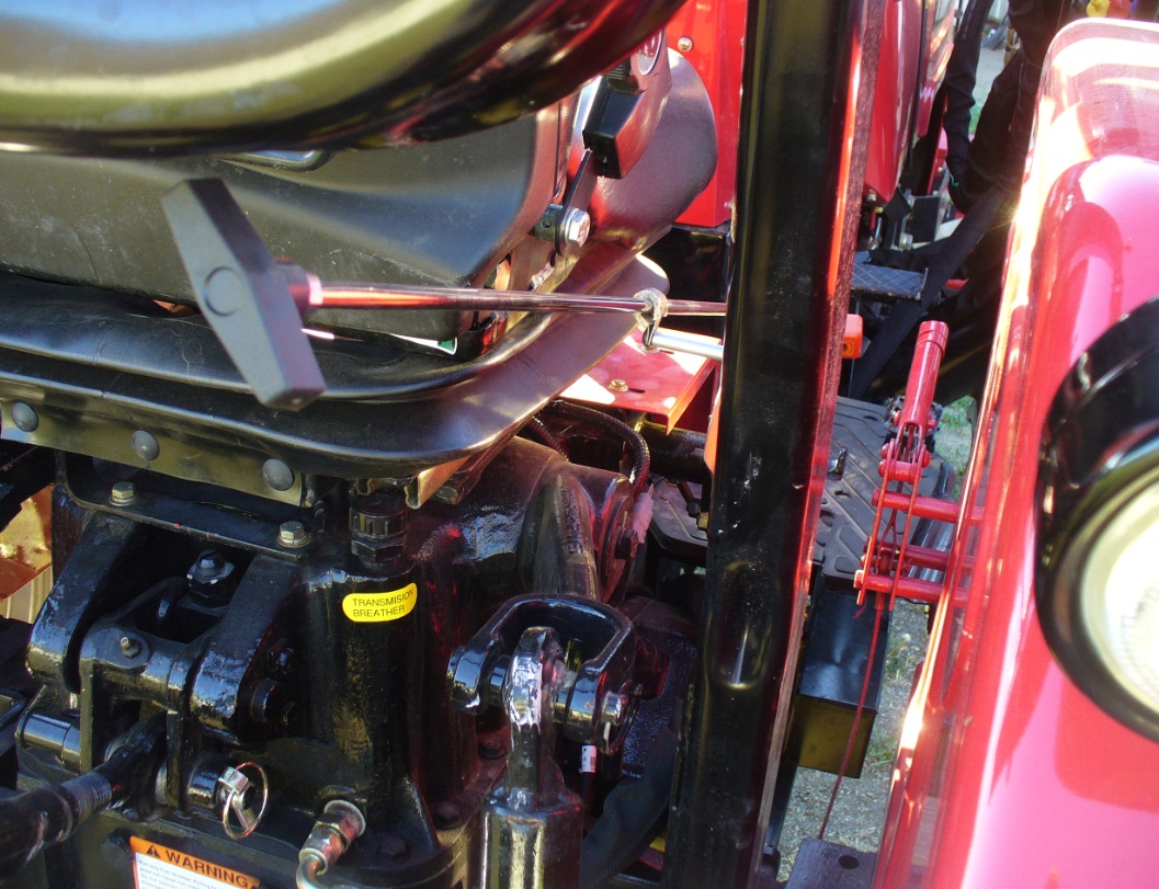

UPDATE:
After installing a prototype control mechanism and using it for awhile, I decided to fabricate a more robust system using a T handle, brake yoke and a chrome plated 32 Ford radiator support rod. I no longer have to struggle to get implements lined up. Obviously one has to be careful when moving/adjusting the 3 point while standing near the equipment while the tractor is running, but this works for me.
Here are a few pics of the final install including closeups of some of the parts used.
View attachment 382066View attachment 382068View attachment 382067View attachment 382065
View attachment 382071View attachment 382070View attachment 382069
Next project: Installing hooks and a receiver on the loader bucket and a hydraulic top link for the 3 point.

Looks good, but where can I find a chrome plated 32 Ford radiator support rod? Will a 34 do? :) Does it have to be chrome plated? :)
I think there are various Ford restoration sites out there where you could find one. The chrome feature makes it a bit more weather proof - plus it slides easier through the tubing clamp. ;p)
