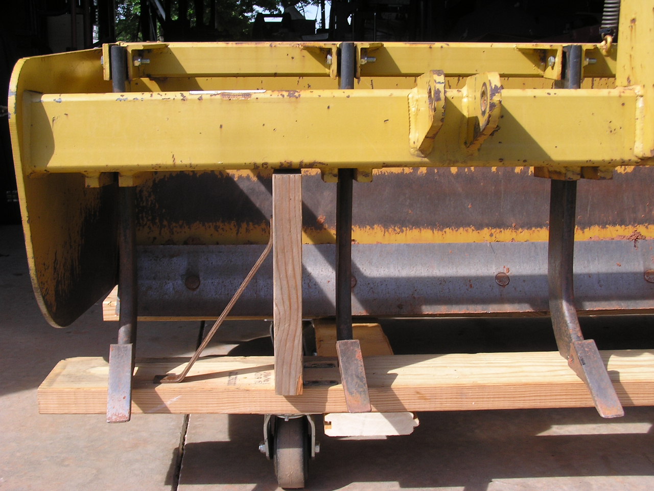

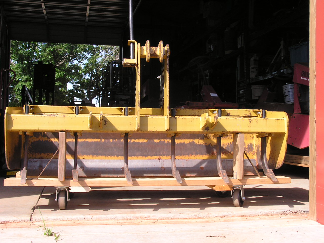

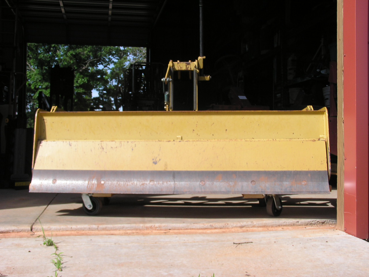

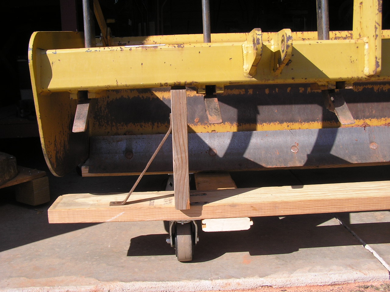

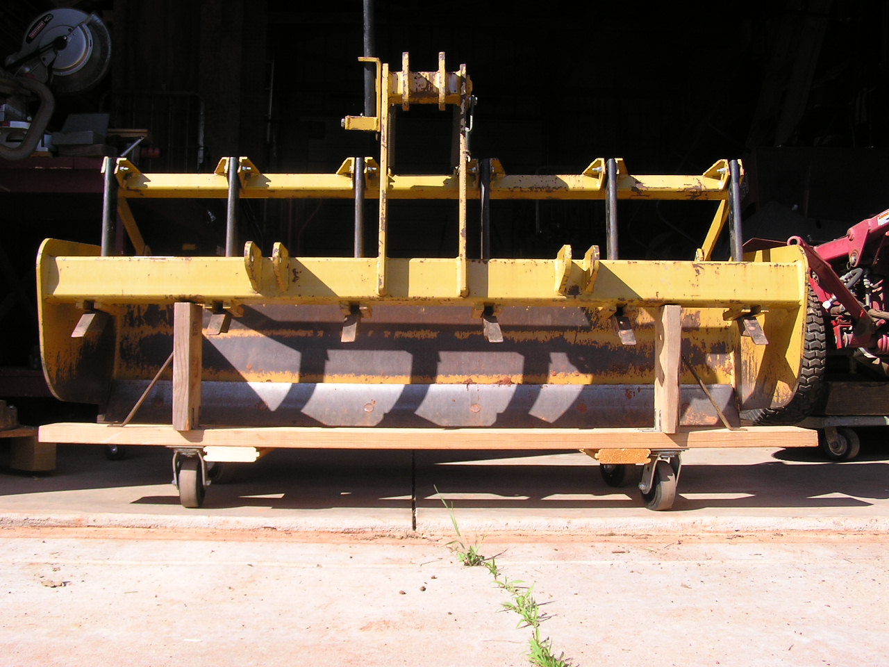

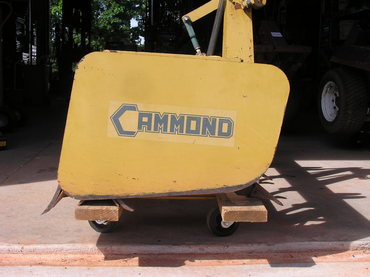

I agree that a dolly makes attaching an implement much easier. This is the one for the 6' box blade.
Rippers down.

Rippers up
