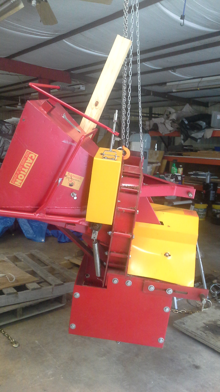

I'm using PEC's, I drop my chipper (~900lbs) on the pallet which is on the furniture dollies, then hook up my hoist for fine maneuvers if needed.
chipper-hoist.jpg.
