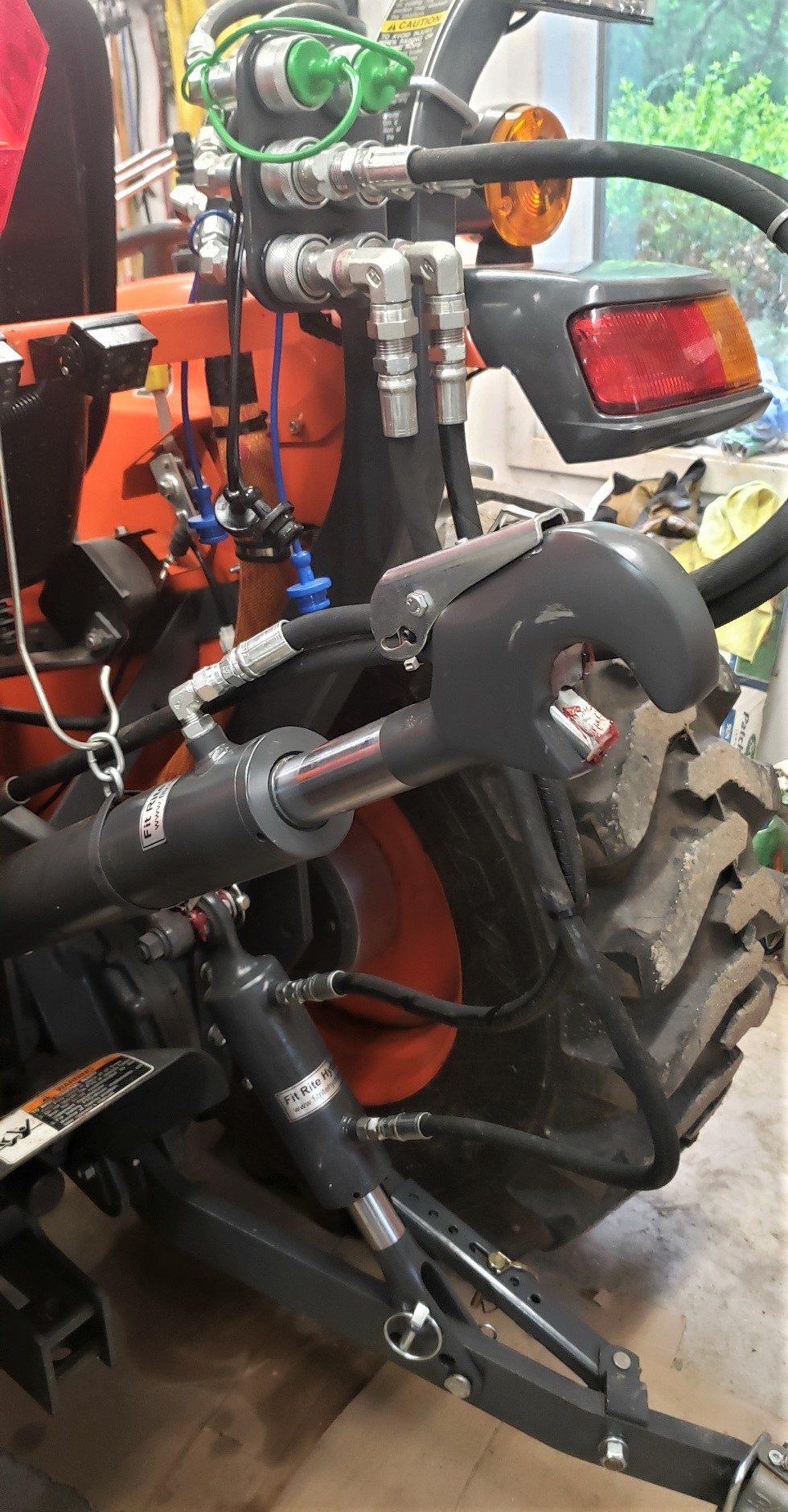

I have a Kioti DK5010 on order. It will come with extendable link arms and telescoping stabilizers. Will this be enough to replace my Pats system? (kind of promised that they would remain on my L3400 that I am selling).
/ Attaching implement with hydraulic top link #24
Some depends on your expectations. I only know that it's hard to square up perfectly and that applies to QHs as well. With what you'll get on the DK I think you'll be fine. You're going to have to lay hands on (necessary for PTO-driven implements, which I mostly use), but I find that it's not a big deal as long as you remember to come up short on the implement so that you then have room to pull the link arms out (give yourself room for adjustments). Hopefully you have a remote lever at the rear to raise and lower your 3pt: I could wish for a remote lever for the top link hydraulics, but it wouldn't be worth any added expense. The release levers on the link arms can be a pain to release sometimes (more an issue when disconnecting than connecting as they'll have weight and tension on them).
All said, I DO, however, like QH implements. I find it a lot easier to slide in pins than to pull link arms over pins: especially necessary for my B7800.

I didn’t have any expectations of never getting off the machine as most of my implements are PTO driven. Additionally several have “captured” pins with supports on both ends. I agree that squaring up is difficult especially with the minimal room on the captured end implements. You observation about release levers being hard to engage is a bit of an eye opener and rarely mentioned, but the remote rear operating lever will hopefully mitigate that. A bit of d*#king around is acceptable.
I am seriously considering a hydraulic TNT kit though for adjusting implement trim - getting to old to be cranking heavy stuff into adjustment.
Have you seen those Euro-ball hooks? Look slick but expensive.

Yup, with a PTO-driven implement you don't have a lot to gain with a QH. And even with non-PTO equipment there are ones that also require action back there: hydraulics, such as on my box blade (back blades, larger ones, tend to also have hydrualics).
It's an issue of releasing the arm extension levers (on the tops of the link arms) that can be a it of a pain. I sometimes stomp on them. Anything under tension can become a bit of a pain.
The remote 3pt lift lever allows you to be right there in the back and adjust height for connecting/disconnecting. CAUTION: you have to watch yourself as the lever action can result in rapid movements of very heavy pieces of equipment! (always think in terms of an "out"- how to position such that you won't get caught/pinned)
I like the idea of the Euro-balls, but I couldn't see there being enough value to justify their expense. I also feel that pins, as much of a hassle as they can sometimes be, provide a much more secure connection: home much more secure is the question, and I'd figure that since the Euro-balls are in widespread use they're ample enough.

All my implements are Cat 2. They all sit out in the orchard, except the Wally chipper, on their own pallet. I do not have any brand of quick hitch - I do have extendable 3-point arms. It's not that bad. Back up real close & use the extendable arms.
I can't hold up the hydraulic top link and reach the activation lever. Use a short rope to tie up the top link. Start the tractor - extend the link.

Pat's quick hitch and hydraulic toplink on all three tractors. Easy to hitch, easy to use. Would not have it any other way.

I have PATS and a Hyrdo top link too. Love this for hooking up to the many different implements I have.....and it makes tweaking the implements engagement with Mother Earth a pleasure instead of a PITA. I frequently have adjusted my disk and planter, etc with the top link to get the best performance. Easy Peasy. Just bought a 3 point No Till grain drill too.....and they can be fussy to adjust. The hydraulic top link is allot of bang for the buck....IMO.
