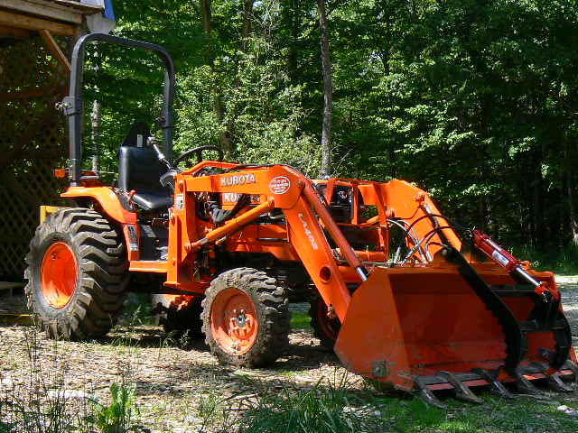

I have a Tatro bucket grapple ($400) and a WR Long loader valve kit ($600) that I use all spring, summer and fall moving trees, logs and rocks.
I love this implement and have found many uses for it. For $1000 it was a good investment for me
