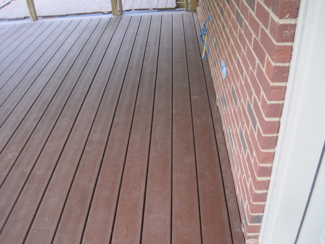

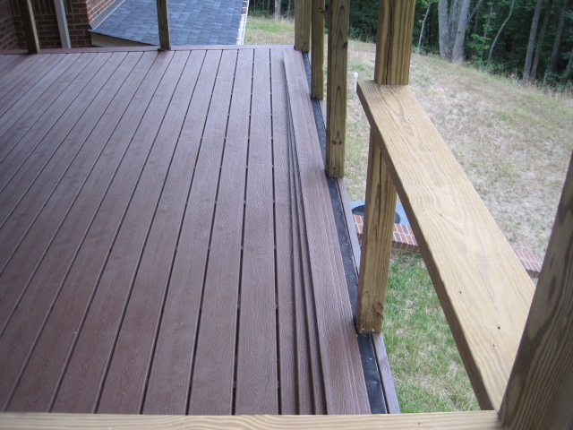

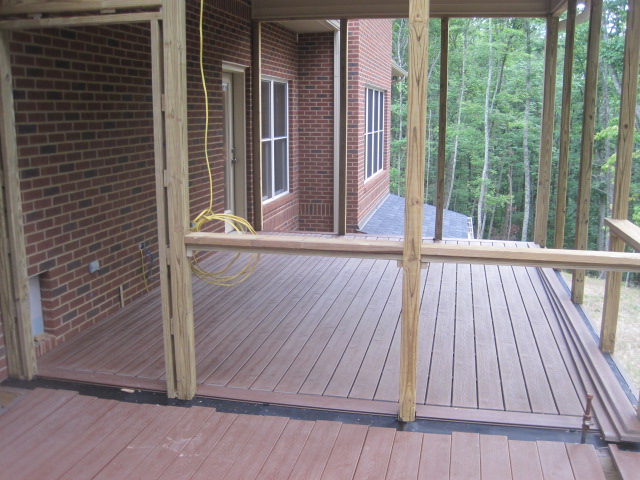

The back porch is starting to look like a porch. The decking under the porch roof is almost all installed except for the outer board that goes around the posts on one side of the deck. The boards on the deck are just lying there. They are not installed. Other responsibilities and the 90+ degree temps we've been having have slowed the porch progress the past two or three weeks. It's tough to make myself work on the porch after work on these incredibly hot days. This weekend the forecast is for 100F temps.
