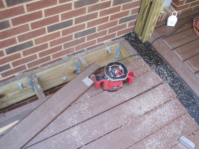

I installed some angle brackets to provide some lateral support to these 6x6 posts in preparation for putting up wire cable railing on the porch.
The 2x6 posts were notched out 3" deep on 2 sides in order to install the double rim joists. Unfortunately, when you remove 3" from two sides of a 5 1/2" post, you only have a 2 1/2" x 2 1/2" post left, thus the angle brackets.
After installing the first angle bracket, we found that the deck board did not lay flat on the framing so my wife routed out the bottom of the deck board. In order install the second bracket, I notched the framing with a wood chisel then installed the bracket flush into the notch.
To install picture frame deck board that overhangs the framing, we installed some angle brackets under one side of the board and toe-nail screwed the other side of the board from underneath. From the top of the decking, you cannot see any nails or screws. We are using the Trex hidden fasteners and toe-nail screwing the boards around the edges of the porch where the hidden fasteners don't work. Using the hiddden fasteners takes much more time to install than using a nail gun. I would probably be ok with using a nail gun but my wife didn't like the nail gun approach or screw from the top approaches. Happy wife - happy life!
   / At Home In The Woods #4,190
Most of that plactic wood, the screws will "burn" into the wood when counter sunk and the plactic will kind of "heal" around it. Still blemishes but no heads visible.
You should not have a problem on a screen porch in the shade but those plastics are know for failure and looking horrible in the coming years. I work for a federal agency. We "own/maintain" lakes (should give you an idea who im talking about). We put "plastic wood" on many of our courtesy docks back about 4 years ago. It was a company now out of business and made it out of recycled plastic. Long story short all those dock have either be re decked/condemed or on a list to be repaired. Many of them (at least 2 I know of) have had folks actually fall thru the decking (possibly the company over exadurated span length). But its flaking up all over the place as well. I have heard others who have actual Trex brand say they never again will buy or use it. Its ugly dosent look right and does not wear like they say it does. This is mostly in exposed deck situation or on docks. But the ones i know of with it on a dock will go back with AL. I think we will go back on govment docks wil AL. Should of done it in the first place but the wanted to look "green" well now were stuck with tons of defective product that has give half the life that wood would have given.
Yours should be fine in an enclosed porch with shade though?
