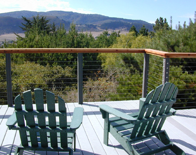

We are planning to use horizontal wire railing on our porch and deck. We originally were going to install standard vertical spindles under a wooden handrail for railing. However, we got concerned that the spindle railing would ruin the view of the woods from the porch and from inside the house. That's why we decided to go with the wire railing. Now we have some PT wood we no longer want. We've had it too long so we can't return it to the building supply store. When we are finished with our porch project, we'll be selling some PT wood.
Here's a picture of a deck using cable railing.
attachment.php
However the stuff in the picture uses stainless steel cables and is very expensive. Instead, I'm considering using this black galvanized 12.5 guage cable used for fencing. I could mount the cable ends to the posts using eye bolts and turn buckles. I would drill holes through the middle posts and run the wires through them. If any of you guys have had experience with this stuff, I would appreciate input.

I think the cable will work fine. You will want the cable taut enough to prevent a child from sliding through; but not so much tension that you end posts begin to bow. If you can hear a tune on the wire, probably too tight for wood posts.
