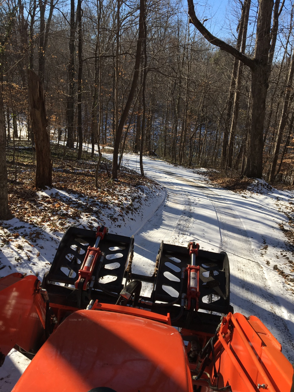

Had friends that bought property off the Cherohala Skyway (The Dragon). Had a cabin built and new to tractoring. First bought a used B20 on my recommendation then in a few years upgraded to a new B26. Maintain long steep driveway, sometimes forest road access and many building projects etc. Big difference in capabilities and price between B26 and B2601. Meets their time and DIY needs.
We also use a B26, ballasted, wheel extensions, and love the little rascal on our hillside farm. Prefer the R4 tires as it is our lawn, orchard, and berry patch mower.
Use M59 for most driveway maintenance. The B26 could do it but the bigger tractor can do it much 8-10X faster. Can dress the 1/2 mile driveway with 6’ land plane in 30 minutes. Take a half day+ with B26.
Hard enough trying to figure out the best equipment options for yourself. For someone else it is always a hard guess.
