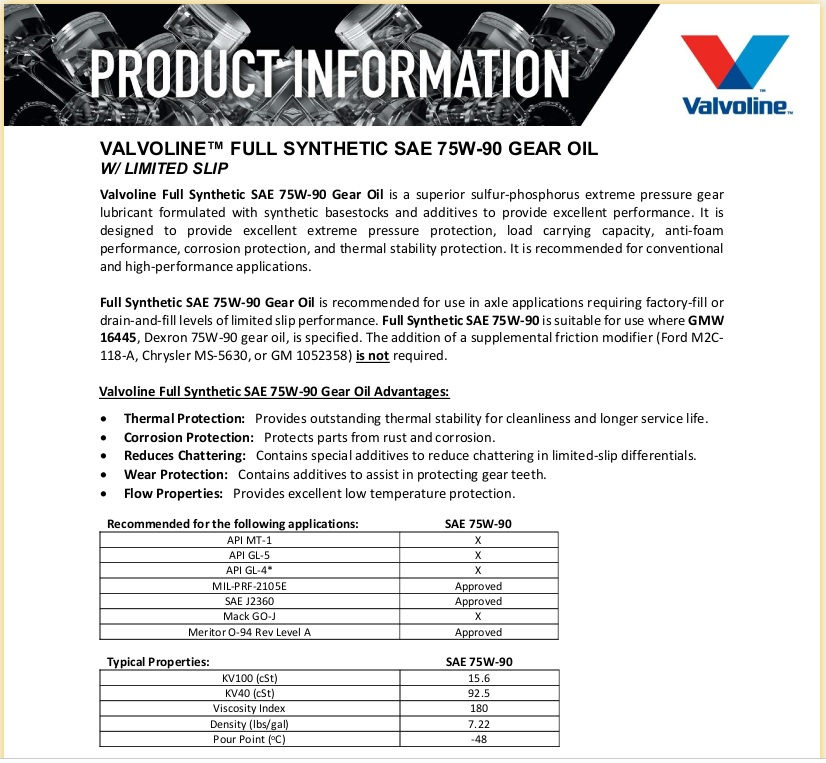

I haven’t changed the front axle oil yet. If I go with gear oil can it have the limited slip additive in it? I was killing time at Walmart waiting for my kid and they had this stuff. I didn’t get it yet because I wanted to make sure.any thoughts?
Valvoline FlexFill Full Synthetic SAE 75W-90 Gear Oil 1 QT Pouch https://a.co/d/7MJ2OjQ
/ Approaching first 50 hours #13
The Valvoline is fine, but does require 4 quarts for a full front axle fluid change.
