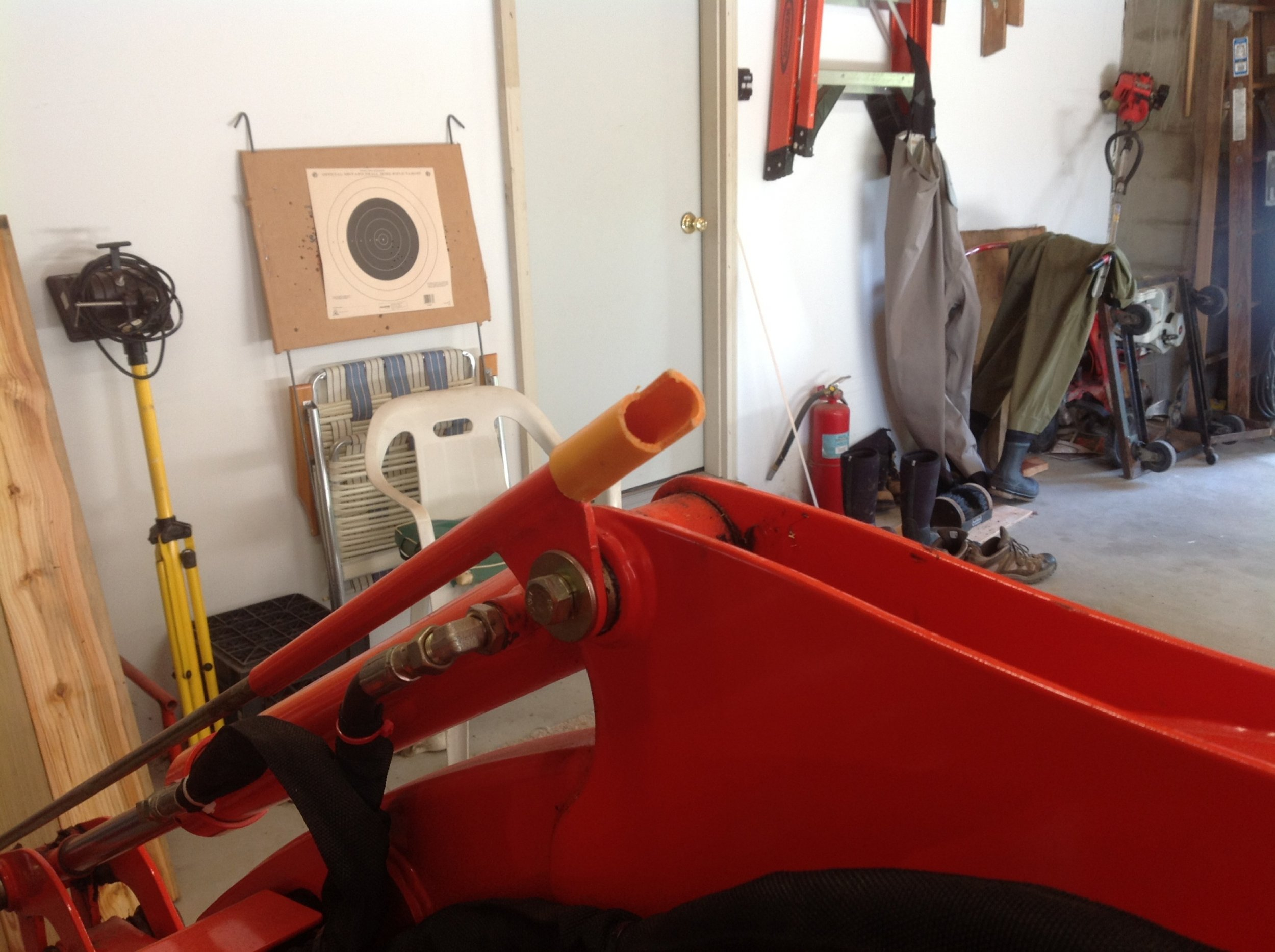

My bucket level indicator at level still has about 2 inches over the top. I don’t see how to adjust it. Is it meant to be cut flush at level?

They are meant to be cut flush.. However, might I recommend using different colored 'band' (paint, tape, etc) to mark level for your different implements since thay are all at a different level, usually? Like a red line for your bucket, blue for your forks, yellow for the grapple, etc.. Then mark the top center of each implement with the corresponding color so you can see it from the seat.

If it's a rod sticking out of a tube temporary marks may wear off soon, but cross-holes could be drilled in the same locations. File or grind grooves in the rod to hold paint longer? I had a tube-type with a slash cut at the top of it and little slop o'all. (NH 7308) There was just enough 'tweak' between the rod's end being at the top or bottom of the slash. IMO newer NH CUT indicators are crap & too sloppy. (T-110L, other millennials) I plan on copying the older style and refitting two of my NH FELs.

My bucket indicator is a tube and rod. I had the same issues you have, and did not want to cut the rod. I put a piece of 3/4" pex with a notch cut out on the tube. With the bucket on the ground and level adjust the pex so the rod is even with the end. The notch in the pex is so you can see how far below level the rod/bucket tip is.

I have only the bucket on the loader, so I cut the rod 1/4" longer than the tube. That works good for me.

To level the bucket I just file a groove in the rod and from experience I can make small adjustments to compensate for the ground.

Great idea for a longer rod. I had one BLI that worked well with a slash cut on the tube. (NH 7308). That allowed me to tweak. Seems it'd be easier to put notch or two for that on the rod than to trim it's length.

Yup, that's what I did cut a piece of CPVC pipe to length, and it fits tight over existing sleeve.

Mine is similar but a longer tube with a slot with notches cut for different implements, bucket level is different to hay spike level
