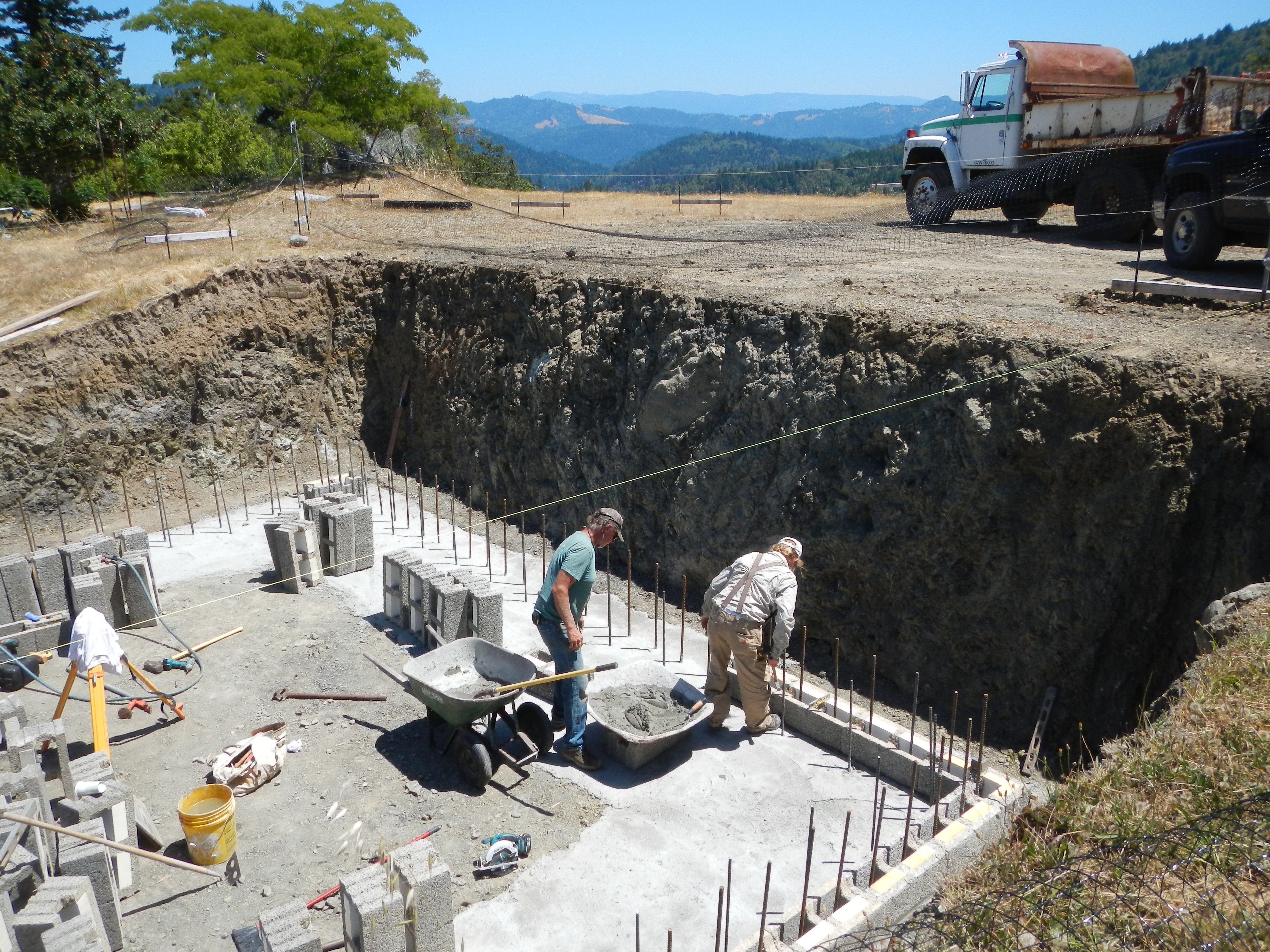

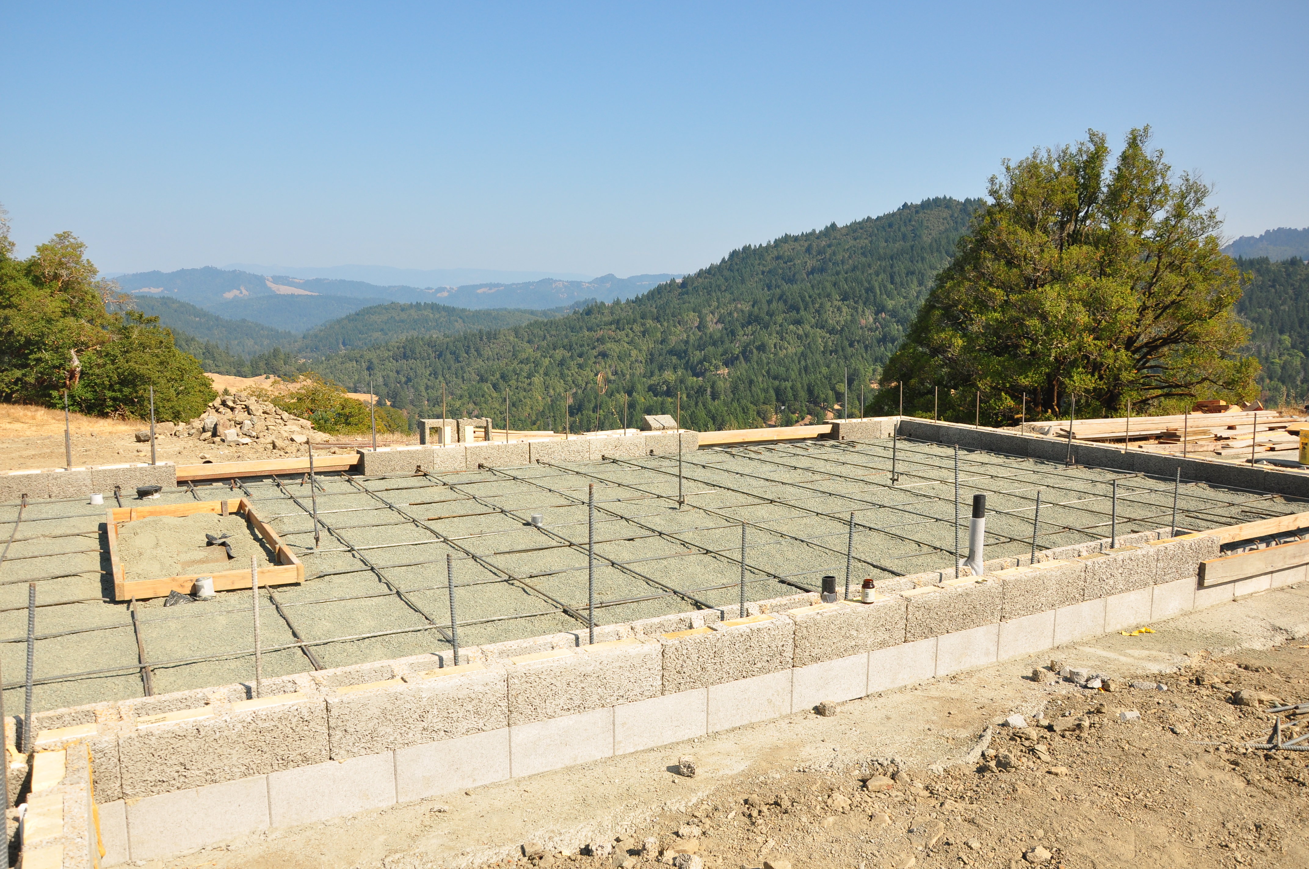

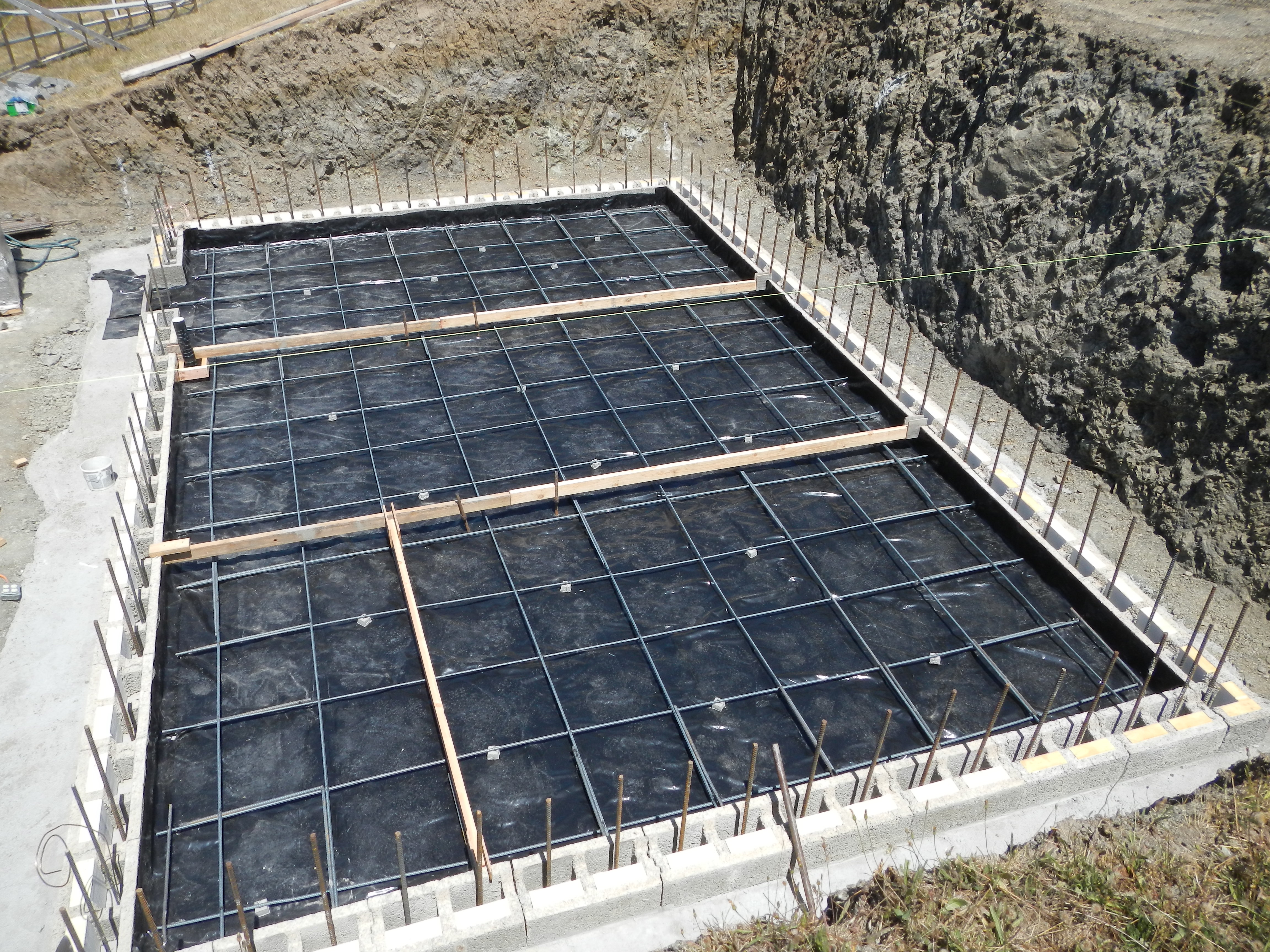

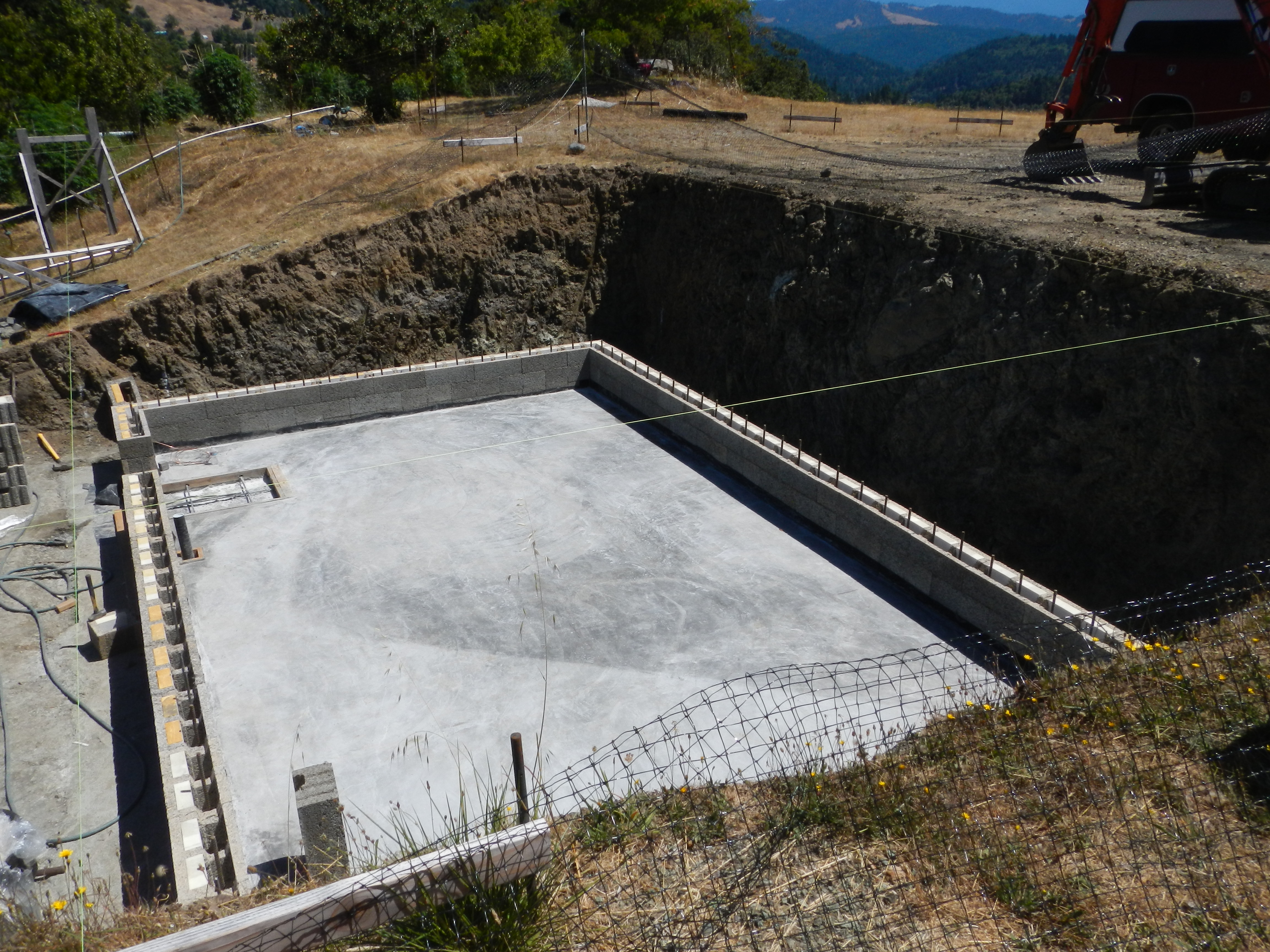

This shows the first course of the basement walls sitting on the footer, then ready to pour the slab with the blocks as forms, and then the slab with two courses up. We're in N. Calif. and the climate is pretty mild so we didn't do any radiant heating in the floors.

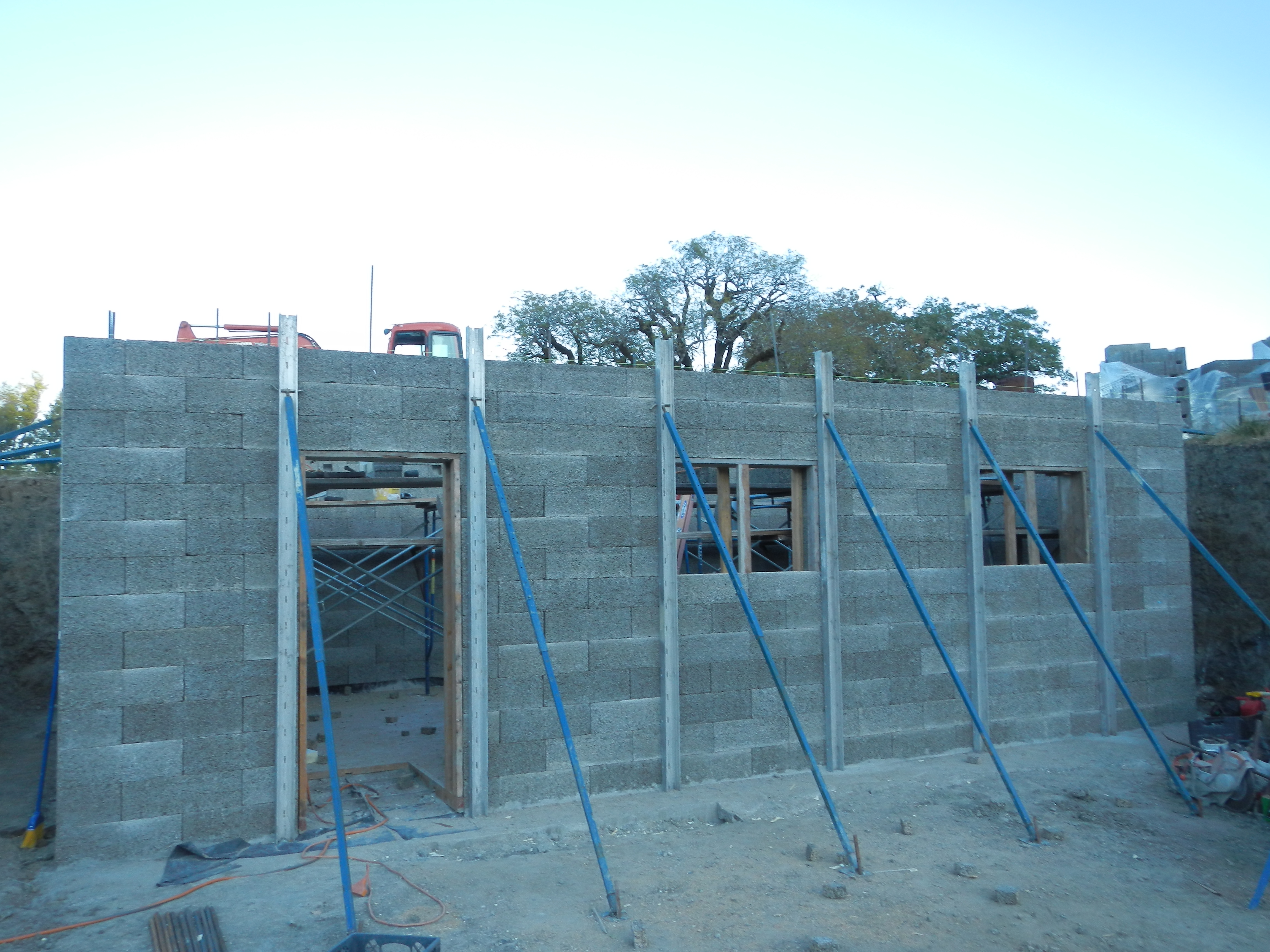

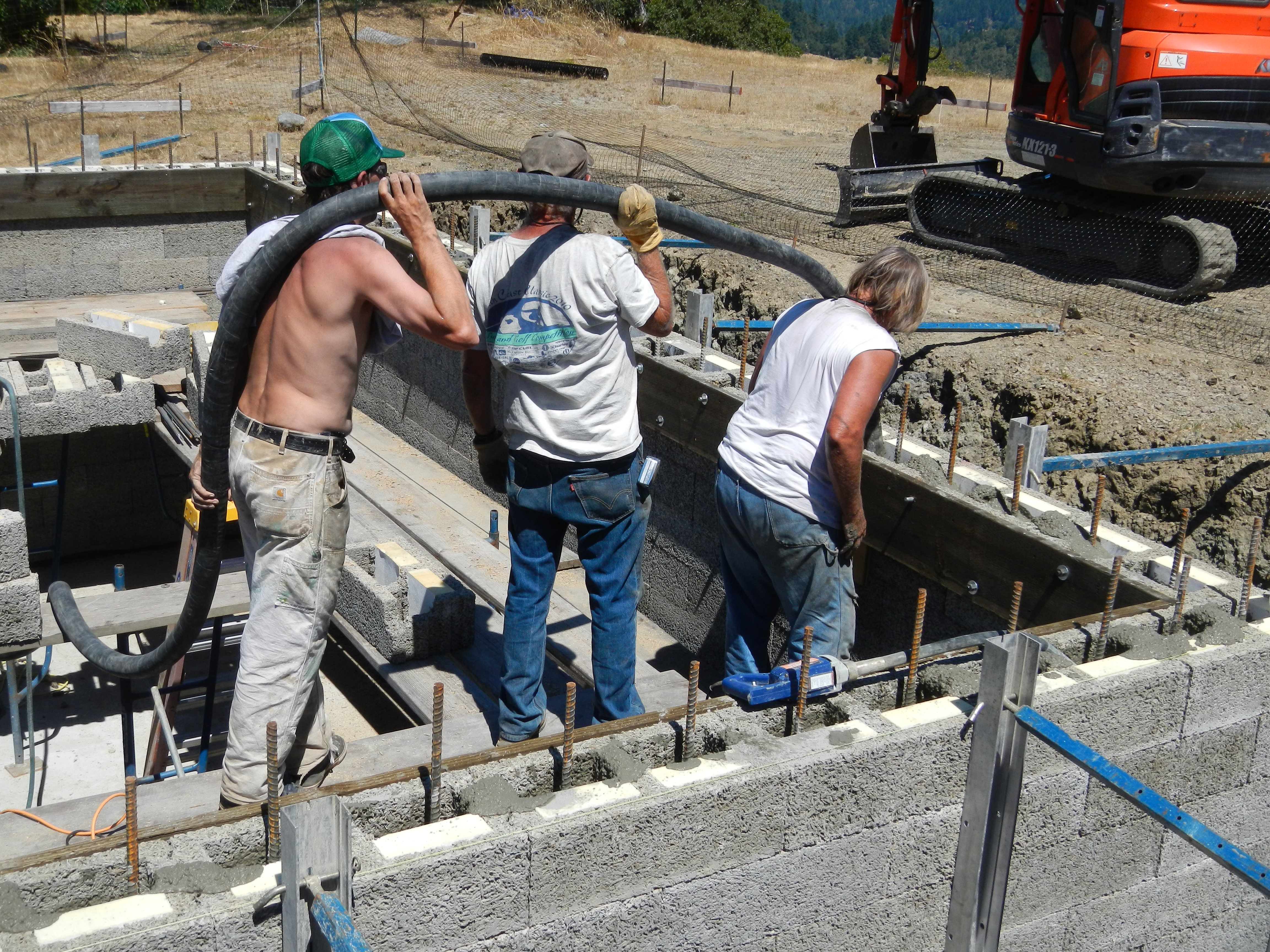

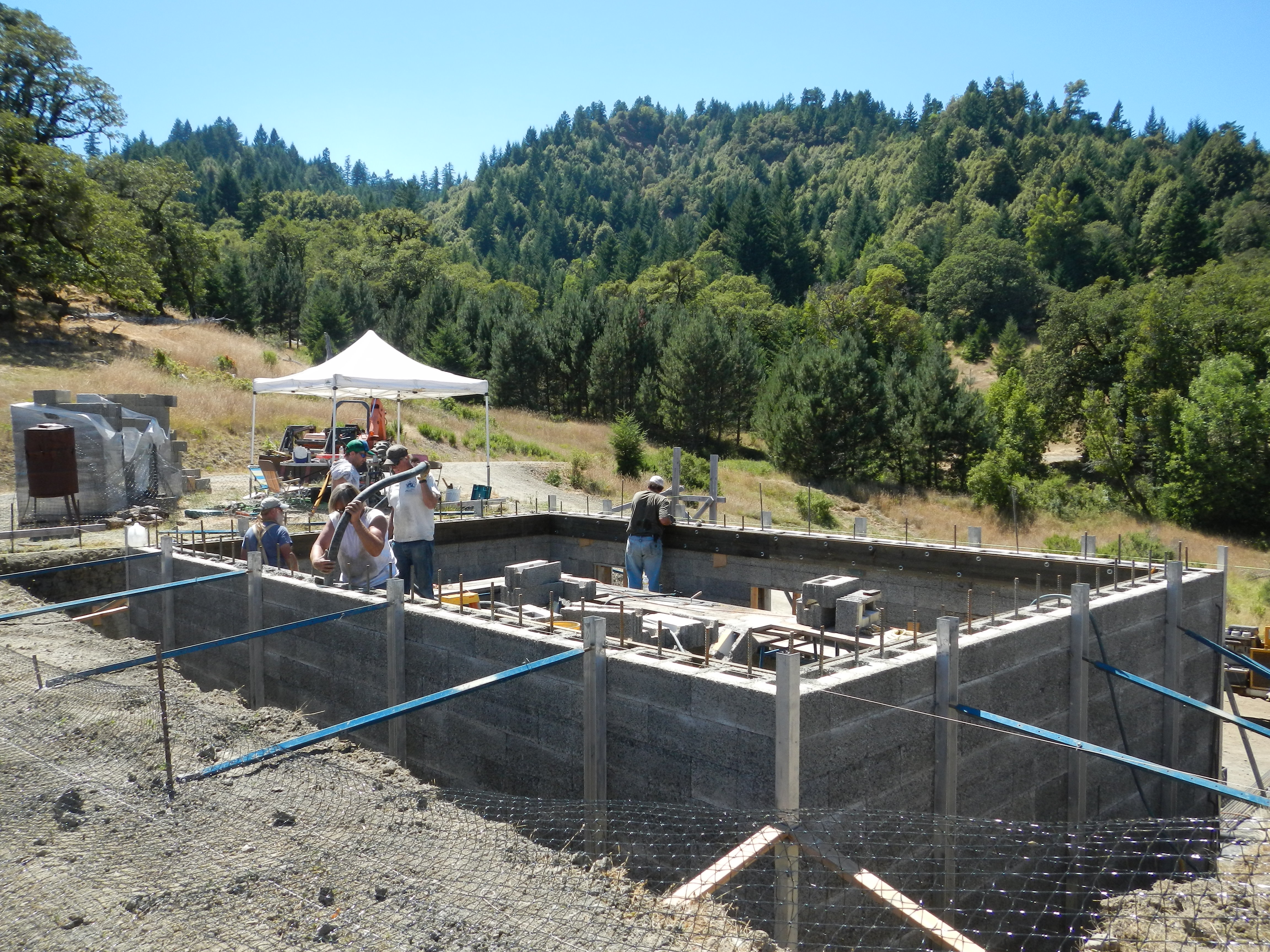

First photo is basement block stacked, braced, and ready for concrete. Then going around and around filling walls. Having scaffolding inside for stacking higher courses of block and then pouring concrete is crucial. These walls took 11yds.

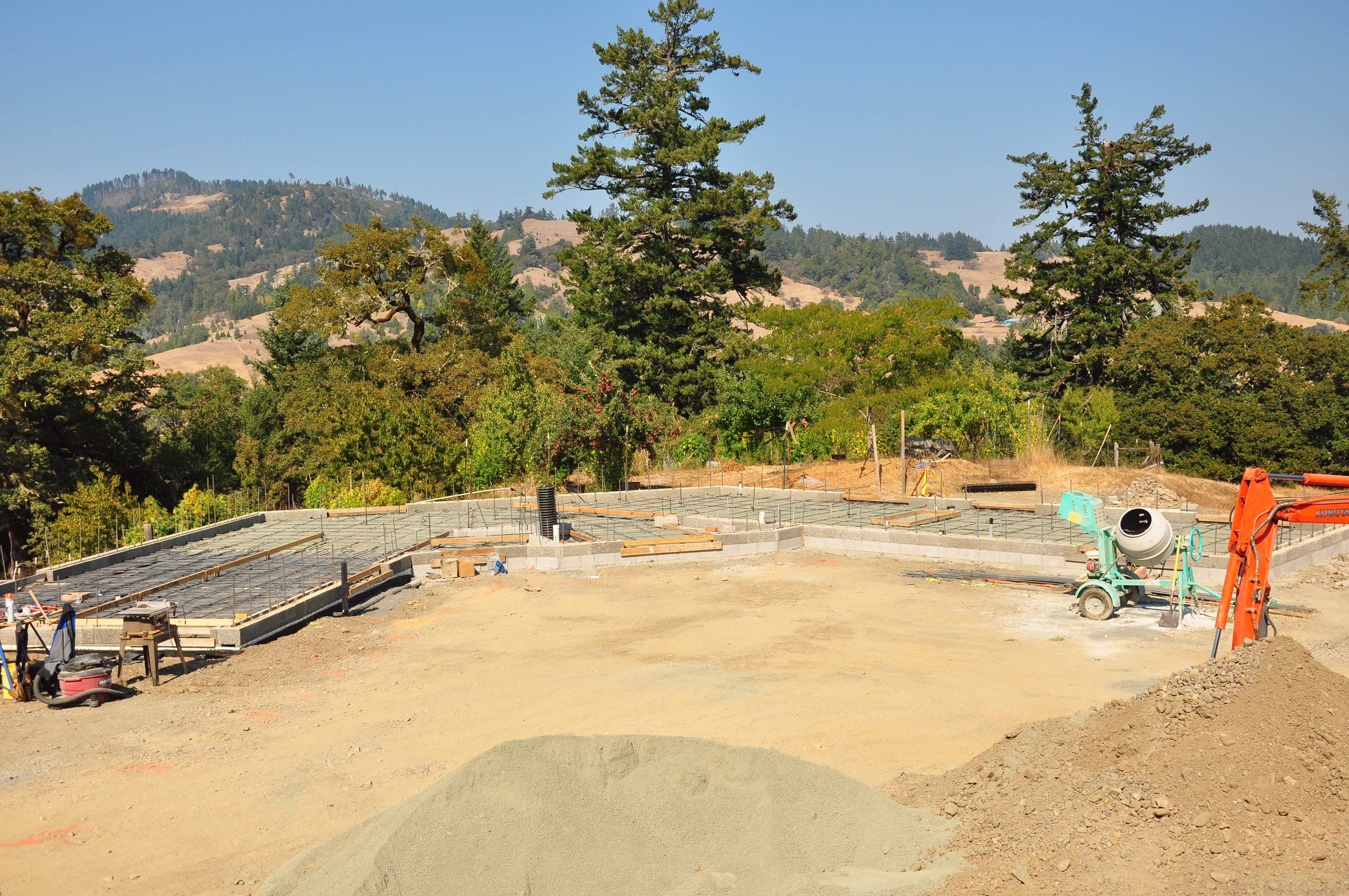

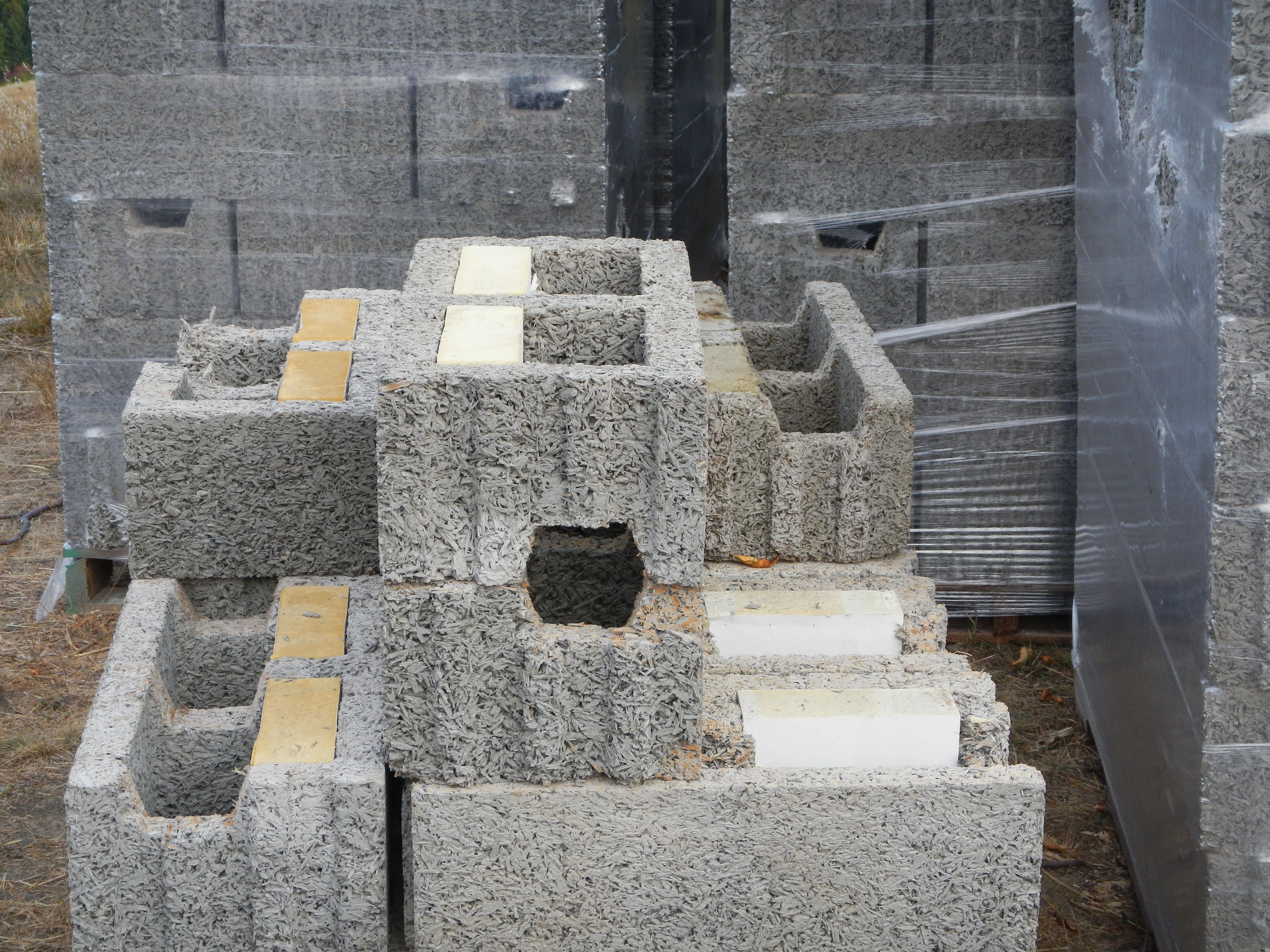

First photo shows what Faswall blocks actually look like. They have a notch on one side and they're stacked notch to notch and flat to flat, making a horizontal rebar every 16" and a vertical bar every 8". We used regular CMUs for the footer on the main part of the house and then Faswall. Third photo shows shape of the house, an open V shape. Basement is on the left side and we put 4x12s on 16" centers with plywood then the slab over the whole thing. The black tube sticking up is for fresh, cool air for the solarium.
