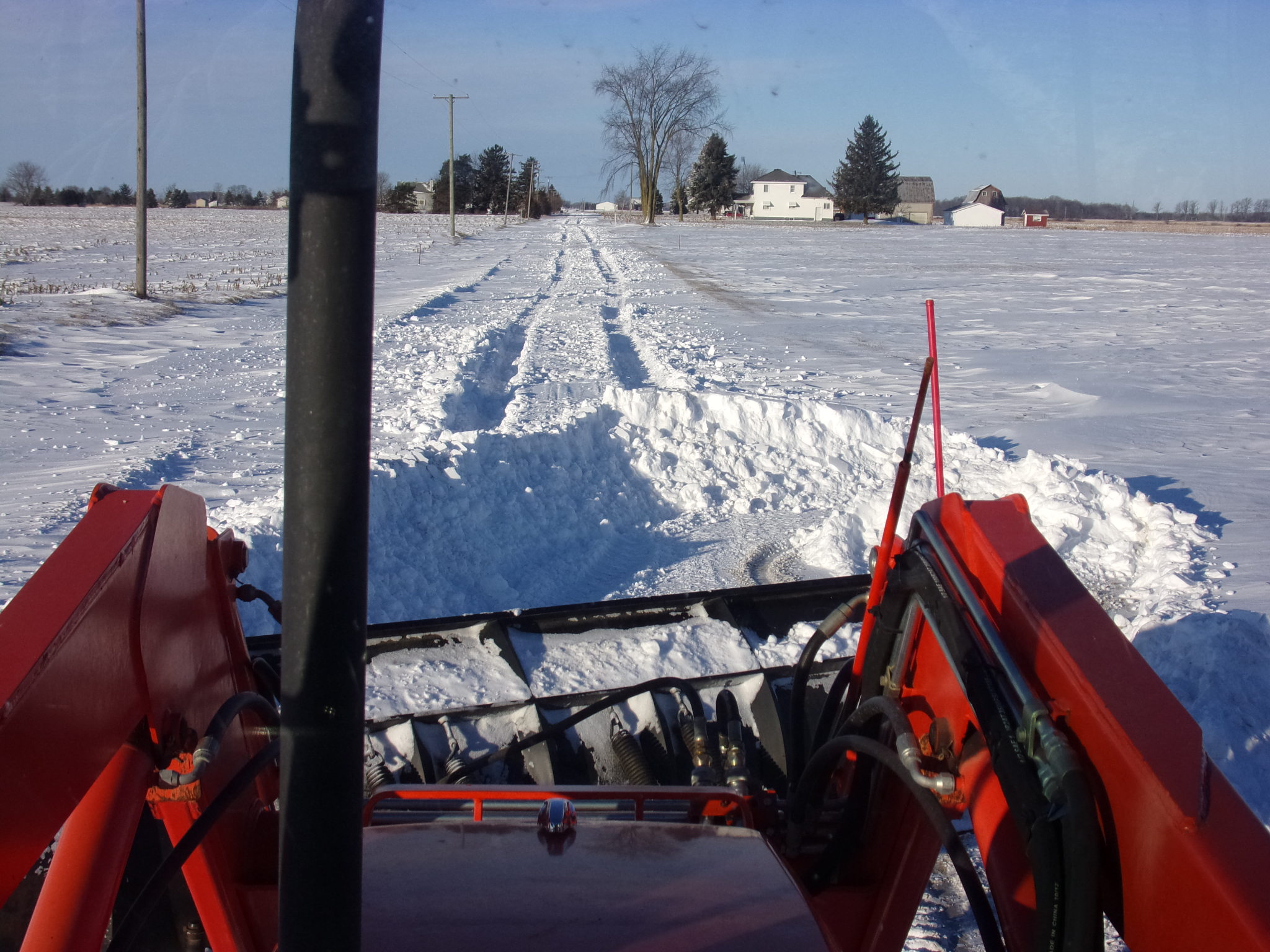

I have a Kubota Grand L6060 with a erskine 79" hydraulic snowblower and I find it has plenty of power to blow away all my snow. Can I bog it down? Of coarse, but with a little common sense I can move a whole snow bank with it. A snowblower can require a lot of horse power if you believe you have to go as fast as when plowing. A plow will move the snow faster, but can leave a very large snow bank by the end of the snow season. Resulting in a much smaller driveway or parking lot. A snow blower will be a little slower but at the end of the season your parking lot space is the same. A statement that a 60 hp tractor don't have the balls to run a 84" blower sounds like a knee jerk answer or inexperience.

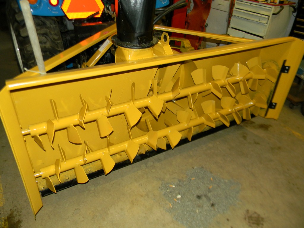

for what its worth my impeller is 26" and drum depth is 10.5 so kinda like the diameter of the puma 80 but the depth of the 84 regardless it seems very efficient

That's the kind of information I'm looking for. My current blower has a 21" x 7" fan (Drum is 22" x 8") and is too small. The Puma 80 has a 26" x 8" drum and the Puma 84 has a 28" x 11" drum. I think the 84 might be too much for my tractor and think the 80 might be good.
What size tractor are you running that blower on?

its on a jd 3720
it's a bit heavy for the tractor, but at a the time was the smallest commercial grade blower i could get
a 4720 would be a better fit- or a 6060
here's the combo- i think about 4-5 inches of somewhat dry snow
