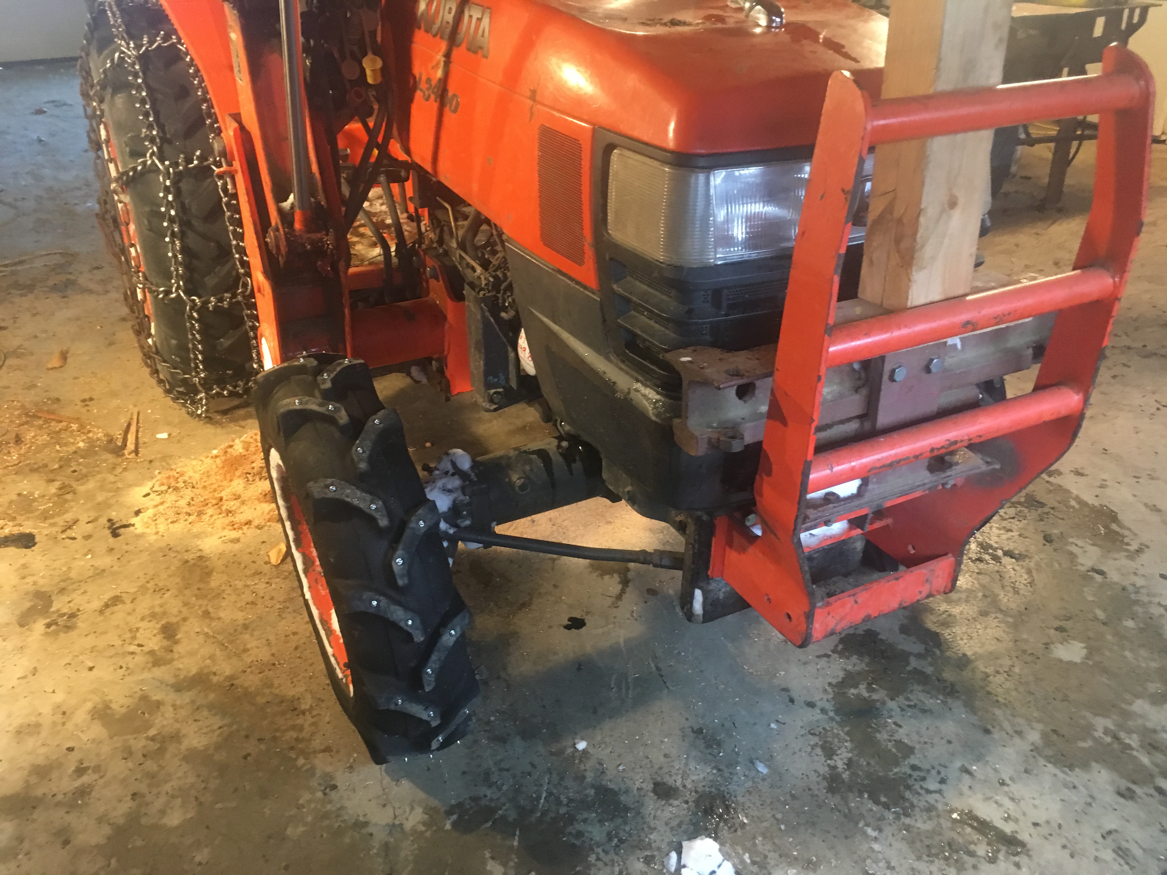

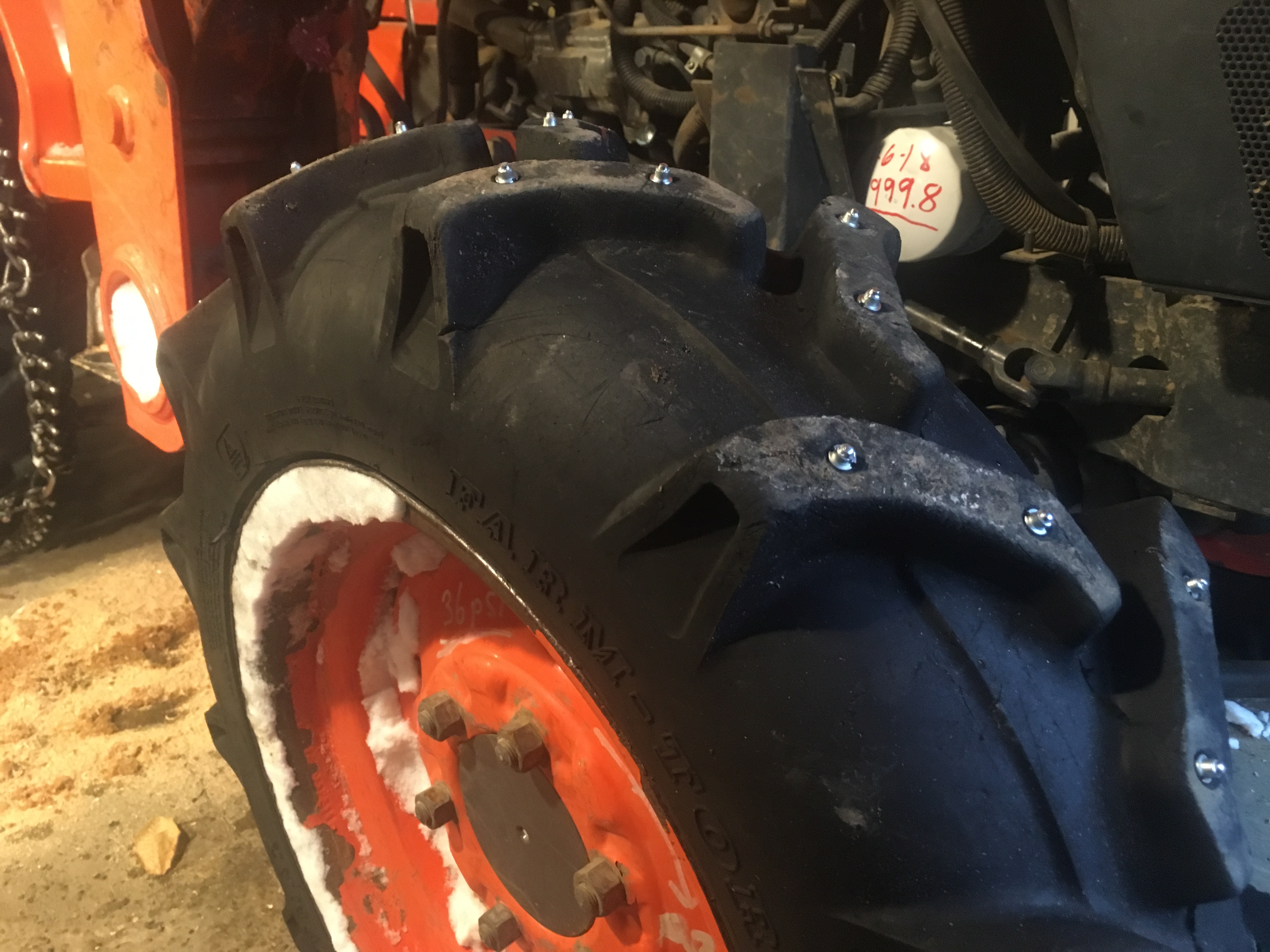

I use grip studs in my tractor for winter. they work very well. I have chains but since I went to a cab tractor I help out my neighbors some and the chains will drive you nuts if you run down the road at all. the studs are smooth when plowing and grip very well. I have a sloped driveway thats partially in the shade and the studs are great. I looked at several different kinds of studs and went with the grip studs since they wont break off in your tire.. they are used on things like skidsteers all the way to trucks. there are alot of different sizes on the website with charts depending on your tread depth. overall i'm very happy with the grip when plowing. I have a 7.5' power angle skid steer mount plow that I used last winter with the grip studs on a boomer 3040. it kept the front end from sliding when pushing snow with blade angled and I had no problems on glare ice with them. I will be installing the grip studs this week in the new LS XR4145 .
Based on your tip, I ordered these Grip Studs, a lot of 150+tool=$204.00 .After a hour of finding away of translating the metric system to inches I went with this size 1910T, a good 3/16" stick out, was gonna go with 1912 with 1/4" stick out but they were around $50.00 more, both penetrate tire just a hare under 3/4">>>( Grip Studs Screw-In Tire Studs | Traction in Ice, Snow and Dirt | 1910T Tire Stud )Should get them next week sometime, then install them in one year old 16" front Crop Max tire.
Just incase there's a rare chance of some here besides me that's not that good with the MMMMMMMMM system, I found this neat MM to inches ruler online>>>>> Convert mm, cm to fraction or decimal inches (in=mm=cm)

/ Anyone use ice studs? #29
Finally got around to get these Grip Studs in my front tires.
Installing Grip-Studs on tractor tire - YouTube
/ Anyone use ice studs? #32
I wont be able to tell how they work until it snows again or when I start getting out firewood. The last snow storm all the front tire were doing was holden up the front end, so I'm assuming there will be a little more traction hopefully enough so I can steer the tractor without brakes, we'll see.
