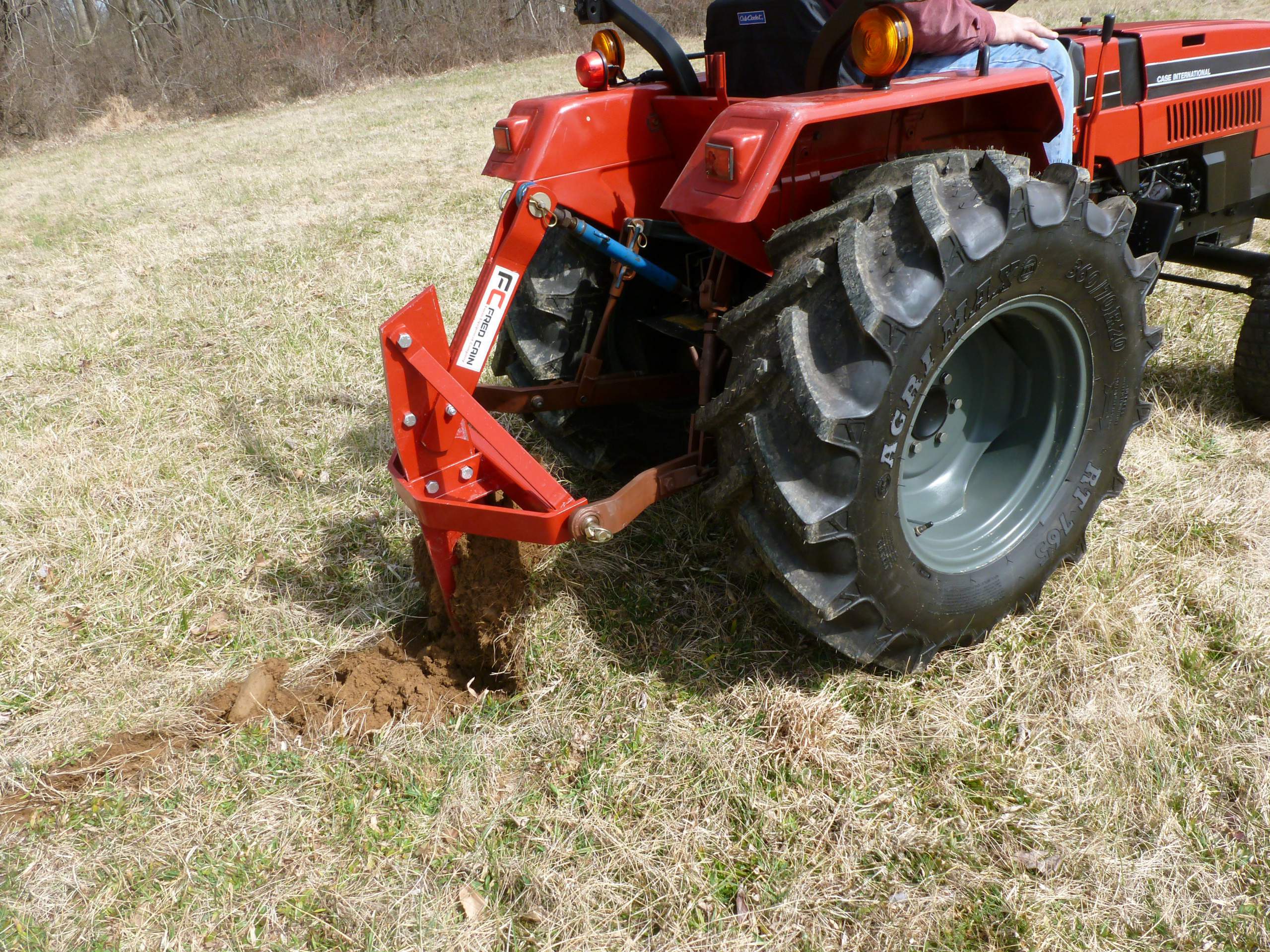

BKT tires are made in India by the largest tire manufacturer in the country, are relatively high quality, and I have them on one of my tractors with excellent results. And one third less than others I could get in the size I needed.
I would not buy a Chinese tire... and I would buy another BKT without hesitation
Welcome: Balkrishna Industries Limited (BKT)
