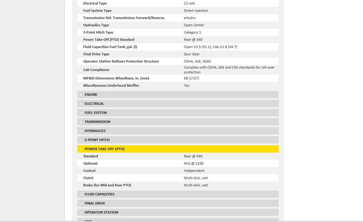

Anyway, since I don't have a service manual for the 3x20 series machines (for theory of operation), I did the next best thing...went to JDParts and compared the PTO systems between the 4400 (although the 4410 might have been a better comparison) and the 3720.
These are both illustrations for the PTO system...not all inclusive, but shows the components.
The 4400 uses a clutch and brake (items 25 and 11, respectively), the 3720 uses a clutch that appears to combine the brake and clutch in one assembly (due to it's greater number of friction disks). I did look at the 4410 (HST) which as a very similar arrangement (didn't save the illustration though).
So, it appears the 3720 does use a PTO brake (although the terminology is clutch).
That's my interpretation of the illustrations.
However, the illustrations don't describe the operation...greg apparently doesn't have the service manual either, so I guess he doesn't know either.
If anyone does have a 3x20 series service manual, how about posting the section on the PTO operation (not how to use it...that's in the operator's manual). It will most likely be in the power train section or under miscellaneous.
Bottomline is, the 3x20 series appear to have a PTO brake, but unlike the 4400, it's not a dedicated assembly.
ADDED: Although I was surprised to find it on the Deere website, there it was:
JohnDeere 3720 Compact Utility Tractor 3000 Series Compact Tractors JohnDeere.com
under the specifications tab.
I also added a screen shot...note the yellow high lighted section. The 3720 does have a PTO brake (and I think I was correct...the brake and clutch are one package now, rather then two discrete assemblies
My JD2520 has a brake, next time I am running the chipper I will pay more attention to how quickly it stops, but I would guess within a revolution or two.
Well, yes...your 2520 does have a PTO Brake:
http://www.deere.com/wps/dcom/en_US...drive_tractor/2520_4_Wheel_Drive_Tractor.page
Look under the specs tab.
