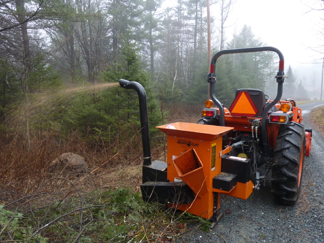

I have the Jimna 6" chipper and ran it for 5 seasons (or so) on a 28 HP JD tractor that had 25hp at the pto. It ran great. I dont have any hardwood, so not sure how it would handle that. Mine has the chute so it piles all shavings in the bed of my golf cart for the wifes whatever projects.
It flies on the new tractor..simply pulverizes the stuff.
/ Anyone use a PTO chipper? #22
Yeah, same chipper I have except I don't have the blower.
I've read mixed reports about the blower...how's your's work?
It works good but you can over load it. I can stick a 2 1/2 or 3 inch maple or birch tree in that is 20 foot long and it takes it fine and will blow the chips all the way to the front of my truck. But a 5" tree I have to cut in about 2 foot lengths or the blower box gets choked up. After I put in one length I wait a couple seconds for the bulk of the chips to clear before I put in another piece. If I had more hp I am not sure this would happen. I think it takes significant power to run the blower especially when it is full. But for me anything 4 or 5 inches is probably firewood so it isn't really a problem.
