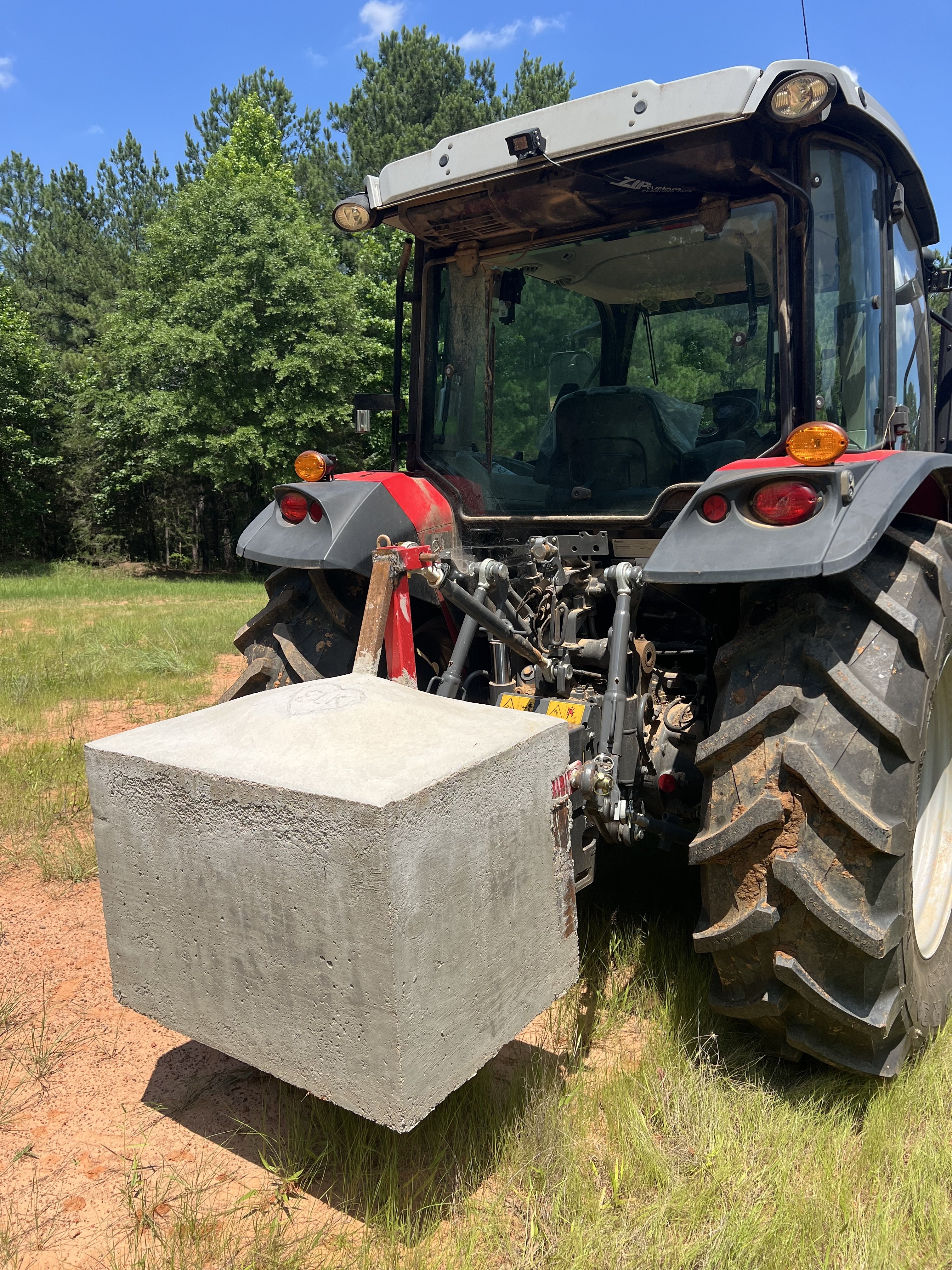

I was looking for some ballast and found this on FB marketplace. I believe it’s about 30” wide x 24” tall x 24” deep. They’re claiming 1540 lbs. That seems exaggerated to me.
I made my concrete rear ballast with a metal frame that I set in wood forms and poured the concrete around it. It looks very similar to the one in your picture.
It's 24x24x33. The metal frame weighed 104 pounds. I used 25 sacks of 60-pound concrete for a total of 1,500 pounds. The total weight of mine is 1,604 pounds.
I put it on my 70hp Massey Ferguson 4707. The difference is night and day better when loading and carrying a fill bucket of dirt!!!!
Compared to mine, I believe the weight is accurate for the one you pictured.

Believe it or not, I made almost an exact copy of the one in the picture years ago. I had a lot of ready mix left over from when I had the base poured for my 2 GSI grain bins so I had the concrete truck pour the excess mix in a wooden box I made up real quick that sat on a 3 point material mover. Works well but I don't use it anymore and it just sits by the barn now. Don't require the rear ballast as both my M9's have cast rear centers. Maybe I should list it on FB marketplace and sell it.

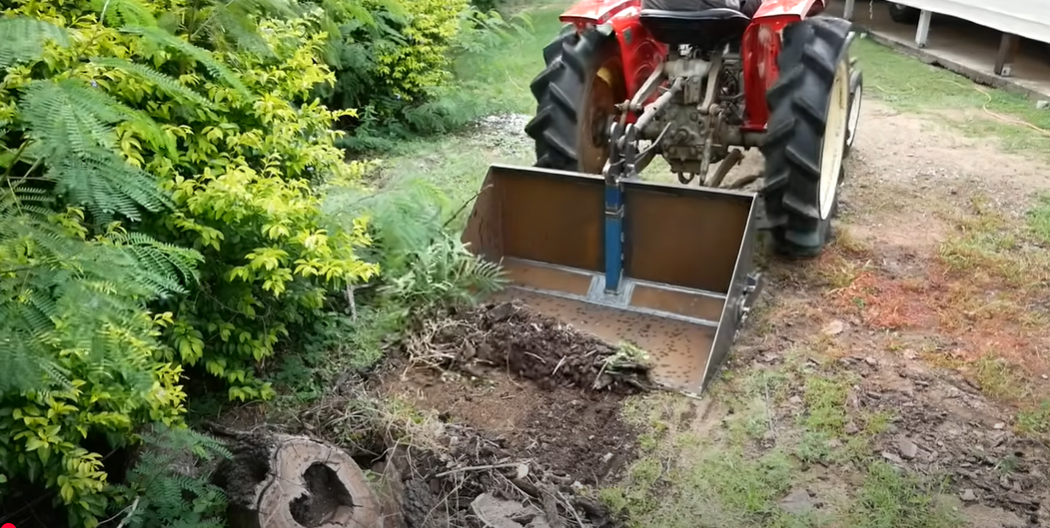

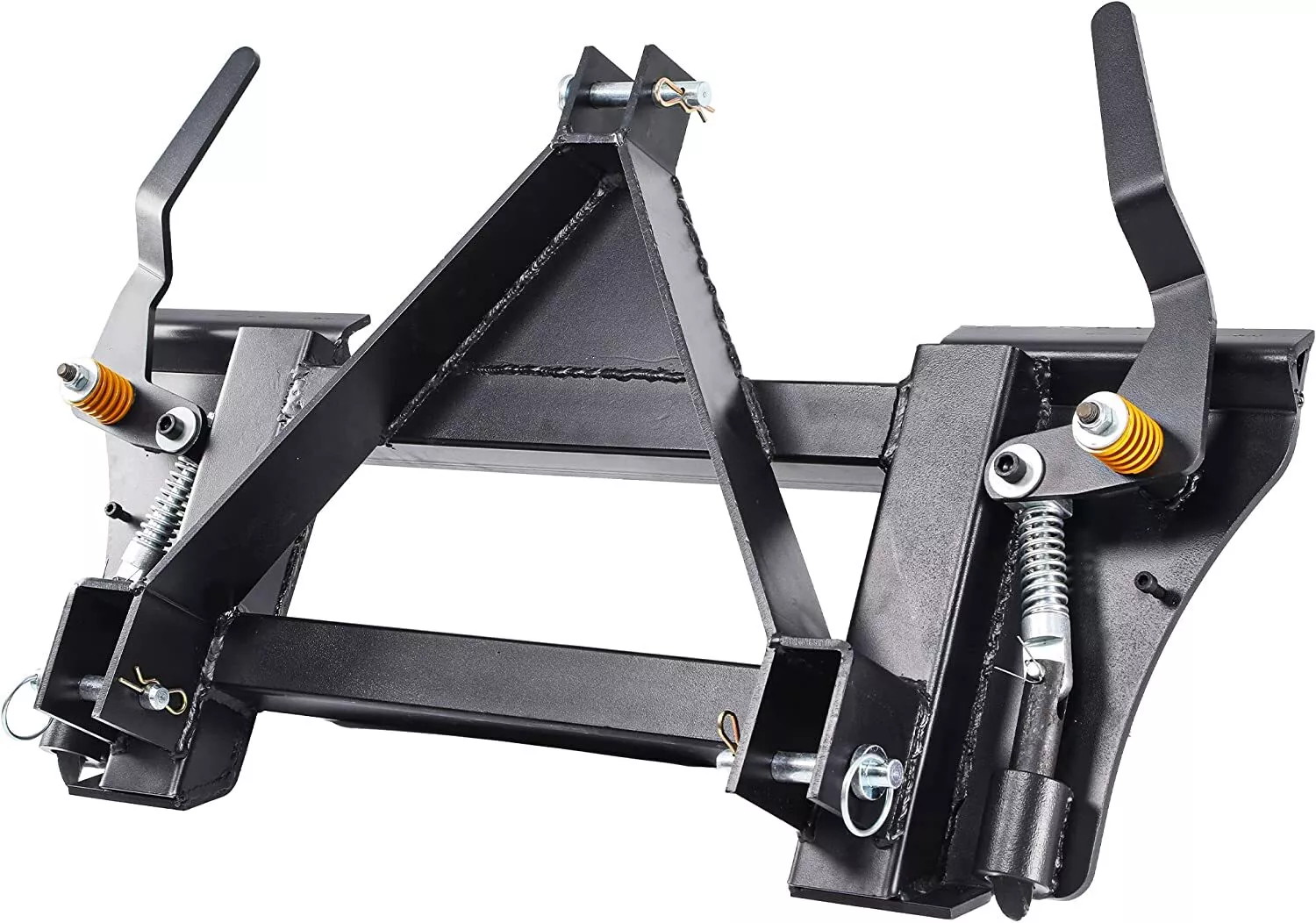

For the same money, you could get a 3pt to SSQA adapter. I use one with an old FEL bucket. I just back into a pile of gravel and scoop up a bucketful when I need ballast. Also comes in handy for using other FEL implements on the 3pt hitch.
View attachment 3347926 View attachment 3347934

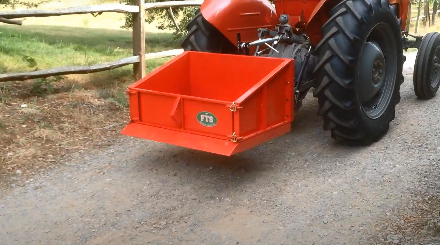

Also makes a great carry all with the right bucket:
Plus left or right side tilt that you can't do with a loader mounted bucket.
Otherwise- are there lynch pin holes in the lower 3ph pins? Those would be a pain to drill at this point.
