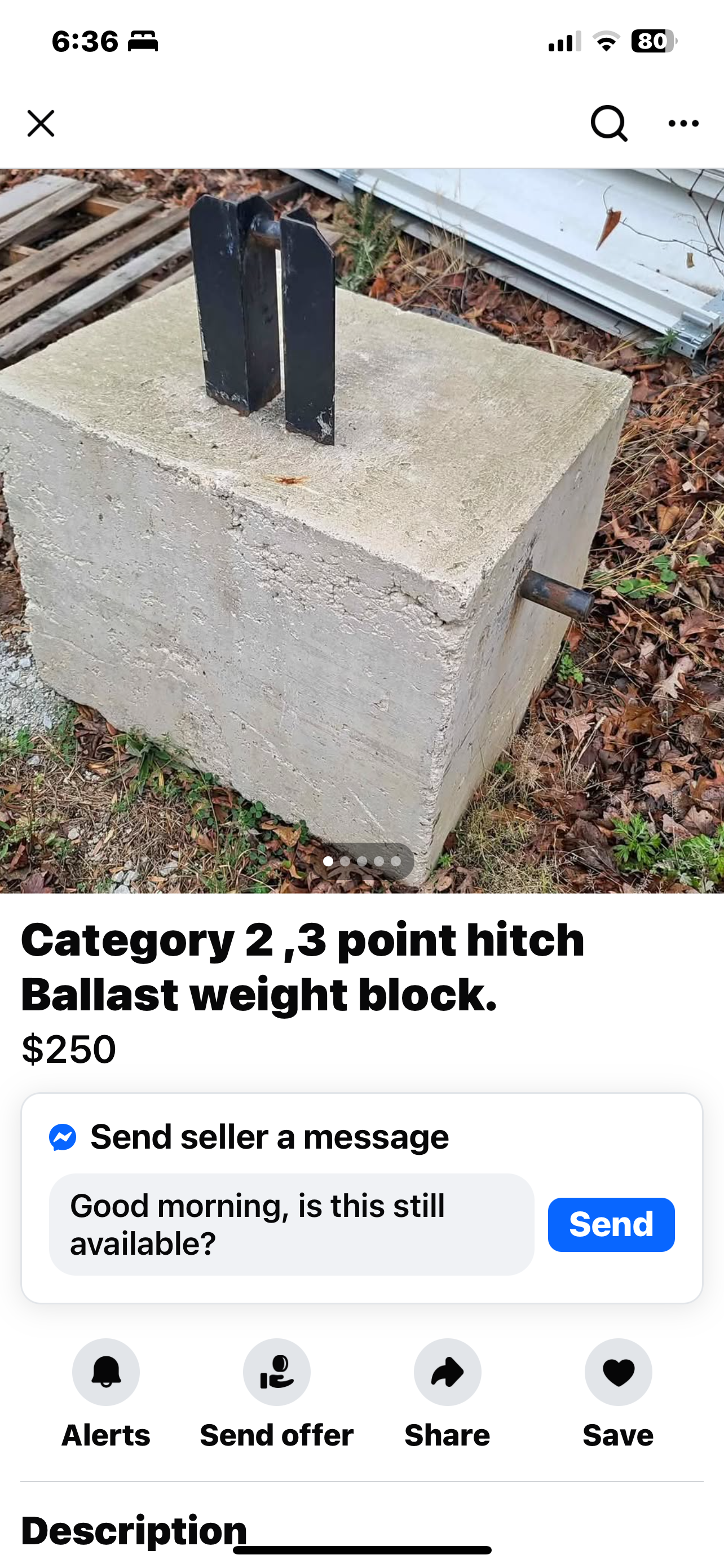

I was looking for some ballast and found this on FB marketplace. I believe it’s about 30” wide x 24” tall x 24” deep. They’re claiming 1540 lbs. That seems exaggerated to me.

That weight sounds pretty close. Several places on the internet (so it must be true) list concrete at 140-150lbs per cubic foot. My calculations of your block 2' x 2' x 2.5' comes up with 10 cubic feet. 10cubic feet times 150lbs gives 1500lbs. So that number is not far off, if at all.

Sounds about right for a block of concrete that size.

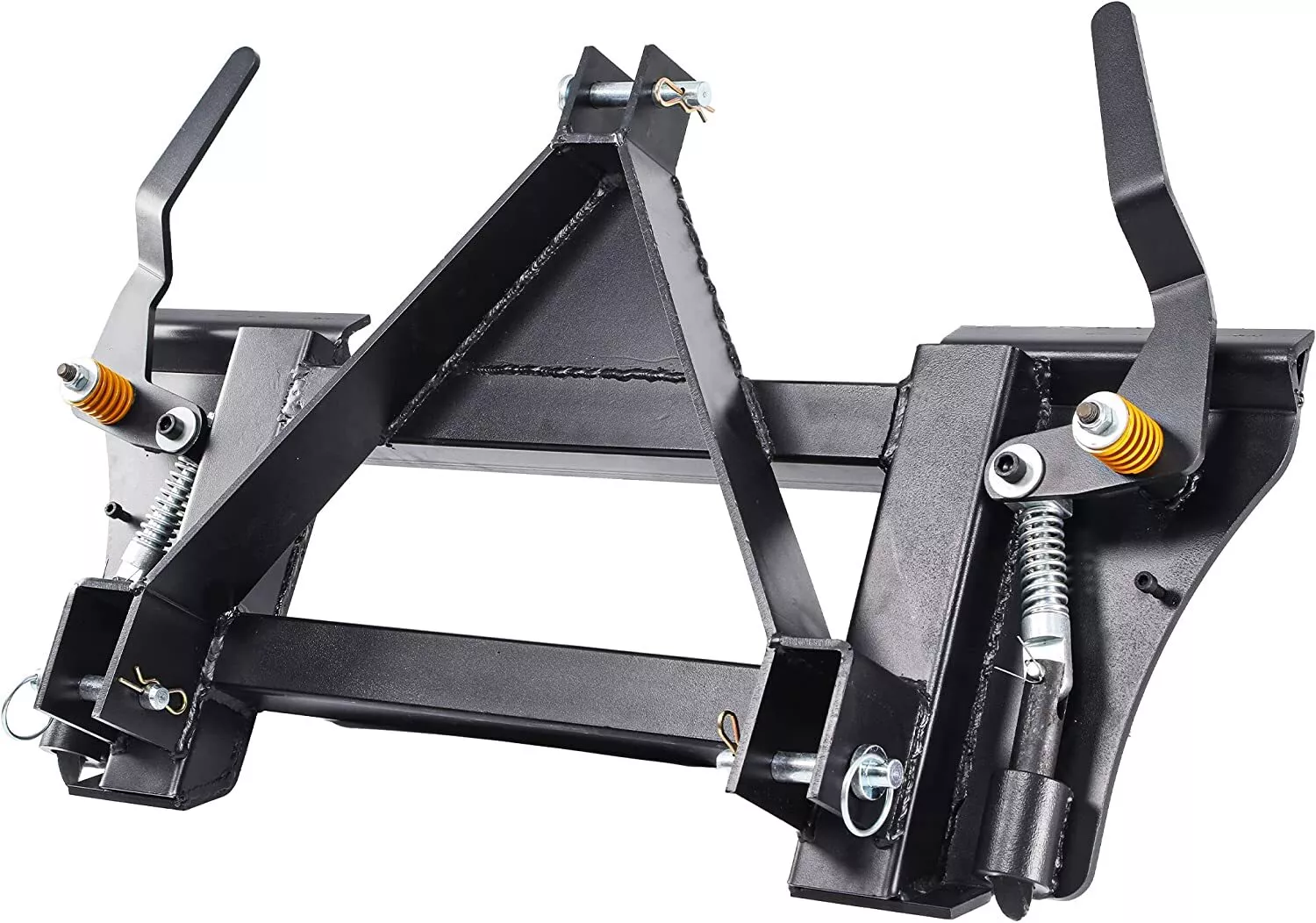

For the same money, you could get a 3pt to SSQA adapter. I use one with an old FEL bucket. I just back into a pile of gravel and scoop up a bucketful when I need ballast. Also comes in handy for using other FEL implements on the 3pt hitch.

Thanks all. It felt too good to be true especially compared to steel for the price.

It’s 10 cubic feet of concrete so the weight is correct. I don’t think the price is bad. It’s a lot of work to form up a cube and mix 1500 pounds by hand. Not to mention the supplies needed would probably cost $250.

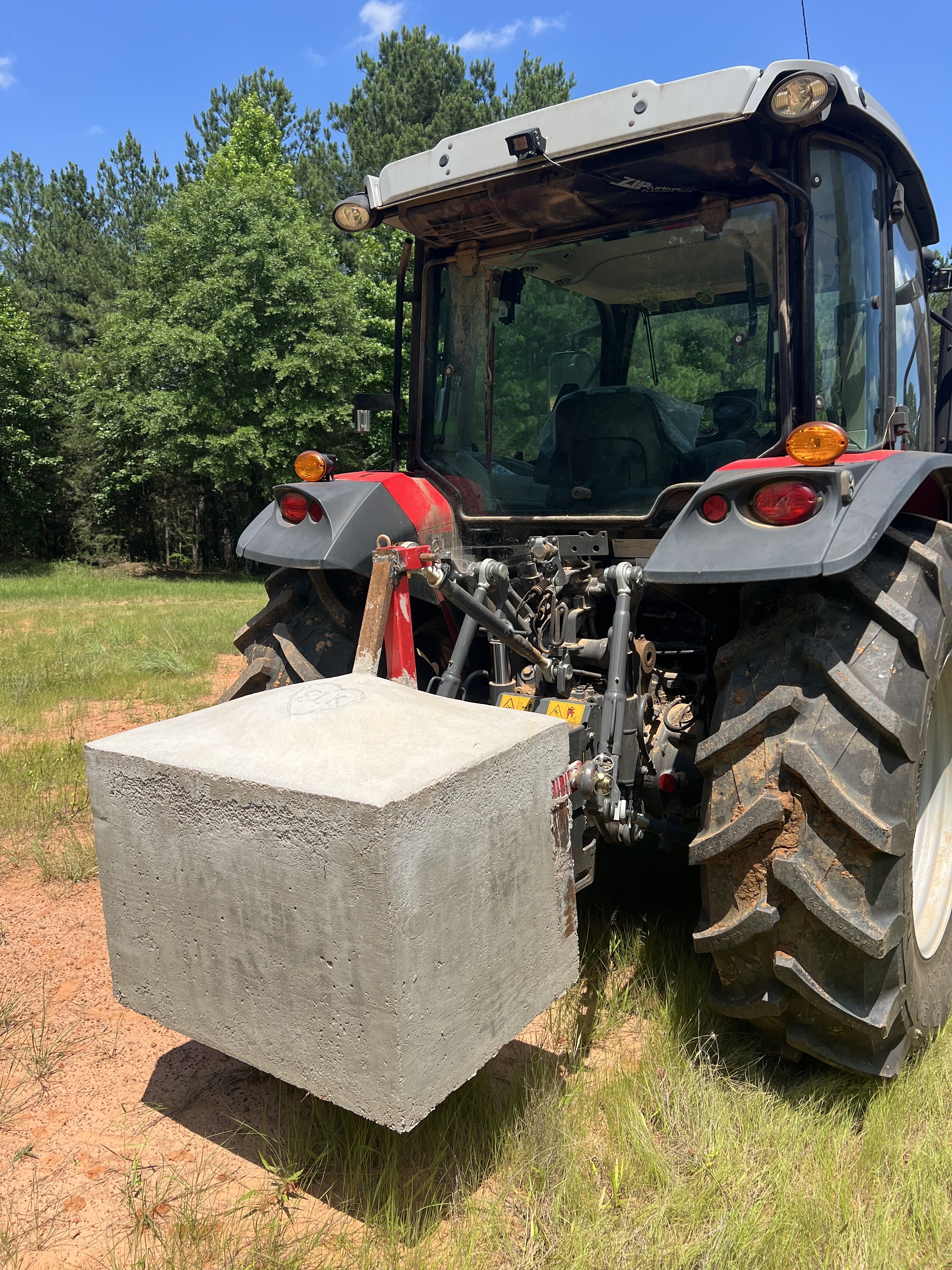

I made my concrete rear ballast with a metal frame that I set in wood forms and poured the concrete around it. It looks very similar to the one in your picture.
It's 24x24x33. The metal frame weighed 104 pounds. I used 25 sacks of 60-pound concrete for a total of 1,500 pounds. The total weight of mine is 1,604 pounds.
I put it on my 70hp Massey Ferguson 4707. The difference is night and day better when loading and carrying a fill bucket of dirt!!!!
Compared to mine, I believe the weight is accurate for the one you pictured.
View attachment 3347926 View attachment 3347934
Also makes a great carry all with the right bucket:
Plus left or right side tilt that you can't do with a loader mounted bucket.
