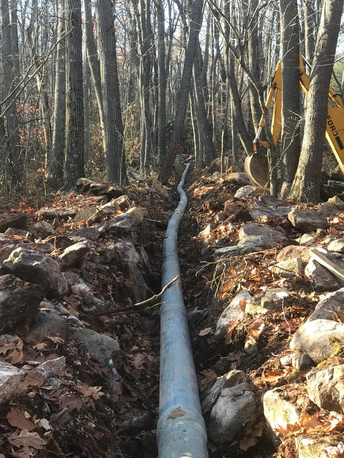

I have researched micro hydro for at least 10 years now. This fall we decided with the current political climate that it was time to pull the trigger.
My stream produces 500 gpm+ at it’s peak and down to a slight trickle in the summer. I designed it to take advantage for the Dec-may peak. It should produce roughly 3kw continuous. With this power I can power and heat my whole house.
I have 2 turbines custom built to my stream specs by Langston Alternative Power. as stated earlier I get 500 gpm of flow and 60ft of head in a 1,000 ft run of 8” pipe. Up at the house is a 12k Growatt hybrid inverter and six LifePo 4 batteries capable of storing 30kwh.
I also have 20 Solar panels that will be installed as soon as I get the hydro completed. Right now I’m racing the winter weather.

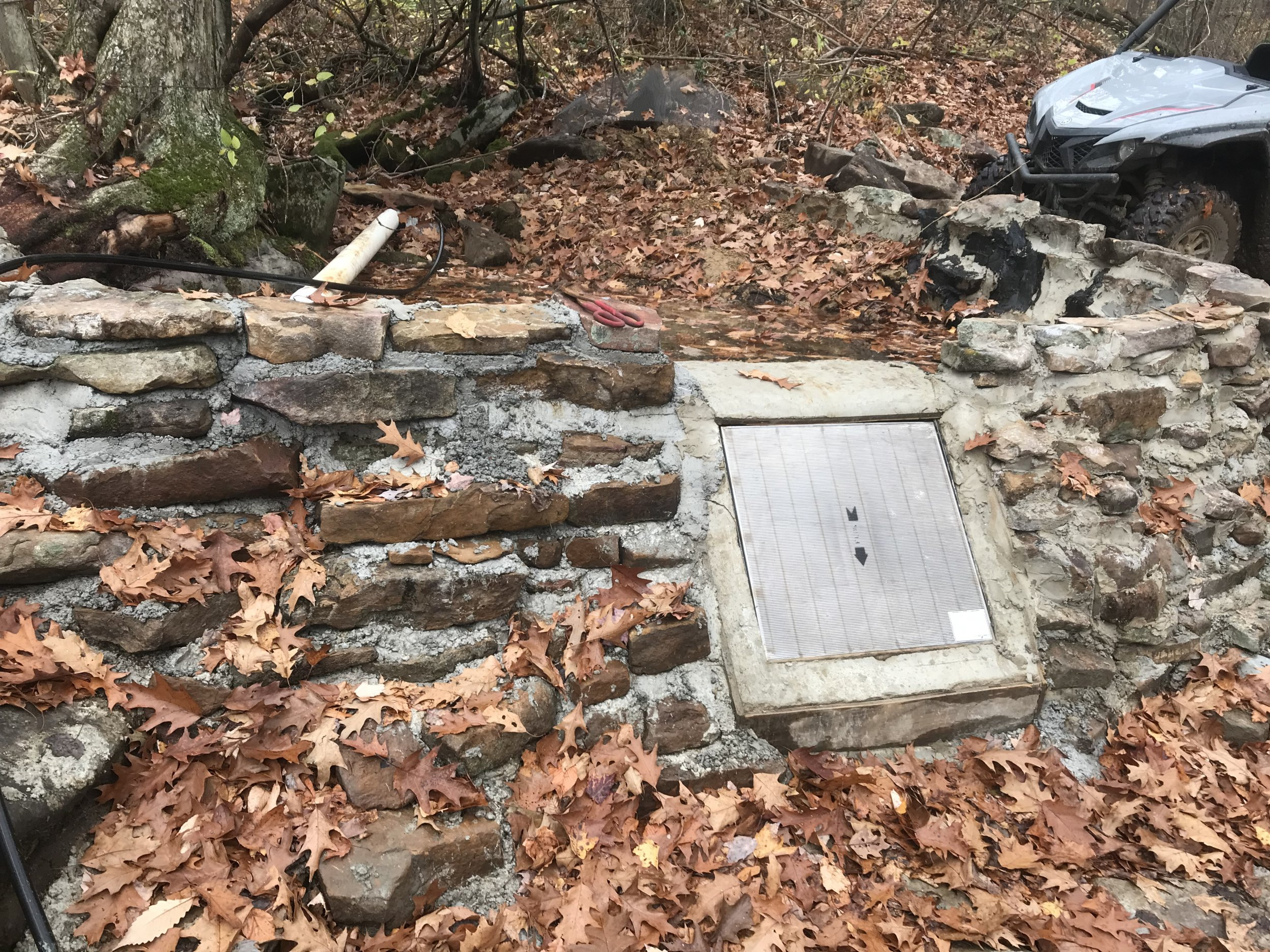

I also read in a few posts above about the maintenance involved. Well, if you design I the system right there really isn’t any maintenance to speak of. The key is keeping debris out of the penstock and turbine. That can be done with a Coanda screen.
You can buy the whole coanda box but they are super pricy. So, I ordered just the screen and built my own box for it out of concrete and saved about 5k ! I added a pic of my weir and coanda box and the hardest part of the whole project, burying the 8” pipe Cree side in the giant rock garden.
Anyhoo, here are a few pics of my progress
