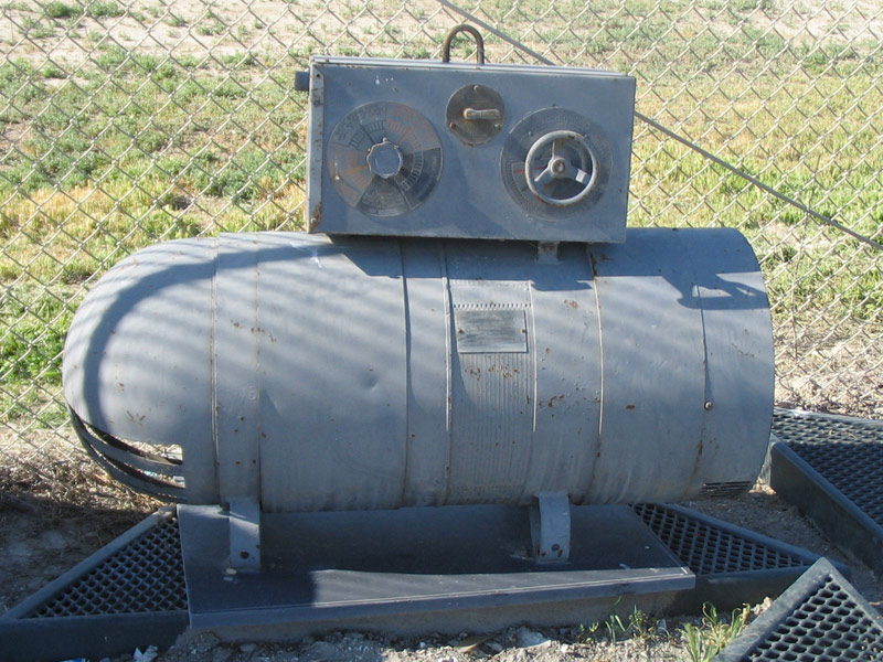

Very familiar, great machines. Screaming little mothers! :laughing:
/ Anyone familiar with these? #3
Now if you want a machine that will run everybody away because of the noise, these will do it!
The arc is about the same on both machines, but I'd take the SAE anytime, more control over the puddle.
So what is it? Just a DC stick welder? What is the noise issue?
/ Anyone familiar with these? #5
Yep, bare bones DC stick machine, with a fantastic arc. Great little Tig machine also.
Far as the noise, lets just say I've never seen anyone go home for the night with one still running. :laughing:
/ Anyone familiar with these? #6
They basically have a generator head like an SA-200 would, but with an electric motor spinning it, not a gas engine.
Ahhhh. That explains it. I thought it looked like the business end of an SA200 Thanks, Deereman
/ Anyone familiar with these? #8
They often come with those NICE three-wheel carts. I'd keep that even if I sold off the welder.
/ Anyone familiar with these? #9
Spins your electric meter in a blurr. Welds like nothing else out there. Plug it in and listen to it b4 you buy. It's a Howler..
No intention to buy it, just had never seen anything like it before and was curious. It's 3-phase anyways, which is why the guy is selling it. He thought it was 1-ph.
/ Anyone familiar with these? #11
Around here they were called a hard hat welder due to the round cover on the top. 20 years a go they were all over the plant but now only a couple survive. This is one welder that would work off of a phase converter because it is basicly an electreic (3 phase) motor turning a generator.

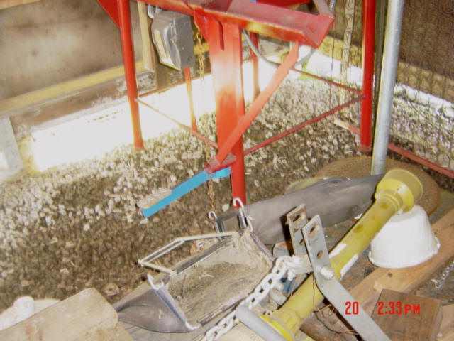

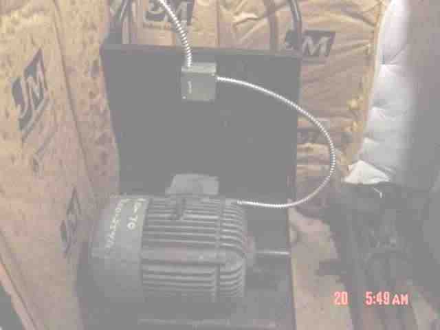

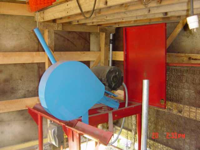

I have a phase converter I used for a 7 1/2-HP chop saw I built, but haven't used the converter, or chop saw in years.:eek:
/ Anyone familiar with these? #13
How big a wheel does that chop saw spin?
/ Anyone familiar with these? #14
18-inch. It will cut 4-inch solid round stock in just a few seconds. :thumbsup:

The 250 the OP posted draws 30 amps 220v at 200 amp output. I am guessing you would need a phase converter that can provide atleast 50 amps 220v 3ph. The sae-200 would probably draw a bit less.

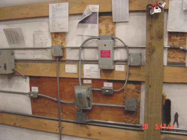

Guess I'll have to walk all the way out to the shop to see if the phase converters says how many amps.:laughing:
If I remember correctly it's 8 to 12-HP.
