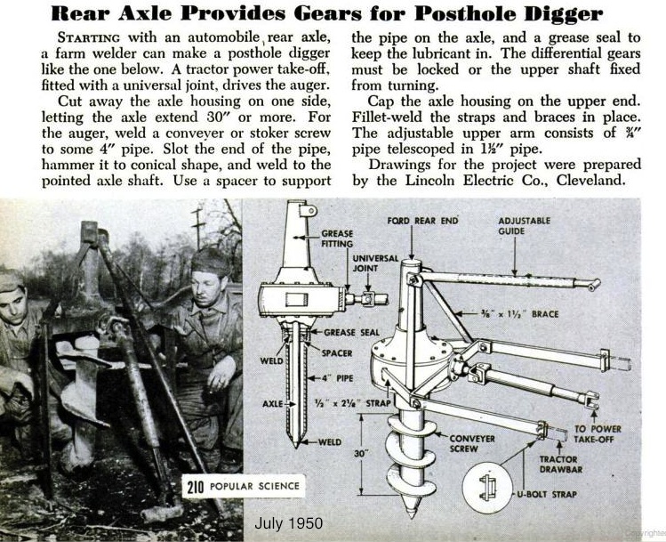

Has anyone made there own post hole auger for 3 point? Thinking about using a truck axle to build one. Anyone got pictures or advice?

What did the farmers use to build there's with
/ Anyone ever built a post hole auger? #5
Most I saw were Ford Model T and A rear ends.
For example:
If I were going to build one now, with junkyard parts, I would start with a differential from an independent suspension car. No axle shaft and housing shortening to do.
Bruce
/ Anyone ever built a post hole auger? #6
For example:
Bruce
Ah, the good old days. Can you imagine Lincoln or Miller printing project drawings for something like that now? Lawsuits cometh, and that right soon.;)

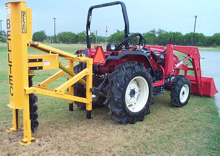

/ Anyone ever built a post hole auger? #8
