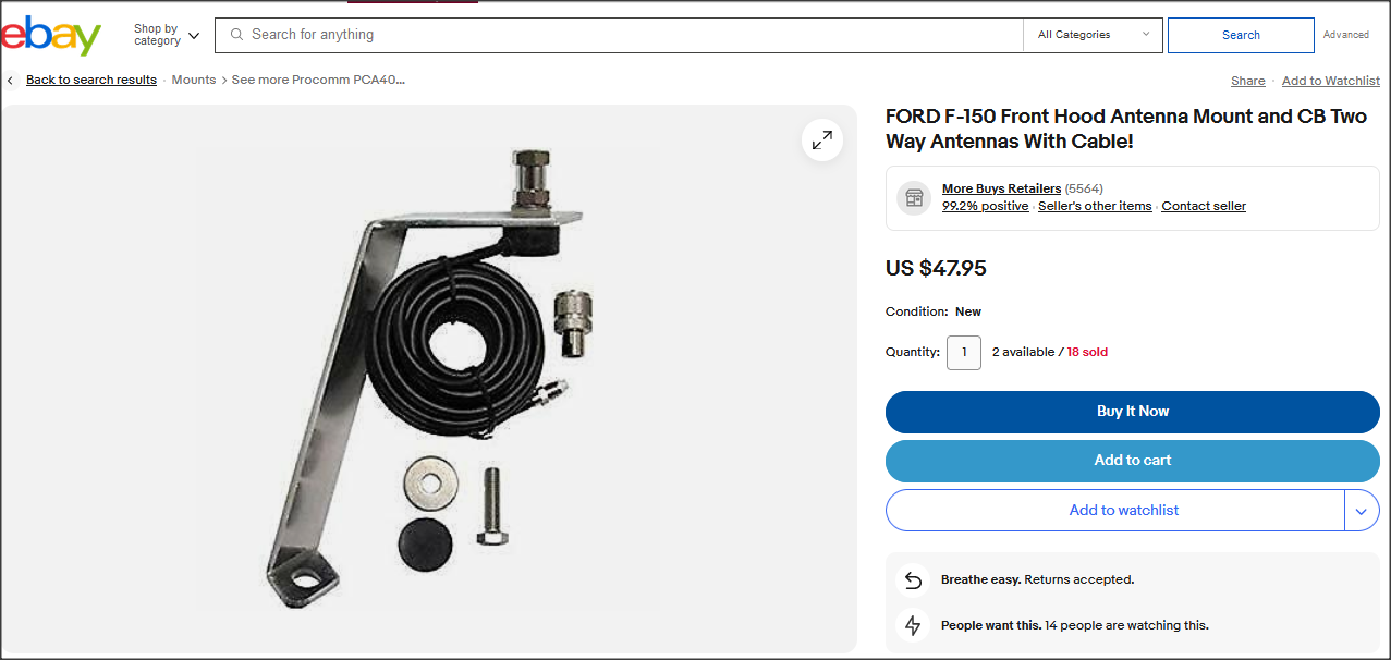

The last one I had was on a Chevy pickup and it mounted on a bracket that used the hood hinge bolts to secure it. The antenna was about a 3' and the bracket was kinda S-shaped and brought the antenna straight up over the fender just outside the footprint of the hood. It didn't interfere with anything and it was out of the way -- very similar to the fender mounted AM/FM radio antenna.
It was something like this but mine was higher up near the hinge and pretty much hidden in the pillar blind-spot.

I was thinking of installing a CB radio in my Ford F150. I used to have a magnetic antenna for my car. The ford is all aluminum, and I don't know how to put it on without drilling holes. Anybody figured out a good setup?
Thanks
Dave
Here is one model designed for 2015 and newer F150
There may be others.
