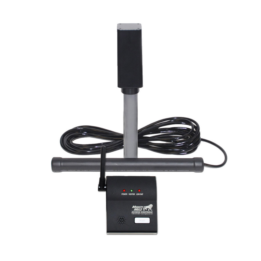

I would not want a motion detector sensor. Too many false alarms.
I looked for the light beam type to put at the gate, but never got one.
This type would be my second choice: Wireless Driveway Alarm by Mighty Mule - FM231
For now we are using our dog and his super sensitive hearing. :)

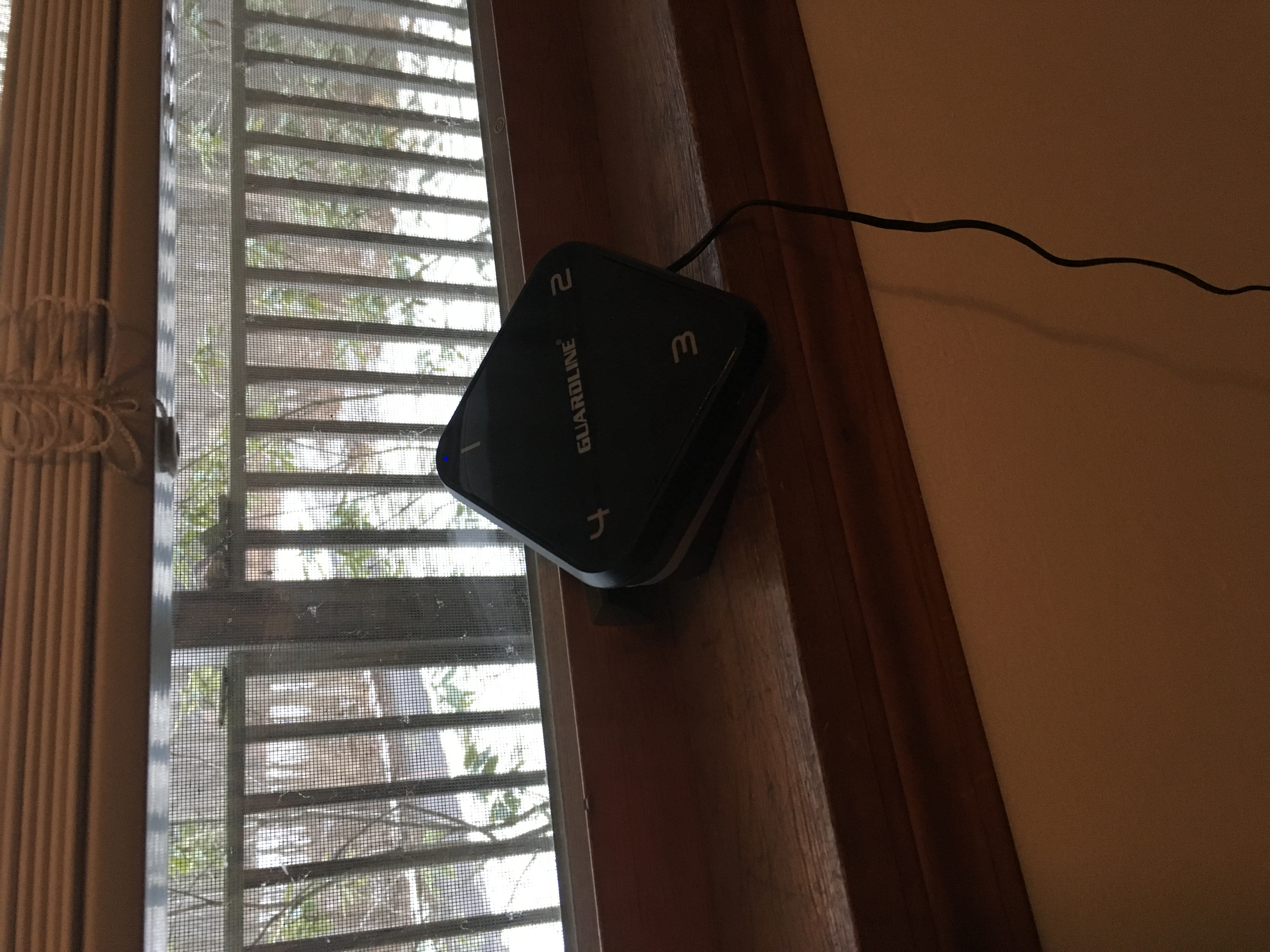

I have 2 of the 1/4 mile units for almost two years and they work great. One is about 1200’ from the house and another about 200’. I have a long tone on the one (Raiders of the lost Ark) furthest away and a ding dong tone on the one closest to the house. Signal goes through trees fine, I just had to locate the receiver on the window sill. If/when these go I would definitely buy it again. Animals will set off but it will pick up people walking up the road and alert where buried types don’t.

I had one of those but returned it due to low volume. Could not hear it from another room.
